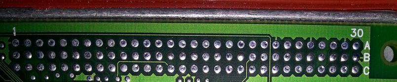

BDM works great!
In case any body wants the pin outs.
A-4 = GND -> Pin 3
A-7 = DS -> Pin 1
A-11 = DSI -> Pin 8
A-13 = DSO -> Pin 10
B-12 = BERR -> Pin 2
C-12 = RST -> Pin 7
C-29 = DSCLK -> Pin 4
C-30 = Freeze -> Pin 6

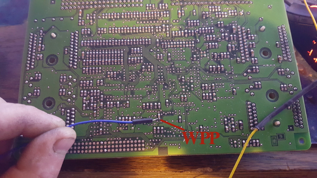

The Intel chip also requires +12v on WPP during Write, I do not have the location of WPP yet.

Gampy wrote: I do not have the location of WPP yet.
Actually, you do. Look at the cad file I sent you. It's also in the images you stripped the meta data from.
-David

DavidBraley wrote: Gampy wrote: I do not have the location of WPP yet.
I saw no locations in the images at all ... I'm talking about the locations silk screened on the board.

by DavidBraley » Wed Jan 01, 2020 9:42 pm
Gampy wrote: DavidBraley wrote: Gampy wrote: I do not have the location of WPP yet.
Whoops Sorry, Have not looked at the CAD file yet, maybe my bad ...
It's this image:
-David

by DavidBraley » Wed Jan 01, 2020 9:53 pm
Gampy,
Do not apply anything less than 11.4 Volts, and no more than 12.6 Volts to the WPP pin. This info is from the Intel flash datasheet.

by Gampy » Wed Jan 01, 2020 11:28 pm
It's this image:
I see no Silk Screened locations in that image.
[edit added image]
Like this,
1, 30, A, B, C
Thank you for the voltage warning.

by DavidBraley » Thu Jan 02, 2020 12:47 am
I'm not understanding you when you say "silk screened locations."
The location you apply the 12 volts erase and write voltage to the Intel Flash chip (what the BDM calls WPP) is not on the 90 pin header. It's where the red and black arrows are pointing (the second close-up image only has a black arrow). Sorry about the blurry images. If you view the cad file I sent you, it will all make more sense. I hope this helps!

by DavidBraley » Thu Jan 02, 2020 1:27 am
OK, now I understand what you mean by "silk screened locations." I'm slow sometimes...

by Gampy » Thu Jan 02, 2020 2:07 am
Bah humbug, it looks like there is nothing around to textually describe it's location.
