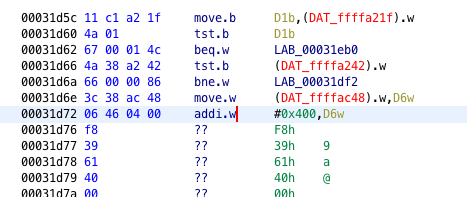

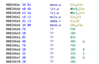

Last post from me for the night. Anyone familiar with why my decompiler keeps saying invalid instructions? Every time it's with a 0xf8 byte. Every time my decompiler fails to decode, it's ALWAYS because of this 0xf8 byte. I cannot find the table look up instruction format in the pdf I have, but I would suspect it's that... Anyone know for sure? Wonder if this is one of the CPU32-specific instructions. Weird thing is if I put it into the online disassembler, it also gives me garbage..

jlvaldez wrote:Last post from me for the night. Anyone familiar with why my decompiler keeps saying invalid instructions? Every time it's with a 0xf8 byte. Every time my decompiler fails to decode, it's ALWAYS because of this 0xf8 byte. I cannot find the table look up instruction format in the pdf I have, but I would suspect it's that... Anyone know for sure? Wonder if this is one of the CPU32-specific instructions.
Yep, F8 is the table-lookup opcode, new for CPU32.

Thanks for the confirmation. Let me try to get in contact with the guy of that fork of ghidra and see if I can help him along. Would really like to get full cpu32 support.

Posts: 10111
Re: Disassemblers used? First modifications to P59
There are data tables between the code and the dissassemblers cant always follow code which loads a saved address to a register then jumps to the register address. So they miss valid code, and not all unassembled data is code. Whats showing above looks like data, not code. The instructions before which did decompile dont look like sain code.
