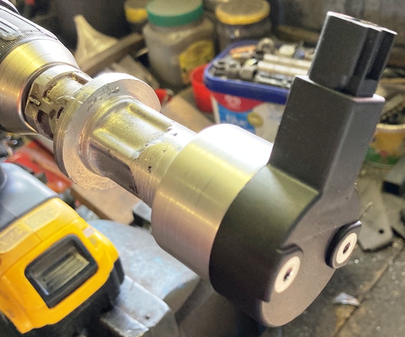

So the boring bars arrived just in time to get the part sorted thursday night so i could have today to put it together
and you'll all be pleased to know i finally washed the base part

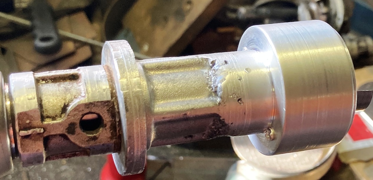

The welding isn't the best, but i wasn't expecting the cast part to be nice to weld, it worked but its not pretty
so i machined it smooth
With all that completed i was finally able to work out where to cut the chopper down to. you will notice there is a fair bit inside the housing still, this will allow me to adjust things later if i decide to go for a different sensor or chopper width. currently its the LS1 configuration which is 50/50 on/off
i need to get some longer screws to attach the sensor for good, but thats about all that is left to do now!
This is a quick scope of the signal from it in the drill!
