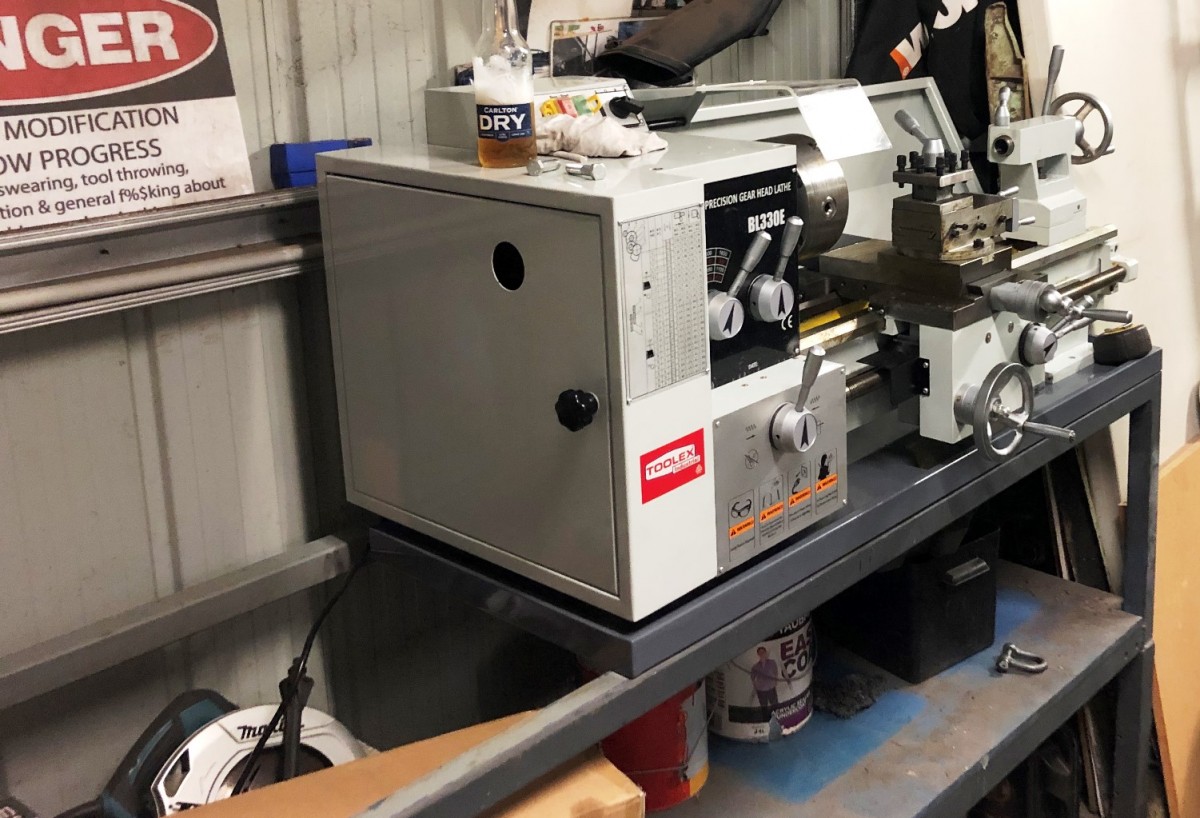

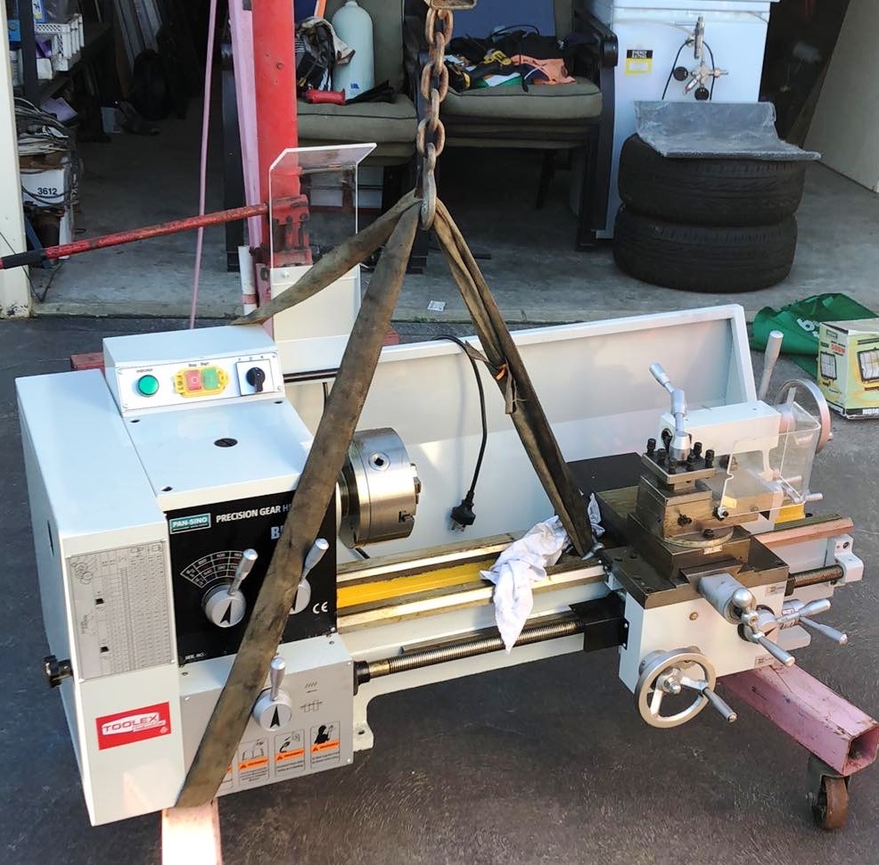

So for many years now i have wanted to get myself a lathe, but its always been one of those things that a welder or pipe bender etc was more important than to complete my tasks, so its been a bit further down the list than other tools, however it has finally come to the top of the list.

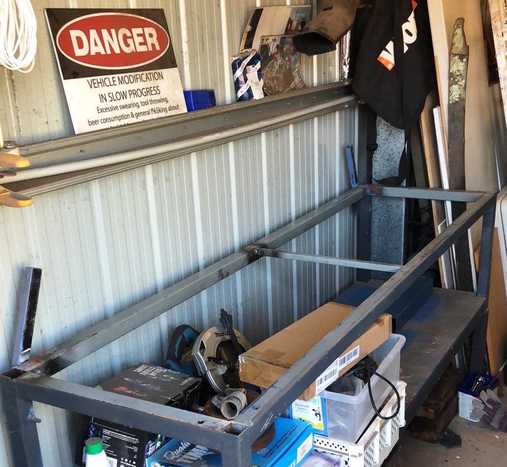

So once i got it home i set about modifying a bench i have, which had a grinder on one end of it but other than that was just a spot to pile shit up, so its certainly being suitably re-purposed now.
So i removed the grinder and board off the top of it.

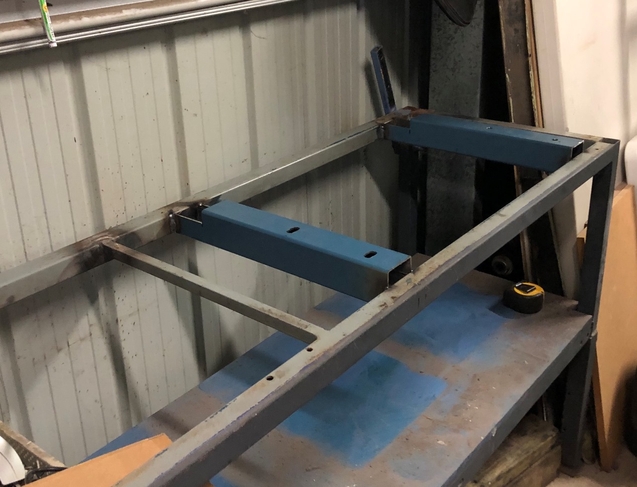

I then worked out some spare steel i had that would be suitable to do what i needed to mount it.

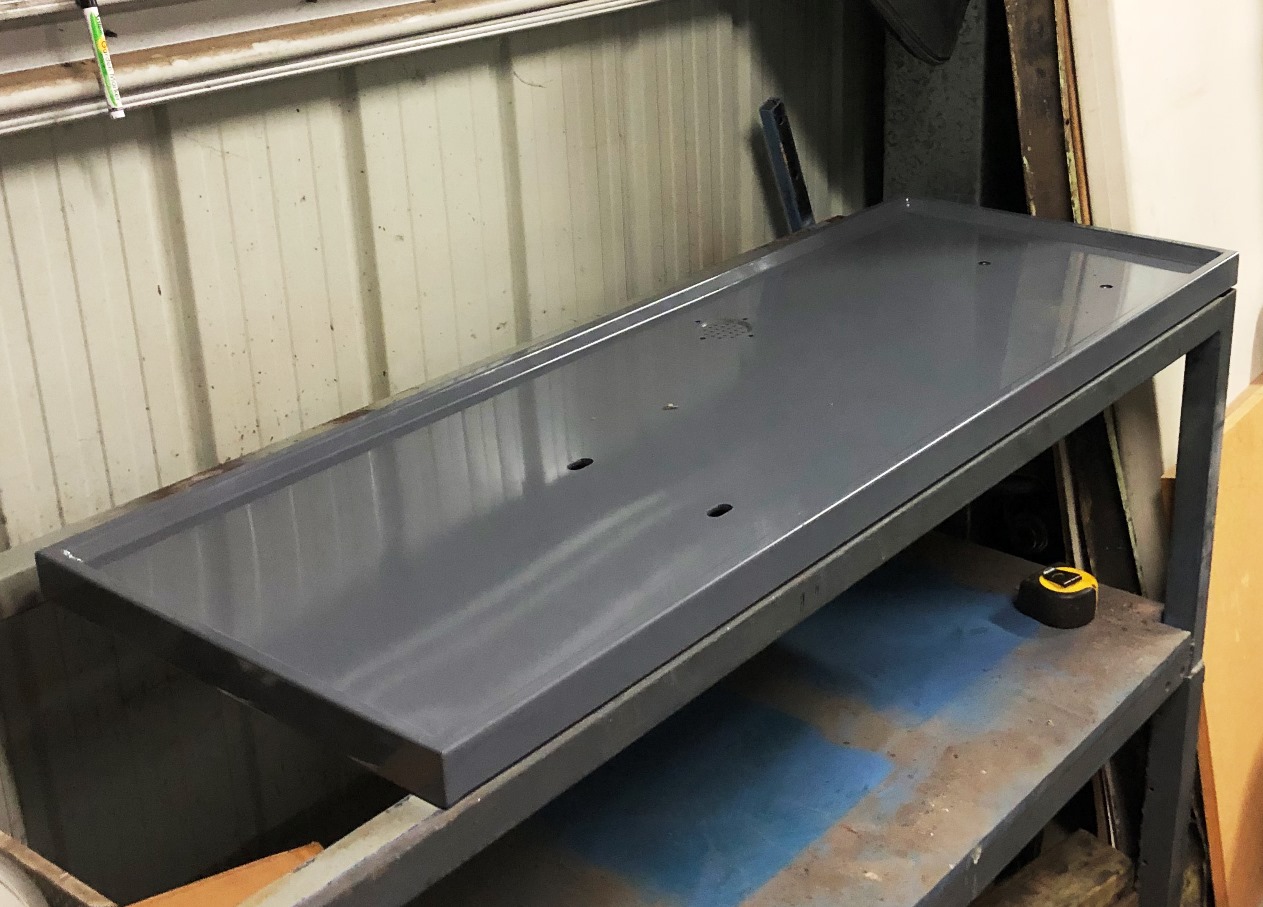

The notches at the back and the fact it sits higher is to allow the drip tray to sit properly as it had a lip around the outside of it that was lower than the lathe mounting panel.
As you can see a few mm of clearance under the drip tray, and holes/slots suitable for mounting.

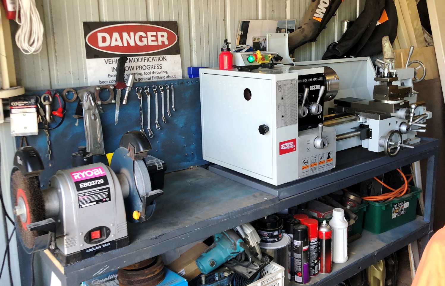

Fits on the bench very well, and there will be a nice bit of room left at the end of it to re-mount the grinder and probably some spots to store lathe accessories.
I also have a drill sharpener which doesnt really have a home so it will probably live here too.
The lathe isnt super expensive, but it was in my budget and should cater for most things i need to do.
I has a 38mm spindle bore (most others were 20mm), powered longitudinal and cross feeds, a 600mm long bed, 230mm swing over the bed and almost too many options for cutting threads so im hoping it will be a good thing :)
You can rest assured i will post some more pics or a vid of it in action, at this stage i dont have any tools for it (9 piece tungsten tool set in the post along with a tailstock chuck) and at some stage i want to get a 4 jaw chuck for it too .... oh and probably a knurling tool ;)
Its funny alot of people i talk to ask me why i bought it, what i want to use it for .... i guess they just dont understand how many little things it will come in handy for over the years.
That said i would like to try and turn up some injector bosses (no particular need) and i have a few other things i'd like to try when i get my hands on some other materials just to see how it goes, and my brother gave me a 56mm diameter x 1.5mtr steel rod so i have plenty to play with ahaha!

nothing major at the moment but one thing i do want to do is machine the 3rd gear piston in a spare trimatic i have, you can machine a few mm off the face of it and then that allows more clutches to be installed.
Had a bit of time today to get the original bench top shortened and re-installed along with the back board and the grinder, tied up all the stuff in the area and just about ready to get machining once the tools arrive!
Definitely going to need to get a light directly above the lathe though, theres just not enough there, and the one that is there is behind my head when im standing infront of the lathe!
