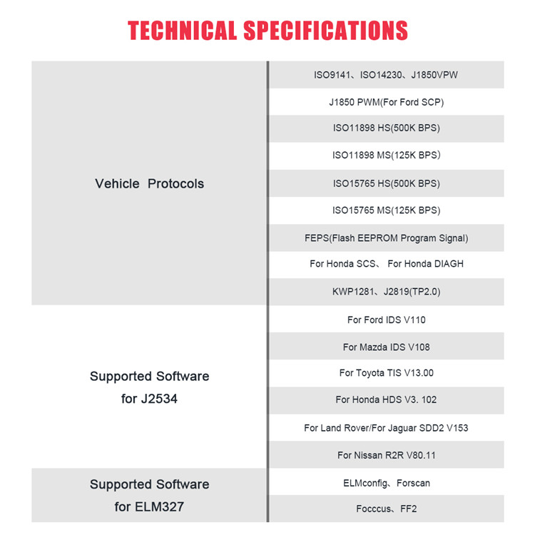

it wont be the only device that doesnt do vpw that claims it does. The popular Tactrix interface advertise that they do, but do not. Also many of the slightly older ebay elm clones that came out had the vpw part of the circuit removed external to the clone main chip to make it cheaper. They knew most people were using it with can, so they mostly got away with it. I would say that its some kind of buggy clone chip, probably based on hacked up early elm firmware, or maybe hacked up allpro firmware or maybe its a stand alone code base of very dubious quality. It almost certainly not a genuine elm (or equivalent clone) or stn chip. It also doesnt make sense that it has elm and j2534 since one protocol is syncronous and one is async, but it could have both looking for intentionally wide compatibility but falling short due to bugs and incomplete firmware on both sides.
Looking at a random add for the device on alibaba its very specific which software it works with. I'd say firmware has only implemented the bare minimum functions these tools use. Maybe try ELMconfig (whats that?) or Forscan and see what it does? Or one of the old TIS or IDS apps it lists. I reckon its the bare minimum those tools and versions need. You might be able to log communications with it and see what it is doing, but I doubt you'll be able to use it as a multi purpose tool.

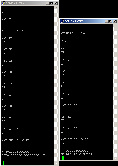

On the left is a SparkFun OBD-II UART (STN1110), on the right is the Shenzhen STIC technology co., LTD SVCI J2534 in ELM327 mode claiming to be a STN1170 v3.3.1. (I should have shown 'ST I' results)
On the left I was able to type in each command ... On the right they had to be pasted.
Hopefully I'll get to pull this thing apart soon, if not I'm going to order one ... Curiosity is killing me!

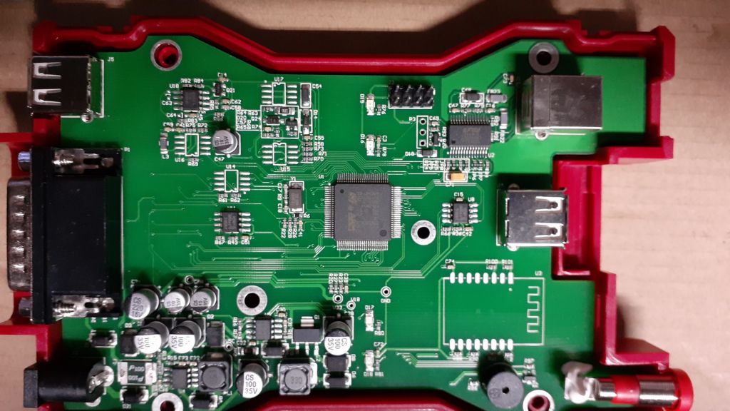

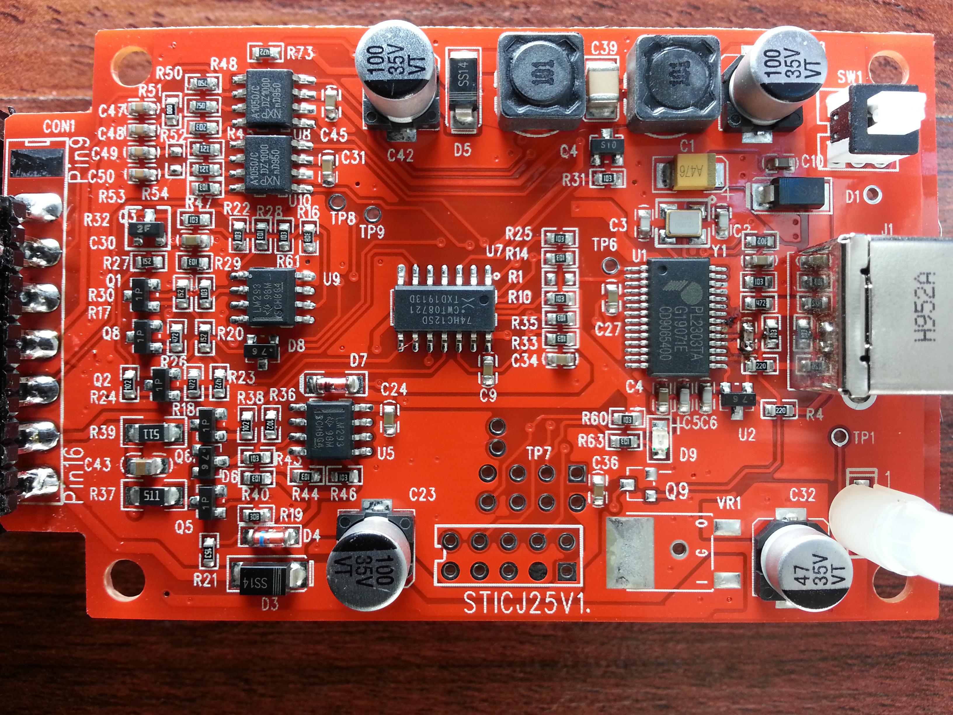

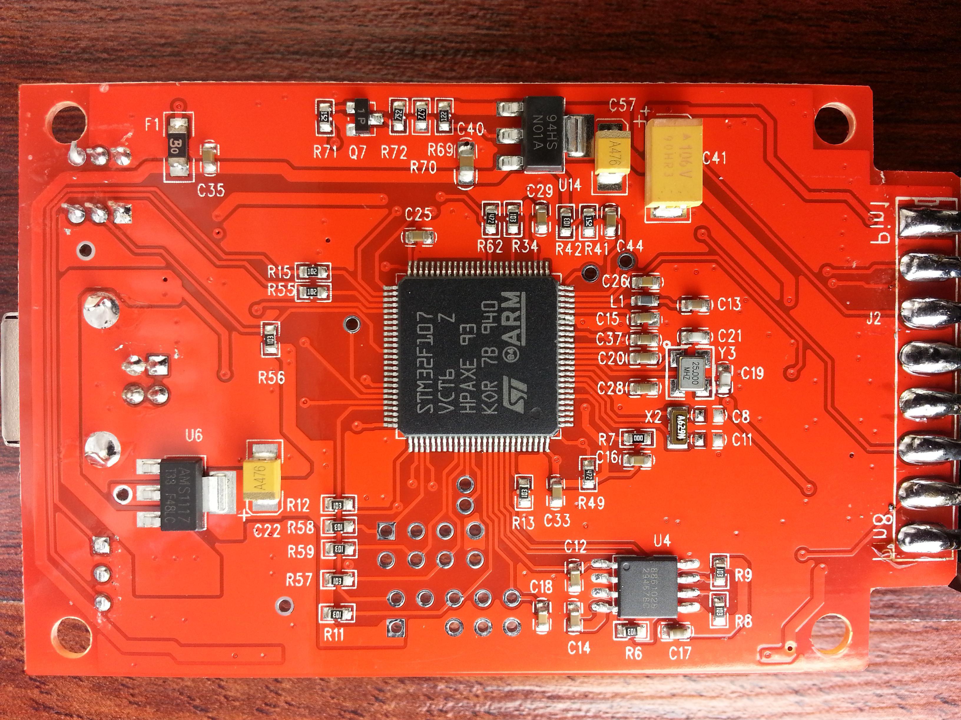

Welp, I haven't heard back on my offer, I decided I'll pay the price whatever it may be and pulled it apart!
And it's powered by a STMicroelectronics 32F107 ARM processor.
And as expected there is no OBD Solutions STN1170 chip that it reports itself as in ELM327 mode ... And doing a very poor job of emulating at that! The bonus, Got it apart without fouling the foil tamper seal! I'm sure I could put it back together and no one would know the difference!

*scratches head*antus wrote:Yep cheap clones and dodgy soft. Enough to do your head in and cause nightmares! I cant see from those which is the VPW pin and where its not connected
VPW neg to pin 6 U8 (CAN L)
VPW pos rough guess pin 7 U10 (CAN H)
Why use 1 CAN transceiver when you can use 2...
They come in different colors.... the price tags seem a bit insane though anywhere from $200usd to $800usd

Not the image quality, just you can't see where the tracks on the board actually go (ignore my pic, it's terrible quality).
My guess for where OBD pin 10 goes is that it goes to a via on one side which is not visible on the other and roughly places to ic U10, it could go to U8 also but can't see any tracks under the chip.

OBD Pin 10 goes down a via and comes back up a via under Q3, goes under R27 to Q1, I think they call it Pin1, it's the single pin by where it says R30.
