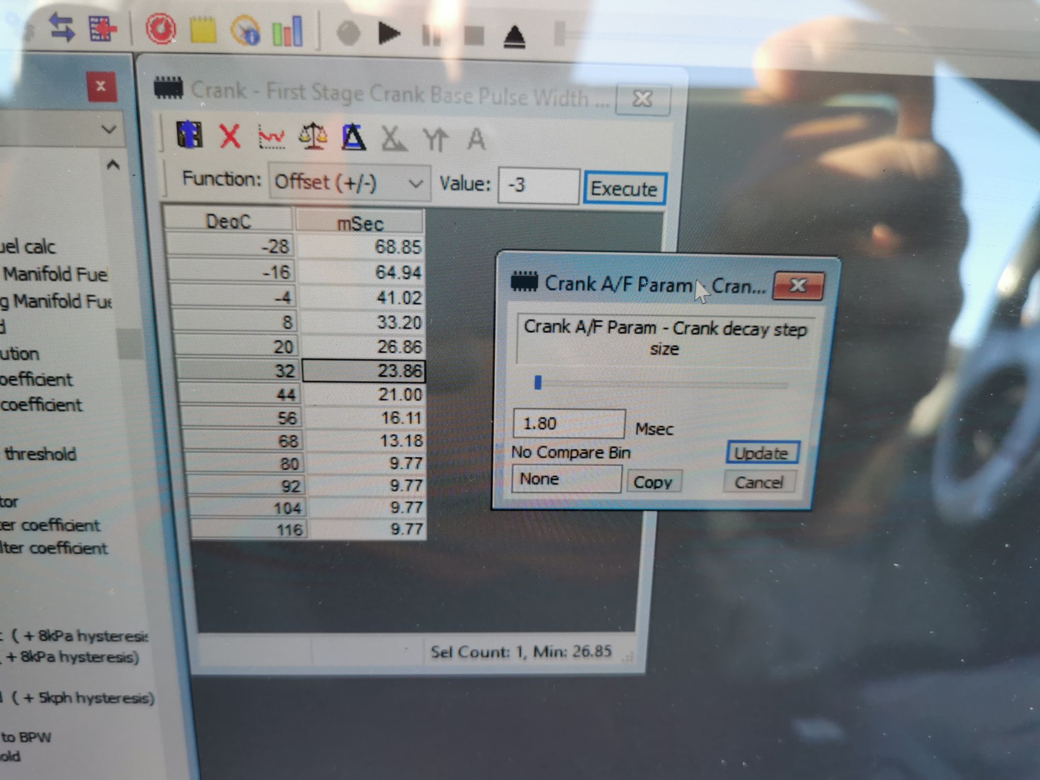

Ok so i lowered the numbers on the Crank first stage base pulse width
at 8 20 32 deg c
Started up after work last night late still stalled
This morning dropped the 32deg c numbers a couple more to blend it all
Done a little bit of reading on crank decay size on the forums here last night.
Mine was on 2.20 Msec
Lowered it to 1.80 Msec
Dash in tuner pro said i was at 19 deg coolant temp today before i started the car. I took a log of it also
Car fired up put into drive and did not stall.
Tho that was only one go at it i will try again later when car has been sitting for a long time, and hopefully a bit colder later tonight after work
Hopefully on a right track here

Re: Cold start car stalls when taking off help needed
Just fired up car after work stone cold started no worries idle seemed good put into drive foot on the brake ok
Went to press accelerator and stalled badly ffs. Ie car barely moved before stalling.

So the AE Fuel Decay Factor he mentions is he refering to the crank a/f param - crank decay step size ?
Does it only affect cranking if so what does it do. Higher numbers means the 1st stage crank base pulse width will inject more fuel for longer on cranking ?
When i 1st started having this problem car would go into drive not stall then if you took off very very lightly it would splutter / hesitate but not stall.
if you pressed the accelerator hard or heavy ish down engine would splutter and just stall.
Once i restart the car after stalling it is perfect no hesitations nothing when you take of from a stop etc.

Ok after weeks playing with my cold start problem with massive help from quipt4it.
Thanks mate for all the pm help
Going over a log i saw when cold and stabbing the throttle on take off map sensor was going up to 120.
Also was showing around 10.2 10.5 afr on the tuner pro dash
which was into the boost area and was mega low timing. Put a couple more deg timing here in the 800 - 1200 rpm areas.
Also slight lean off on the afr boost map for when around 8 - 20 deg c coolant temp
Also smoothed out the complete idle timing map so that it matches the low load area which of the top of my head was around 24 deg of timing.
Double checked my air fuel ratio with my wideband again and that was still good.
I have had coolant temp on a cold morning down to 15 deg c so far and been good.
Still have a of take off very slight hesitation around 20-35 deg c coolant temp but il play with the Ae temp factor vs coolant temp a bit more and should be able to get it mint.
