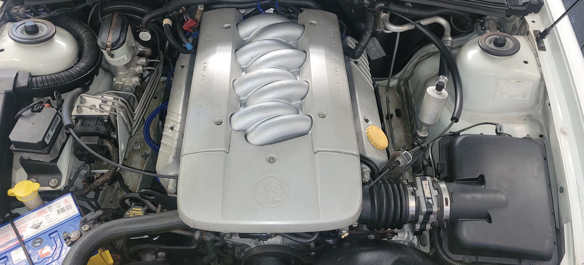

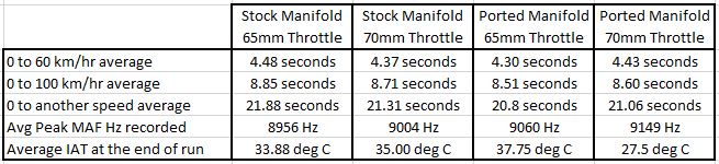

The mildly ported manifold is fitted, and I have got some more data. I did have a slight hiccup with the alternator deciding it didn’t want to charge anymore. Luckily I had an old regulator as zero chance of buying one locally on the weekend.
But the results are nothing spectacular. It certainly hasn’t gone backwards, but the improvement is only slight. I also put 50 litres of fuel in before the test on the stock throttle body so it would have been a little bit heavier but there’s no excuse, the difference is really not that much. And whatever improvement is there you would probably never notice it.
The surprising thing is that it performed better with the stock throttle body, which isn’t really consistent with what the Starr manifold achieves so I must be doing something wrong. Either that or the gains that everyone claims from a Starr manifold on a stock engine are just not there - which I am more inclined to believe. What I do know from my crude flow testing is that the manifold I fitted had virtually the same size runners and was significantly less of a restriction than an un-ported one. So if there was not much gain, then the stock un-ported manifold and throttle body can’t really be a restriction and limiting performance. Which I guess is consistent with what I was thinking with the cylinder head flow rate with a stock cam being a good match to an un-ported runner.
One interesting thing was that the peak MAF Hz recorded with the stock manifold was always in first gear. Now with the ported manifold, it is hitting a higher value in first gear, but the max recorded is now sometimes in second gear.
Also interesting was that it was significantly hotter when I ran the stock throttle body – 37 degs C IAT – and significantly cooler again when I ran the 70mm throttle - 27 deg C IAT. And I can’t blame slower gear changes or trans slip as the larger throttle was slower from 0 to 60 kph as well.
Anyway a bit over 0.3 seconds quicker in 0 to 100kph over the stock manifold.
Bit hard to tell, but the TPS looks to be around 1% less for 60 kph comparing the stock vs ported manifold with 65mm throttle bodies. It’s not much, but perhaps a fraction more vacuum at cruising speeds. Hard to judge as 60 kph is only 3 - 4% TPS.
I don’t really know of any decent online calculators to calculate hp from 0 to 100 kph times, and their accuracy is questionable. But a bit of messing around with what I could find on google shows a theoretical gain of 8 to 10 flywheel horsepower for a 1850kg vehicle. So I guess if it is making another 10 hp just from making the manifold more efficient you could count that as a win, but there’s still no conclusive proof. Then again, you could probably spend more money than what I did porting this manifold on an underdrive pulley for an LS and have change from 10 hp as well.
Sadly all I have proved is that on a stock 304, smoothing the runners, bell mouths and neck gives a very small gain - arguably a complete waste of time and money. It’s not at any risk of blazing the rear tyres anymore now than it was before.
And nothing really to be gained with the larger throttle body, so the stock 65mm throttle must not be a restriction on a stock engine.
But unfortunately I’ll never know what the story would be if the engine had a bit more cam, compression or capacity which is what I really hoping I could do. If anyone else has a crack at porting one of these manifolds in a similar way for a worked engine, would love to see the results. Hopefully I have detailed the way to clean the runners and bell mouths up without cutting the base out with enough info for anyone else to give it a go, with or without the hydrochloric acid. I still think this porting has some potential.
These are the star flap discs I used https://www.digikey.com.au/en/products/ ... 58/3592010 If you bought 10 that would be more than enough to do one manifold.
Anyway it is what it is. The Calais was leaking a bit of oil through the cork gaskets in the valley so the manifold had to come off regardless. Not much lost and a fair bit learnt, and a couple of oil leaks fixed.
Its all back to normal now with the original CNPK memcal and original throttle body and back in place.

That's actually very interesting and makes me think something else is holding it back. I've never looked at the tunes in these but has me wondering about em.
On the older 304 models you went from a stock SS @ 165kw to HSV 185kw with just a slightly improved air box, better exhaust and a tune (2° more timing).
VT 304 has better heads/more comp and more cam with sees you starting off with 179kw which HSV pushed up to 195kw so there is definitely more to be found but clearly it's not the intake that is holding it back.
The more I think about it, the more I think there is something going on in the tune and as with the ecotec V6's, with the MAF, fitting a larger TB really requires a few tune adjustments to see the benefits.

I think the stock cams have the same profile/open area from flat tappet to the roller. But the VT 195 kw version got the Crane Compucam 2020 which has a bit more lift and duration (198 @ 0.050 and 0.432" valve lift) and a tighter lobe sep. So 16 flywheel kw for the cam, headers and tune basically. But yes the hotter intake temps make no sense at all.
And a mate has pointed out to me that there is a section on the Starr manifolds in the How to Rebuild and Hot Rod Your Holden V8 book, of which I have a copy, but wasn’t smart enough to read it earlier.
But the book claims that the Starr manifold was only good for 10 rwkw on a stock 304, which is a lot less than what I was under the impression that they make. I don’t agree with everything written in the book, but I think that figure is fairly credible so I think dispels one myth. But I recon a good part of that 10 kw would be from the better air box. So again, on a stock 304 you could leave the banana manifold as is and get the same gain just with a MACE air box. I see there is also an aftermarket replacement air box now that looks factory but has a 100mm inlet. It’s a bit expensive and doesn’t increase the air filter area, but would look factory still. The book also says with the larger neck and throttle body that air flow is now 190 cfm per runner, which I don’t think is a credible or sensible calculation as I think there is only 2 and a bit cylinders with the intake valve open at any one point in time. It’s not really as simple as just dividing everything by 8.
It also says that the runners are 43 mm diameter, whereas I measured 41.5 mm - none of the manifolds I have been involved with had 43 mm runners, but I guess I can’t discount the possibility that some manifolds may of had a slightly different casting.
Anyway, as flawed as my testing was, I’m thinking if you want to add more cam, compression or capacity, then fit a MACE air box and spend $100 porting banana manifold and I recon it will be up there with the Starr Manifold.
