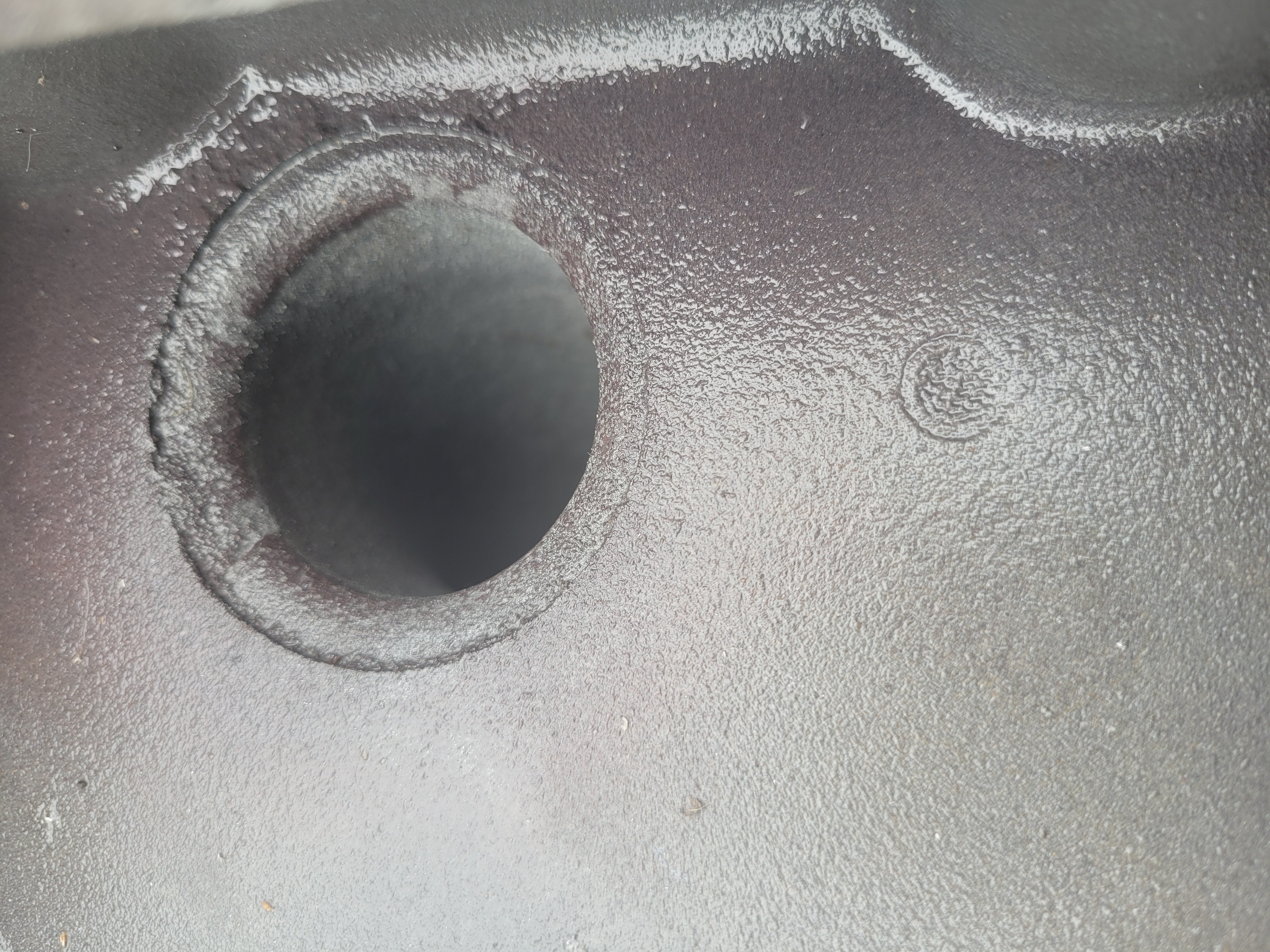

This is what it looks like inside.
I measured the fluid volume of each runner and Cyl #1 and #2 hold 500ml, and all the rest hold just a fraction more. The diameter is around 41.5mm, and they are oval by around 0.2mm. I did read that the runners were only 30mm in diameter, which I now know they are not.

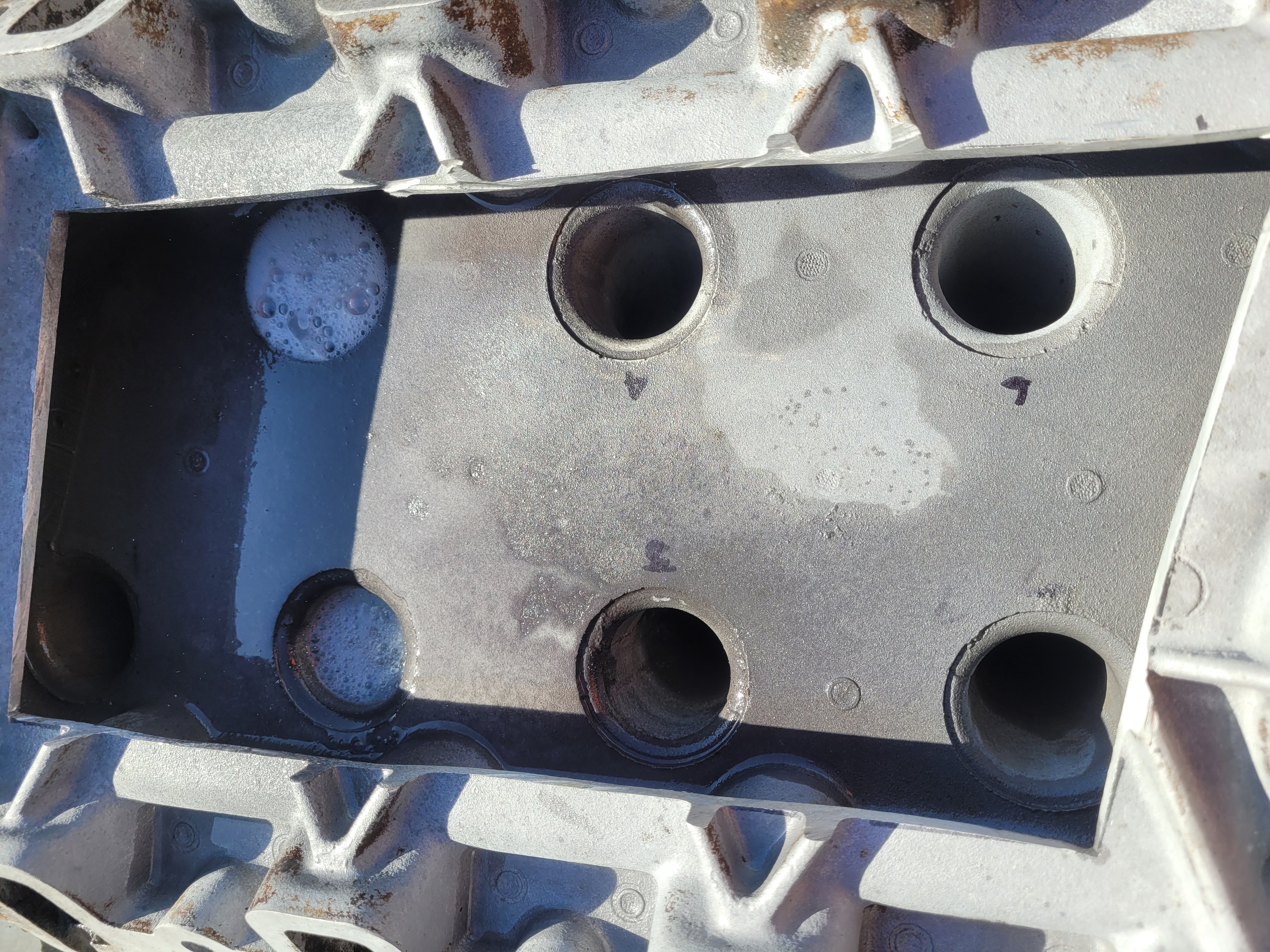

I set the manifold up upside down, level on the work bench and my intention was to just add 500ml of a water/acid mix to a runner to see what happens. That way it would just fill the runner only and not the plenum and hopefully only port the runner and nothing else. The last few inches of the runner where it turns into a rectangle to enter the head isn’t touched by the acid mix. First runner I tried to acid port I mixed 250ml of acid with 250ml of water - it ate a hole through the runner after about 5 minutes.
Next runner I tried I diluted it down to 50ml of acid to 450ml of water. It certainly reacts with the aluminum, and I left it there for a few minutes before draining and rinsing it out with water. But it didn’t show an increase in runner diameter or volume that I could measure. So I did the same again and left it overnight before draining and rinsing it out again. Still in no increase in volume or runner ID. But after the 4th acid treatment with water flush, I measured an increase of about 0.2mm in the runner ID. After 6 treatments, the runner was a bit over 0.70mm wider in ID. If I keep going should be able to get somewhere over 1 mm bigger which is probably all that extrude honing would do. Only not as smooth.
I also tried another runner with 100ml of acid mixed with 400ml of water, but it bubbles too much that it spills out into the plenum where I didn’t want it. So looks like a ratio of 10% acid or less works best. Using hot water from the hose to mix with the acid also seemed to make a difference. But it would appear that patience is the essence here and multiple small doses of acid are the go rather trying to take more off each time with a stronger mix.

This is an action shot of the acid port in progress. Cyl #2 has the 50ml acid 450ml water mix. Cyl #3 has the 100ml acid 400ml water mix which has bubbled over and spilled into the plenum Once it settles down, the level is lower than it should be. Cyl #5 was the runner that had I tried first.

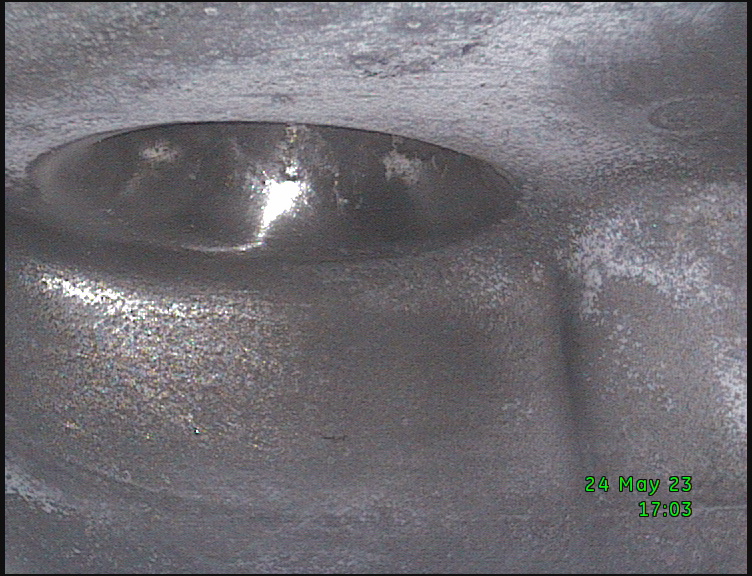

So I have now done 24 acid treatments to the Cyl #2 runner in total, and the diameter of the runner has increased to be approx. 45mm now. If you could somehow polish the runner surface I think it would end up closer to the 45.5mm mark. But clearly there is a limit to how far I can go with this as the runner are nearly 2mm thinner in the wall already. As before, I don’t have any real knowledge on manifold design, and no idea of what runner ID would be ideal, but this acid porting could go some way to getting the bananas to flow closer to what the cylinder head does. Who knows, a manifold ported like this may be worse than one that is untouched, or it may be better and pull less vacuum at full noise. Or full noise might just be a few rpm higher. Smoothing the bell mouth would be a challenge unless you commit to cutting the base out of the valley and are prepared to TIG it back in. But that too would no doubt help contribute to better flow. Anyway the banana manifold could still have some potential for less than a $20 outlay – obviously not this one, but another one.
It looks pretty rough in the photo but actually isn’t all that bad. The bell mouth is pretty much as cast still. Still have a lot of acid left over so will see if I can replicate this on another runner and get the same result of 24 acid doses to get 45mm ID.

2mm increase is approximately 10% increase in area. I am surprised the acid is disolving the manifold in some sort of proportion. I find acid selective and it might just pick one spot and eat a hole in the manifold.

I would have thought the same too, particularly based on the first runner I tried with the 50:50 acid mix.
But from what I can see with a torch through both ends of the runner, it all looks OK. I don’t have access to a boresope at the moment, but with my cheap inspection camera from what I can see it still looks OK too.
I’m only using a glass beaker to measure the runner volumes, but that runner now holds around 570ml.

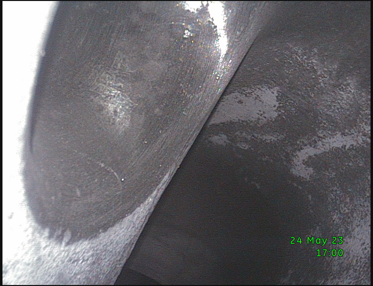

I bought a manifold for $60 that was in decent condition just to have a crack to see if I could port it successfully. I did all this a while back but until yesterday haven’t had access to a borescope to see the results. I still need to get the manifold sonocleaned as there is still a white powdery corrosion on it still but it is what it is.

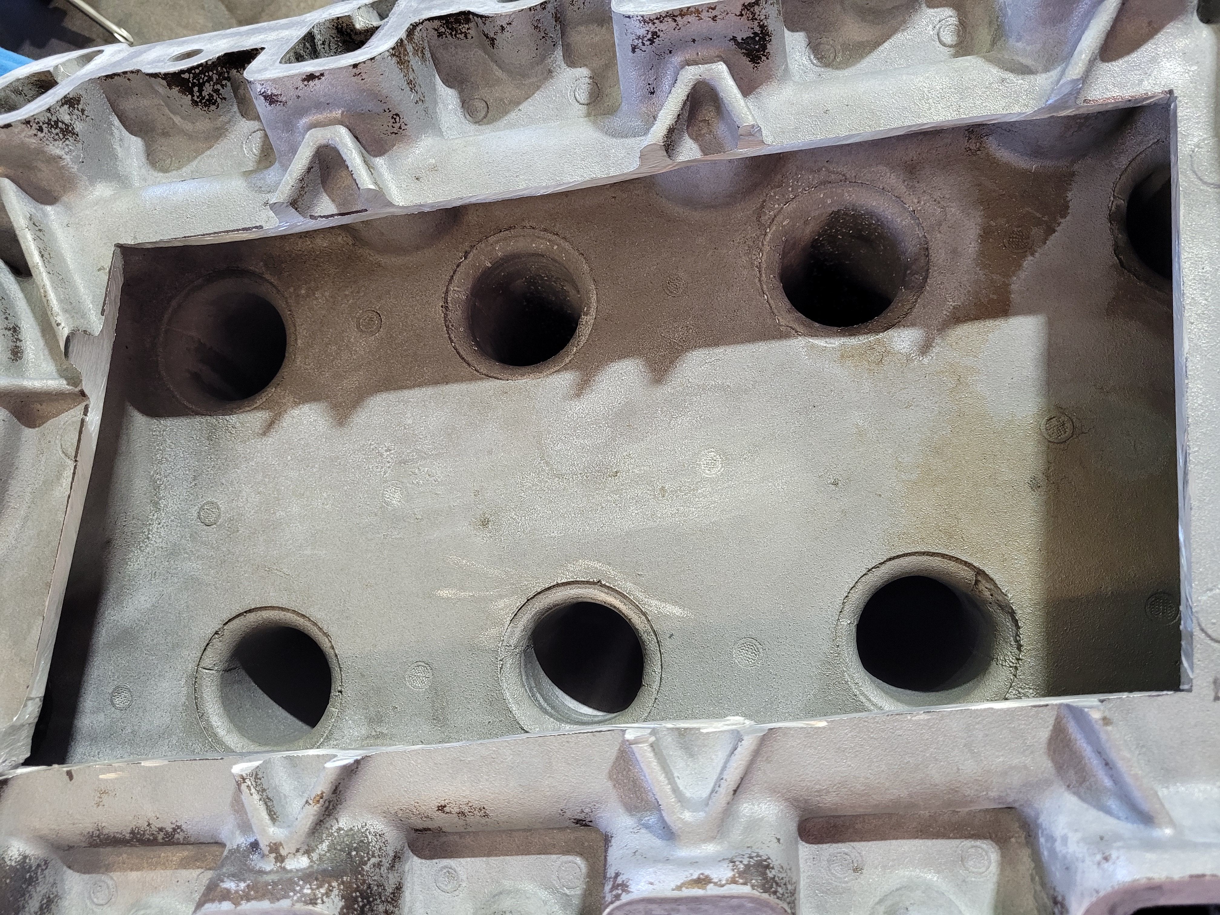

Basically what I have done is blocked off the throttle body entry with a plate, and set the manifold up level on a bench only upside down, and blocked all the vacuum ports off. I have then filled each runner with the 500ml of water acid mix, allowed it to react for a few hours, then rinsed it out. And then repeated this 14 times. And for 3 times, I added an extra 1 litre of water acid mix to allow it to spill over into the plenum to work on the roof of the plenum. I can’t measure it, but my best guess is that each runner is now around 2mm larger.
I then set the manifold up on the bench right way up, and added 1 litre of water acid mix to work on the plenum floor. I did this 3 times as well.
Next I suspended the manifold so the throttle body flange was pointing down and used a funnel with a hose through a runner to add 750ml of water acid mix to work on the neck/elbow which are touted as being up there with the worst culprit for restriction. I had run a smear of silicon around the throttle flange as I didn't want that area to react with the acid. I treated this with the water acid mix 7 times.

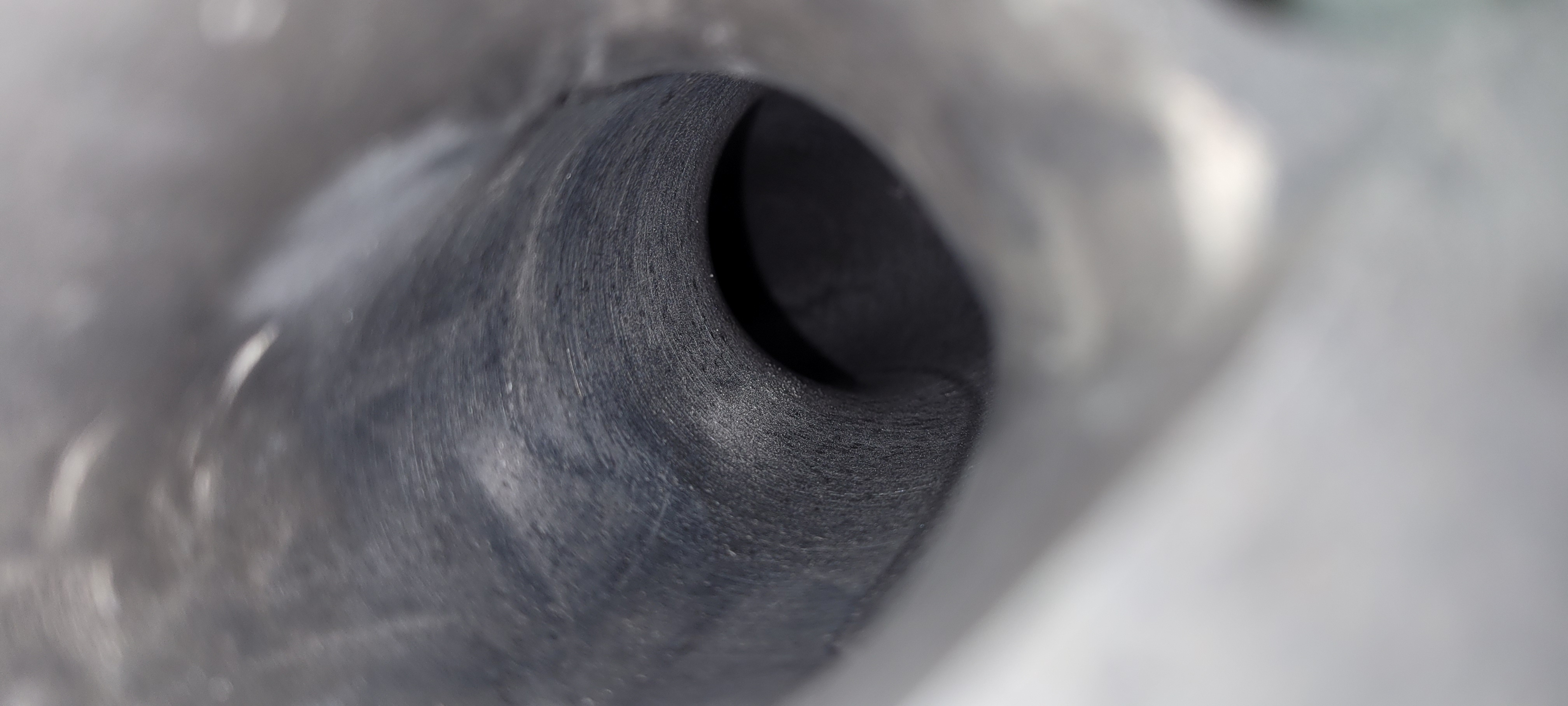

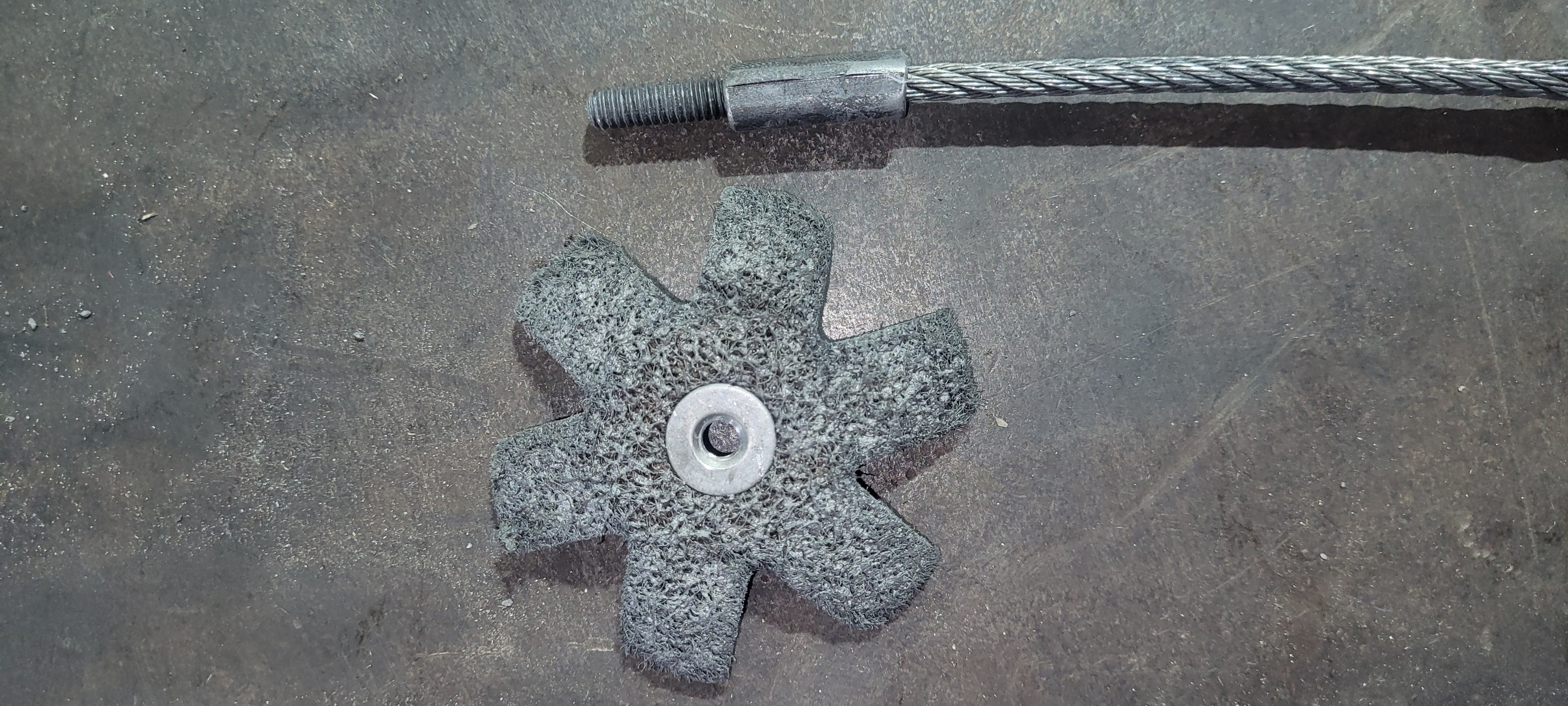

This is a photo of what the neck looked like after reacting with the acid and then after I have cleaned it up with a cylinder flap disc. The ID is now around 70mm. Then to clean up the runners, I bought some of these cheap and nasty star flap discs. I had some 5mm cable already, and used a cable crimper to lock it on to a short piece of 3/8” rod bored out to ¼” with a cut off ¼”unc bolt in the other end. The other end is the same only with no thread so I could put it in a die grinder. I went through a few cables as they eventually break. No real loss as it only cost me a few dollars to make each one but it seemed to work OK. The runners didn’t really need a lot of work and they are arguably smoother than the factory finish. There is a casting ridge (or trough) in some of the runners that you can’t get rid of, but the rest of it comes up OK. The runner entry with the bell mouth though I think is much better. And after a few too many beers, I lashed out and bought one of these cheap Chinese concrete screed motors. I made up a simple frame to mount it to the manifold, and added some ceramic media with some water and truck wash and let it rip. It takes a while, but it did actually make a difference to how smooth the surfaces were. I basically just suspended the manifold in various different planes, and just kept moving it around to let the media work on as many different surfaces as possible. It didn’t really work in the runners as I found the media would get jammed, but it seemed to work ok on the rest of it. Anyway I had my doubts about that motor but it probably ran for over a week all up non-stop and is still fine. Anyway below are some of the photos of the runners and bell mouth where I have cleaned it up. As above it needs a decent clean, and whether it is an improvement in engine performance or not is unknown. Clearly it’s not as good as cutting the base out and attacking it head on, but considering it was mainly time invested, the result isn’t too bad I guess.
- Posts: 2678
Re: Holden 304 Banana Manifold
Yeah WOW!!!! Nice job indeed
I'd love to see back to back dyno results
