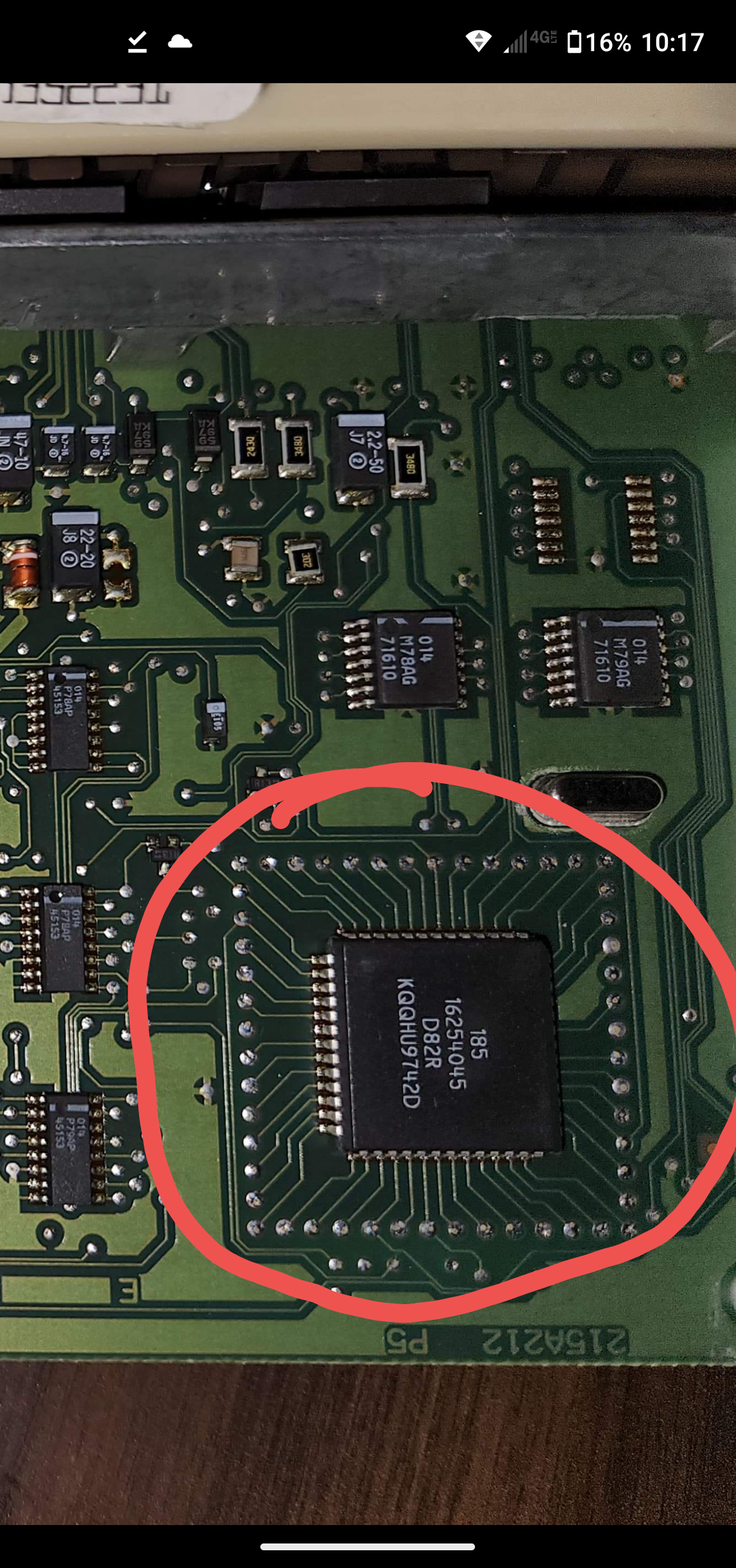

Asylumwarp
Posts: 11
Joined: Sun Jul 03, 2016 5:11 pm
Re: Trying to find the EEPROM in a 98 LS1 PCM
Post by Asylumwarp »
This has internal memory and is a MC68HC11E9 which I believe is an early attempt at a slave chip. For the main cpu it's a 68332 which I don't believe contains any onboard accessible memory
The e40 slave chip I believe is the newer version of this design going from 8 bit to 16 bit.. I 99.999999% believe the vin and serial and crank sensor code is inside that 68hc chip.
