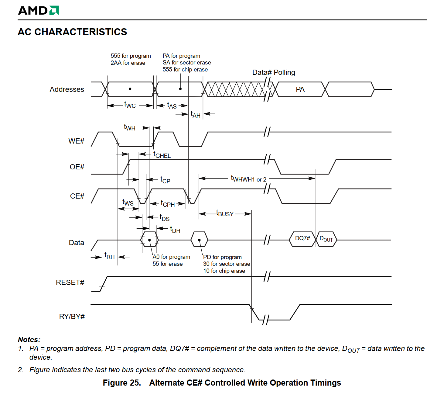

maybe we should be looking at this one? Page 40 of the data sheet. Specifically im wondering about WE# for write enable. Do we leave it high? It seems we need to during programming.
