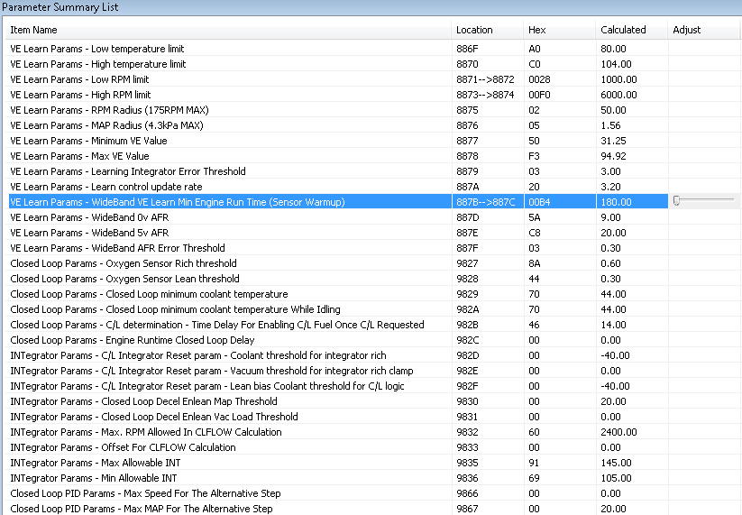

This may be a silly question but if stock narrowband & nvram fitted will it VE learn from it or does it have to be wideband?

Have a look in the XDF, there is narrowband and wideband VE learn. Narrowband learn only does stoich areas.

Sounds ok for testing with just stoich areas for narrowband & once setup I will get wideband in the bung!
I had a look at xdf & saw items for wideband learning but nothing really jumped out to say it will narrowband learn (image attached).
Thanks for the response!
- VE Learn scalars.png (35.55 KiB) Viewed 5585 times

Just noticed the flags to set for wideband or narrowband VE learn, not to mention a cool closed throttle VE table that could come in handy for bigger cams!
