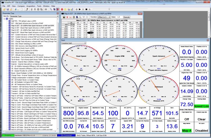

This is the OSE 12P software for your delco '808 engine computer. Main features are boost, wideband support, and realtime tuneability with windows support on the PC side.
So, to get OSE12P working just download the package below and burn the bin –there are V6 and V8 bins. The XDF is FULLY featured thanks to Antus and his fantastic script to generate the XDF. There are ADX files for Tunerpro 5 (1,2 and 3 bar) thanks to Holden202T and also TP5 bubble tracing thanks to Jayme.

Screenshot:
