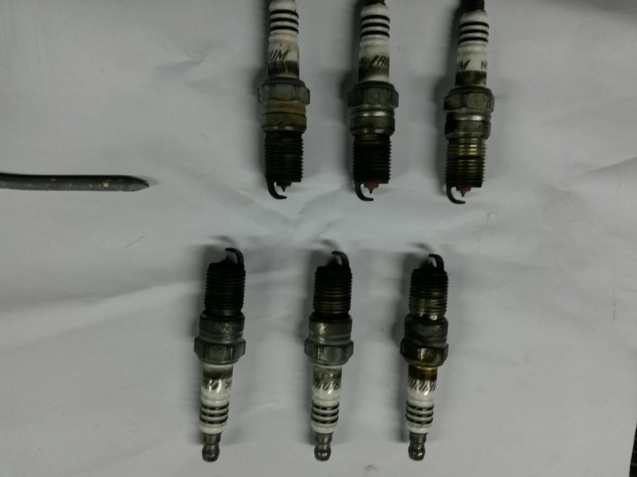

The old plugs were iridium's, have done 64,000km + and been in the car 3 months shy of 3 years. I stopped trying to measure the old plug gaps at 0.062" ......
New plugs are Autolite 606's (stock heat range I believe) gaped at 0.054" (1.37 mm) running ~11psi boost, gave it a decent boot full on the test drive with no missing or knock retard that I could feel but will have to confirm with a datalog at some stage.
As a bonus the car is idling smooth now and the brake pedal seems firmer as well.
The old plugs (it's crap phone pic but maybe you can tell what fuel I run by the colour on the plugs), Trans also got 4 litres of new fluid, I cheated, I dropped the cooler line, pumped out 4 litres, topped up 4 litres with Penrite Full Synthetic FS and called it good, can definitely feel when it has got fresh fluid in it

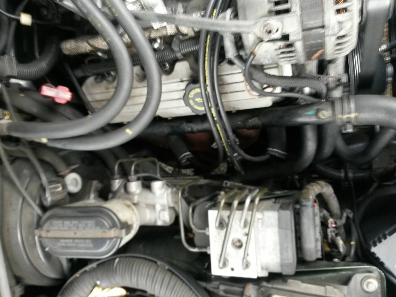

Finished the new lead install today, forgot the heat shields last night (forgive the crappy phone pic).
Still need to make some wire separators to tidy the install up a bit more and number the leads. Also coated the inside of the boots with some dielectric grease, made fitting the leads much easier and hopefully the removal smoother in the future too.

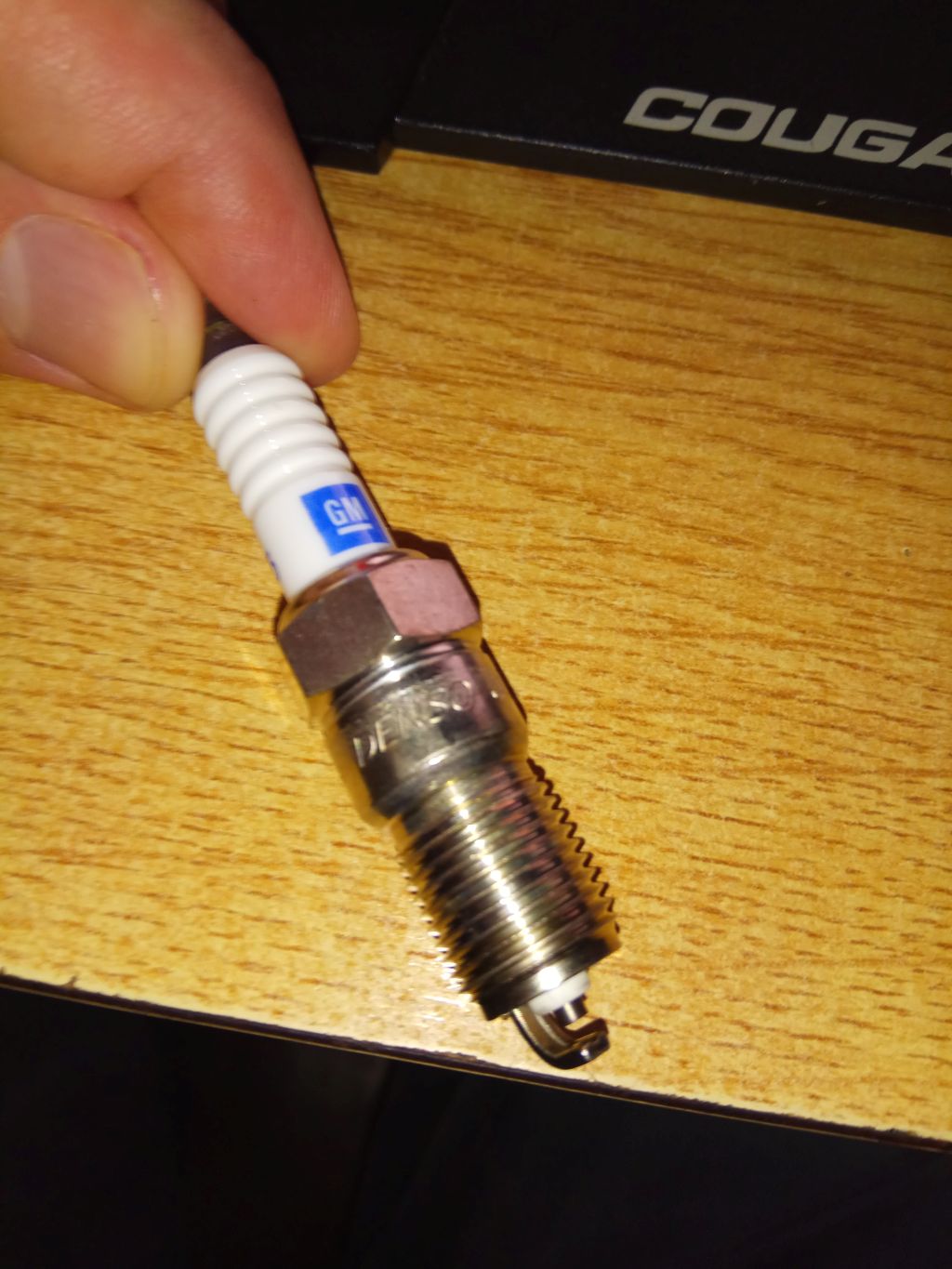

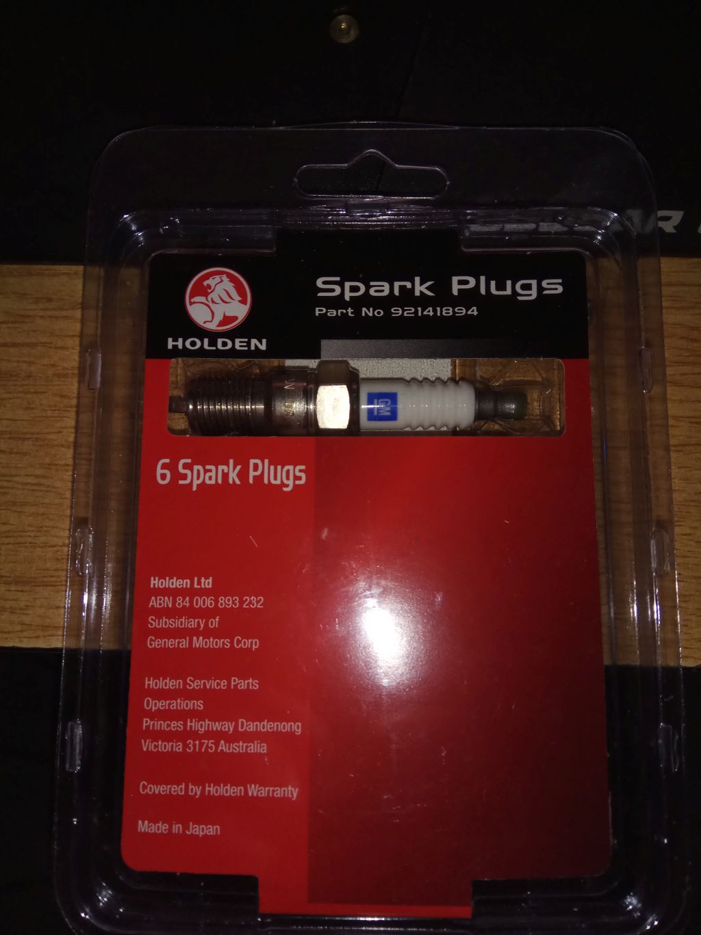

Here's a pic of the pack i buy, there genuine holden pack but basicly rebadged Denso and has V Groove tip. I got 4 packs last time and paid $15 a pack. I use them for 10k and put new ones in, even after that they still look ok and gap fine. Not sure about getting these in NZ, perhaps holden dealer, i can't find anything on ebay with cheap postage.
