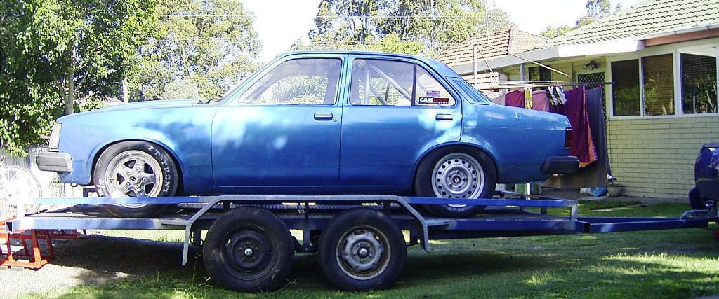

well i emailed king springs to find out the standard eye brow height of the gemini, according to them its factory spec is
front: 365mm
rear: 345mm
so their lowered coils are
front: 330mm
rear: 320mm
so i measured my car and it is
front: 280mm
rear: 260mm
so im guessing i either have something like super lows in the front and something that sat right in the rear after cutting..... either way im thinking i'll go up to the low settings, that should 1. give me more ground clearance to stop it hitting on the trailer and 2. move the tailshaft a good few inchs away from the floor and resolve that issue aswell as stiffen the rear a bit .... so i will most likely go that route and see how it goes.

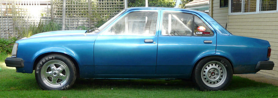

well here is the end result ....
before
after
fronts slightly higher in comparison to the rear but im not too worried, plus if anything i think the LS1 and T350 will be heavier than the 202 and trimatic so it will drop a bit sooner or later.
either way theres about 3 inchs between the floor and tailshaft now so if it hits somethings majorly wrong!! (was about 1-1.5 inch before)
before
after
