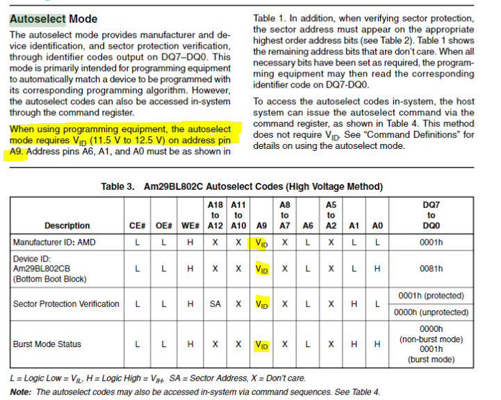

I guess it takes a pic to make it stick!
What is this SIM $20 :? :?:

Post by Tazzi »
Required for our command mode. :)
Posts: 9009
Re: PCM Hammer P12 development
you're reading that wrong. thats "in a programmer". Because the programmer is too dumb to do it through the command register. In system the command register sequence is fine.
Posts: 2332
Post by Gampy »
Tazzi,
We are doing In System programming, look straight to the right of your (When using programming equipment) highlight, you will see the In System paragraph clearly stating it does not require Vid.
