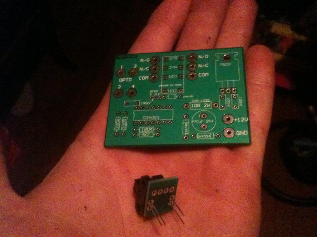

PCBs are here!
PCBs are here!
- Circlotron

- Posts: 8124
having the brackets laser cut now. Getting about 10 made for about $25, sweet!
