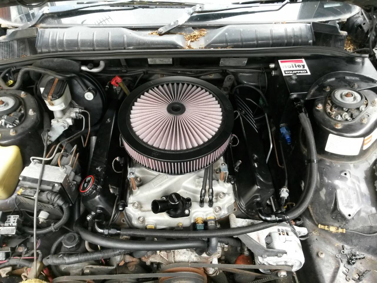

Did a bit of work on the missus car recently including it's 200,000km service. At the same time I installed this,
The clean air oil separator is fitted in place of the breather hose that normally comes from the bottom of the TB and goes into the side of the blower below the boost valve. The clean air separator has a much smaller orifice than the standard breather hose and I had to adjust the butterfly stop screw as the as the IAC was open a lot further as there seems to be a lot less air flowing via the PCV system.
Car is running really well and seems to like the Autolite plugs fitted last time around.

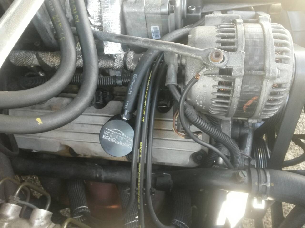

It's been a long time but I need to finish the Senator, recently I added a catch can to that also. Looks something like this now, I have a different power steering bracket on the way so I can clean up that area.
It's been about 2000km since the service and the oil level on the dipstick has not changed

So it's been about 2500km since the last oil change and no noticeable change in oil level so I'm calling this a win, on the other hand, getting another PS bracket over from Aussie has turned into a total head fuck because of an error on the declaration costing someone an extra NZ$147....

Yep, my conclusion is the amount of airflow via the PCV system was to great in volume and was taking to much oil vapour with it. Last year I fitted new LIM/gaskets so I knew everything was spotless. Some months later I lifted the blower to fit the MACE 25mm insulator and there was a noticeable film of clean oil inside the LIM which really could only have come via the PCV system. When I originally did the LIM I also removed and cleaned the PCV valve and it seemed to be free and working so I'm not sure what the go was there, maybe it was faulty and not regulating the amount of flow correctly?

Checked the oil level today and it has definitely dropped. Spirited driving = oil consumption. I'll hook up the catch can promptly and see if that makes any difference.
Could definitely tell it had sucked oil during the drive as the brake pedal started to get more travel. For a good portion of the drive home I took a different route which was a lot more winding and up and down so it spent a fair bit of time locked in 3rd, accelerate, brake, turn accelerate etc. With it locked in 3rd engine braking works well but that also sees the highest vacuum in the intake which would pull hard on the PCV system...
