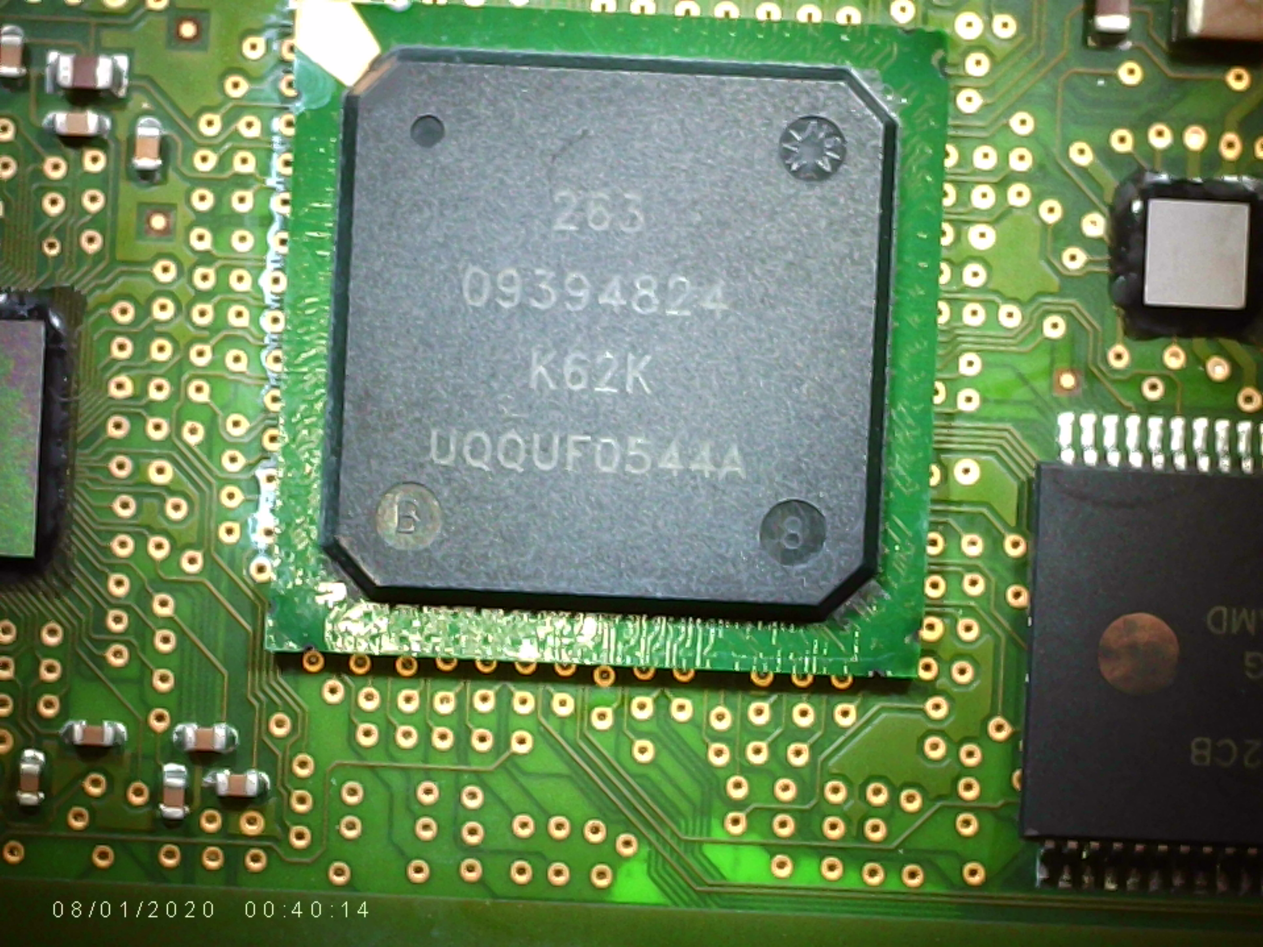

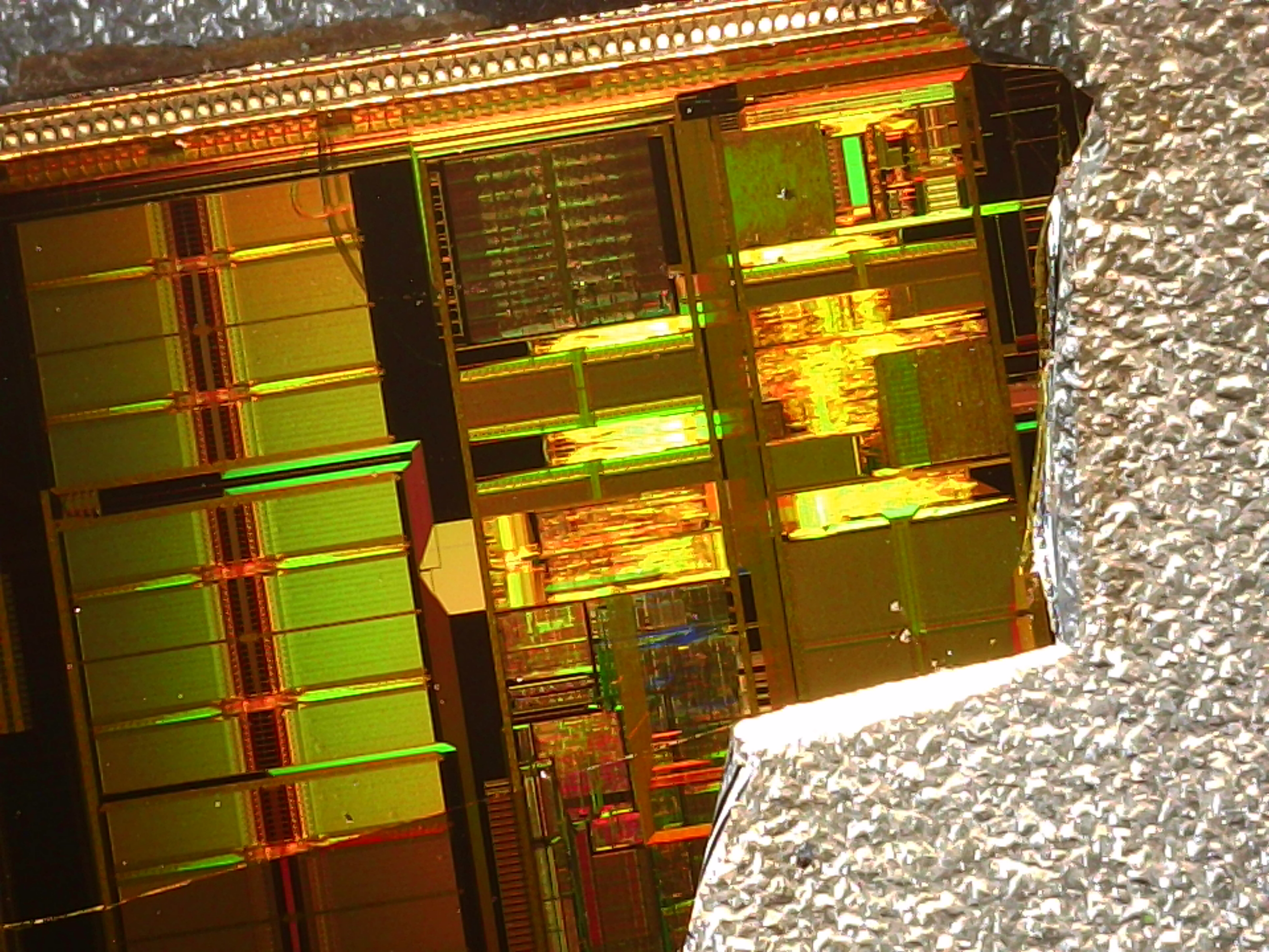

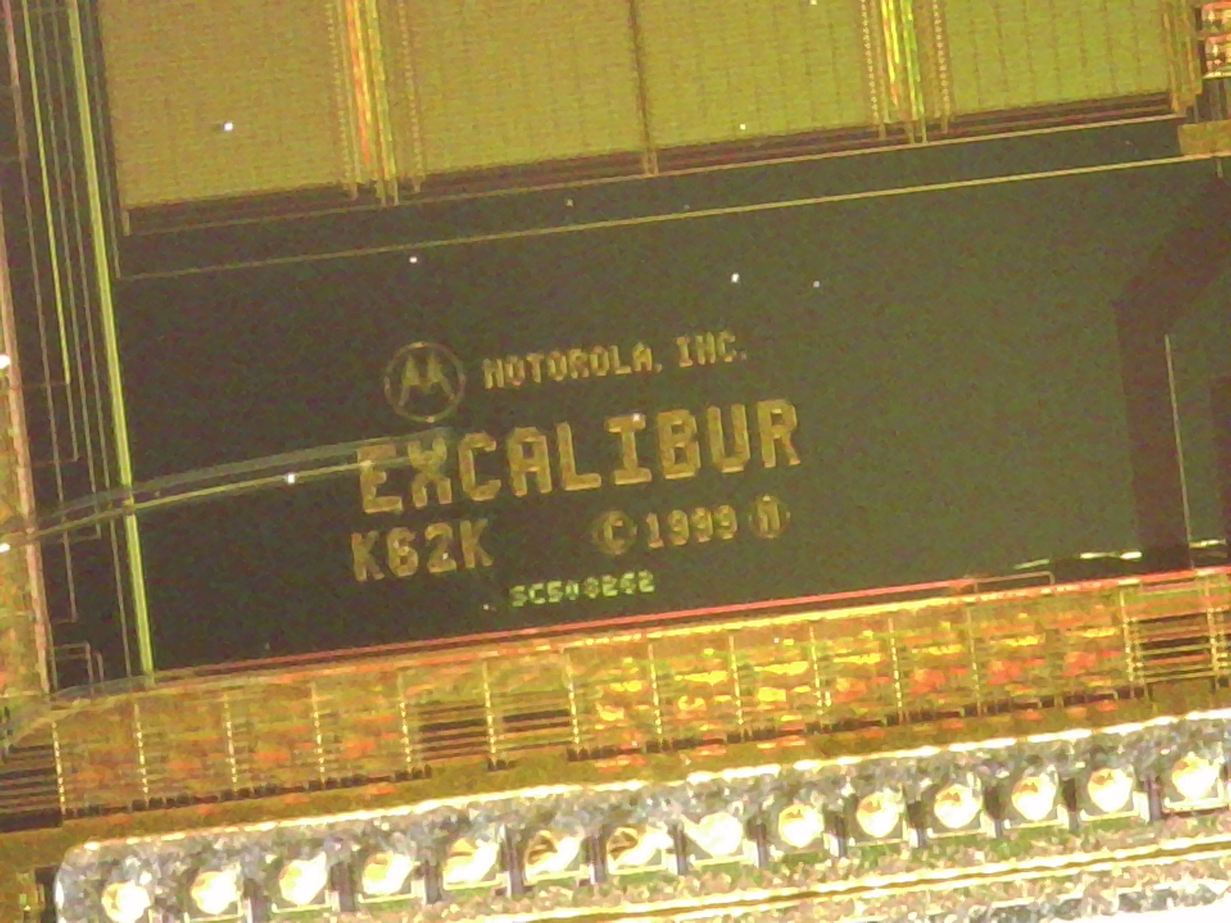

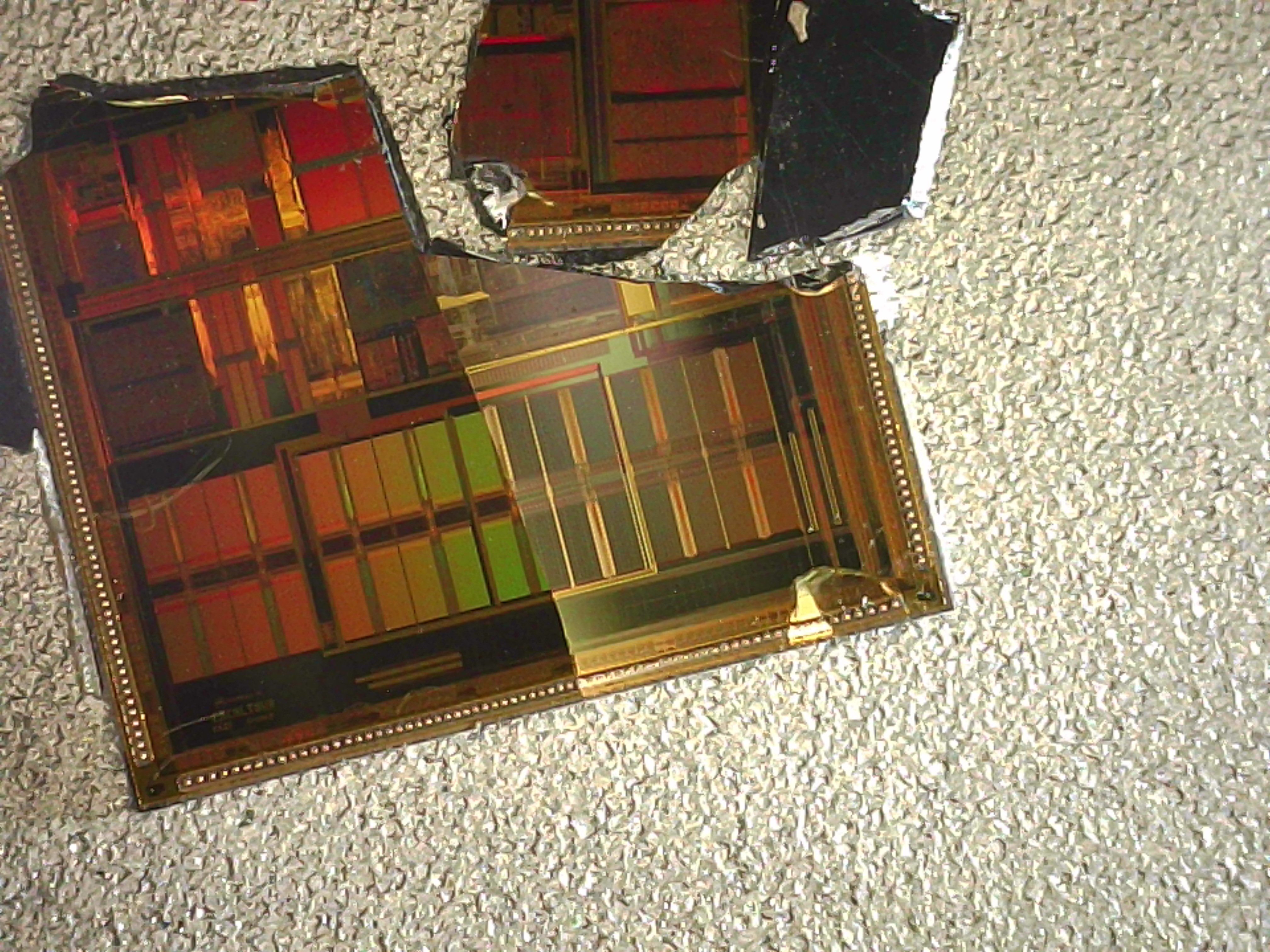

One thing I do know is that the P12 definitely has two CPUs, and so does the P10. In the P12's case, Cerebrus is the 2nd CPU in my opinion looking at its complexity under the microscope. I am 100% confident after stripping down the resin off the core of the large chip that looks like a large computer CPU, I would say that has to be the main CPU. It is much more complex than Cerebrus. I have yet to find a data sheet for it, however I think it is safe to call this one Excalibur.
- Posts: 9008
Re: PCM Hammer P12 development
love your work! well done decapping it and getting those pics. Hard to make anything of excalibur without the commercial part number on it like the cerberus, but cool factor is right out of this world. If were lucky someone who knows something will find this and jump in with some details.

K62K is mask id specific to motorola. Each cpu have that code, and there is some charts flowing and utility to convert mask to cpu number, but most newer auto stuff is not included.
