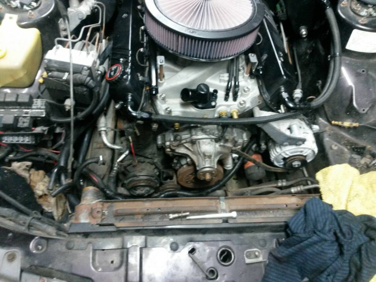

Got a little bit done today. Stripped out the PS pump/bracket and pulleys from the WP and crank. Plan is to push the car out next week and de-grease all around the long block before going any further. Will probably remove the alternator/bracket before doing so. Trying to see if I can route the main starter motor power cable around the bottom of the engine instead of over top the timing cover to neaten things up a bit. Holden really did a piss poor job of routing the transmission cooler lines/AC hoses etc Just looking at those is pissing me off now that everything else is out of the way...
Back on shift tomorrow so there won't be any more progress till next week.
edit: forgive the crappy phone pic...
- Posts: 2678
a crappy pic is better than no pic
oldn64
- Posts: 256
- Joined: Mon May 28, 2018 7:05 am
immortality wrote:... forgive the crappy phone pic...
What is crappy about that pic..... has a v8, is an aussie built car and is a holden.... all winners
cheers
oldn64

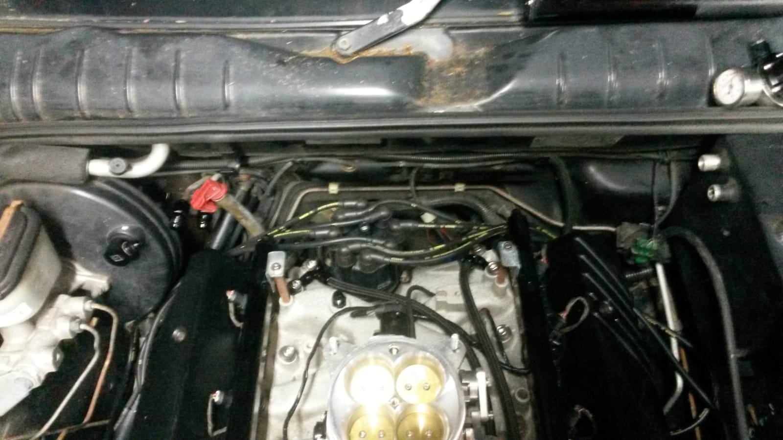

Change of plans....
The FPR is now going to go onto the end of the passenger side fuel rail and just reverse the fuel flow through the fuel rails, that fairly much solves my space issues with the FPR/trans dipstick tube. Just need one different fitting which I should have next week and then the fuel rail issues are sorted. Need to find a local supplier so I can make up some new hard brake lines from the MC to the ABS module. The OEM ones were totally in the way so I ended up bending em out of the way....

I’d be keen to see some photos of how you end up running that main battery cable once your done. Holden didn’t put it in the best spot and over the timing cover takes up a lot of room. Think its got the alternator wiring in there as well.
- Posts: 3820
- cars: VS,VT,VX,VE
Looks like it's going to need to be unwrapped and modified a bit. I tried putting it under the oil pump put the alternator wires weren't quiet long enough. Hoping that I can get a bit more cable length by pulling those out of the main loom. All going well I should make it all fit without cutting anything.
