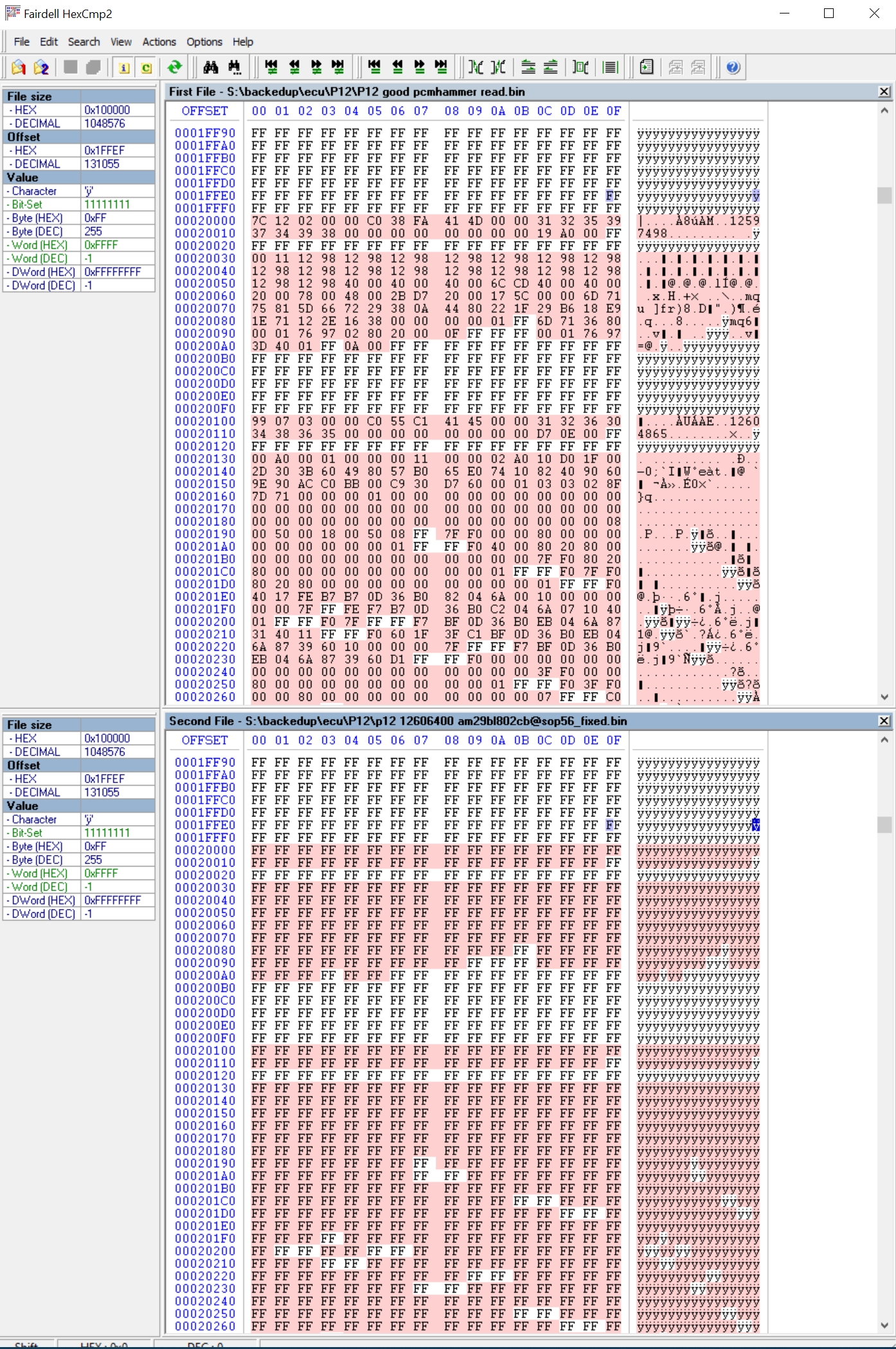

- Posts: 10016
Re: PCM Hammer P12 development
I think the fail fail on checksum error is more than a minor fault. Here is the read from a good pcm with pcmhammer compared to the read after the bad tech2 flash read by lifting the chip. The whole cal segment 20000-40000 is FF. So Its a genuine flash write fail to the whole segment after a successful erase, not just a bad sum and minor data error. The same as the result as pcmhammer got.
