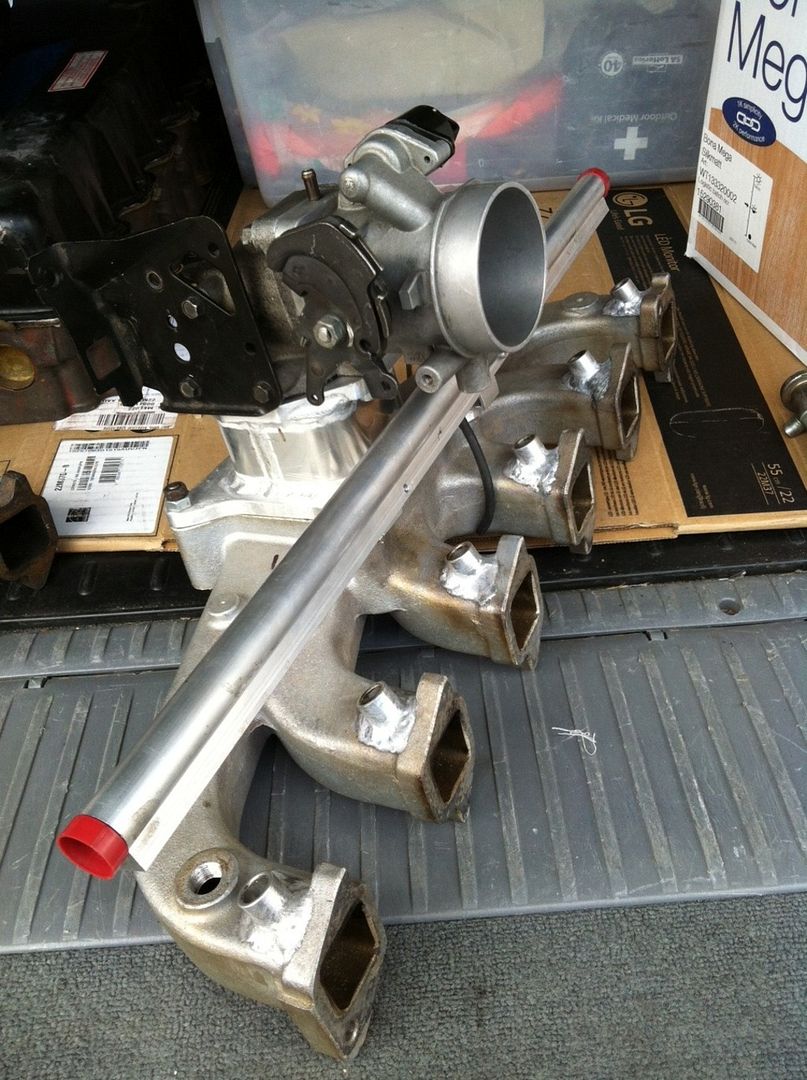

Post by heff0018 »
Picked up the manifold today. Should do the job ok
Posts: 10435
Re: 265 Hemi to efi
looks good to me! got a few tabs welded on to hold the rail too ?
heff0018
Posts: 1061
Joined: Tue Apr 21, 2015 3:42 am
Re: 265 Hemi to efi
Post by heff0018 »
Yeah there is two off the flange but you cant see them because of the angle of the pic. I am going to add another one at each end for good measure which will attach to the manifold studs. Cheers
