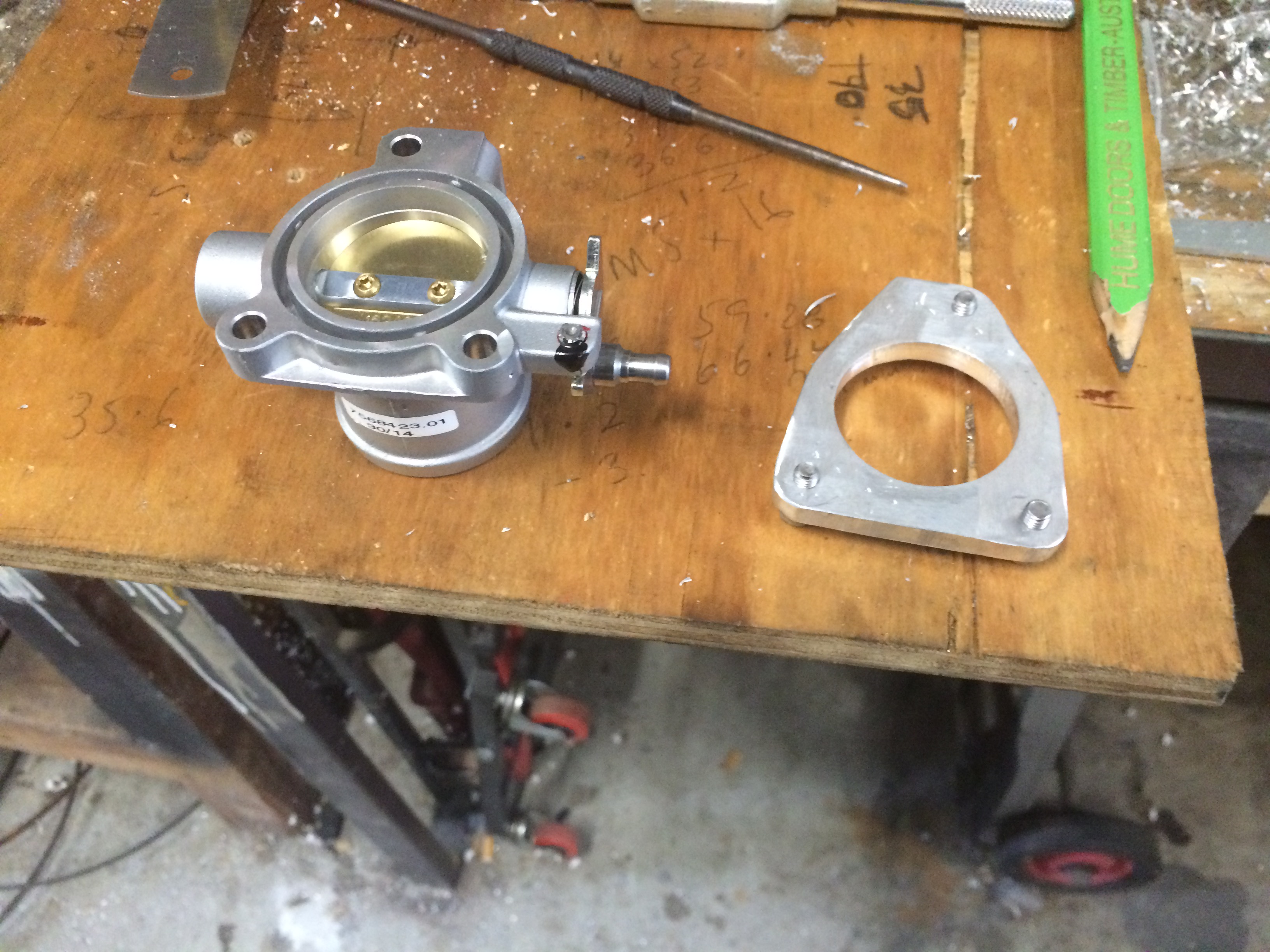

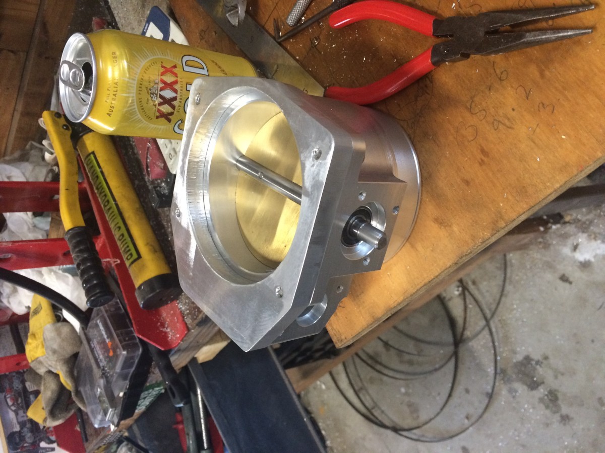

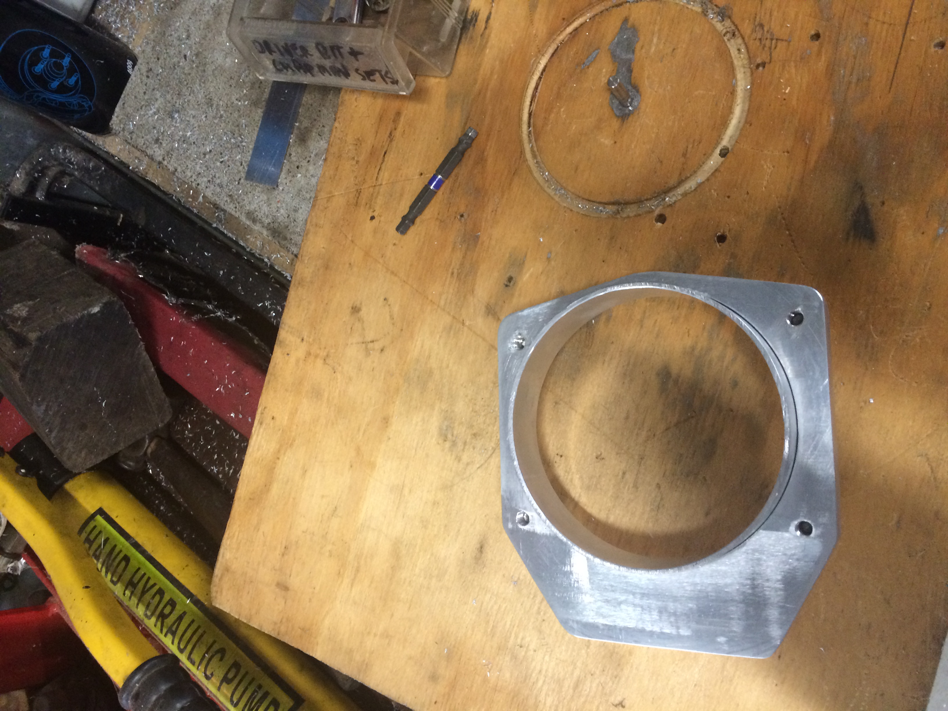

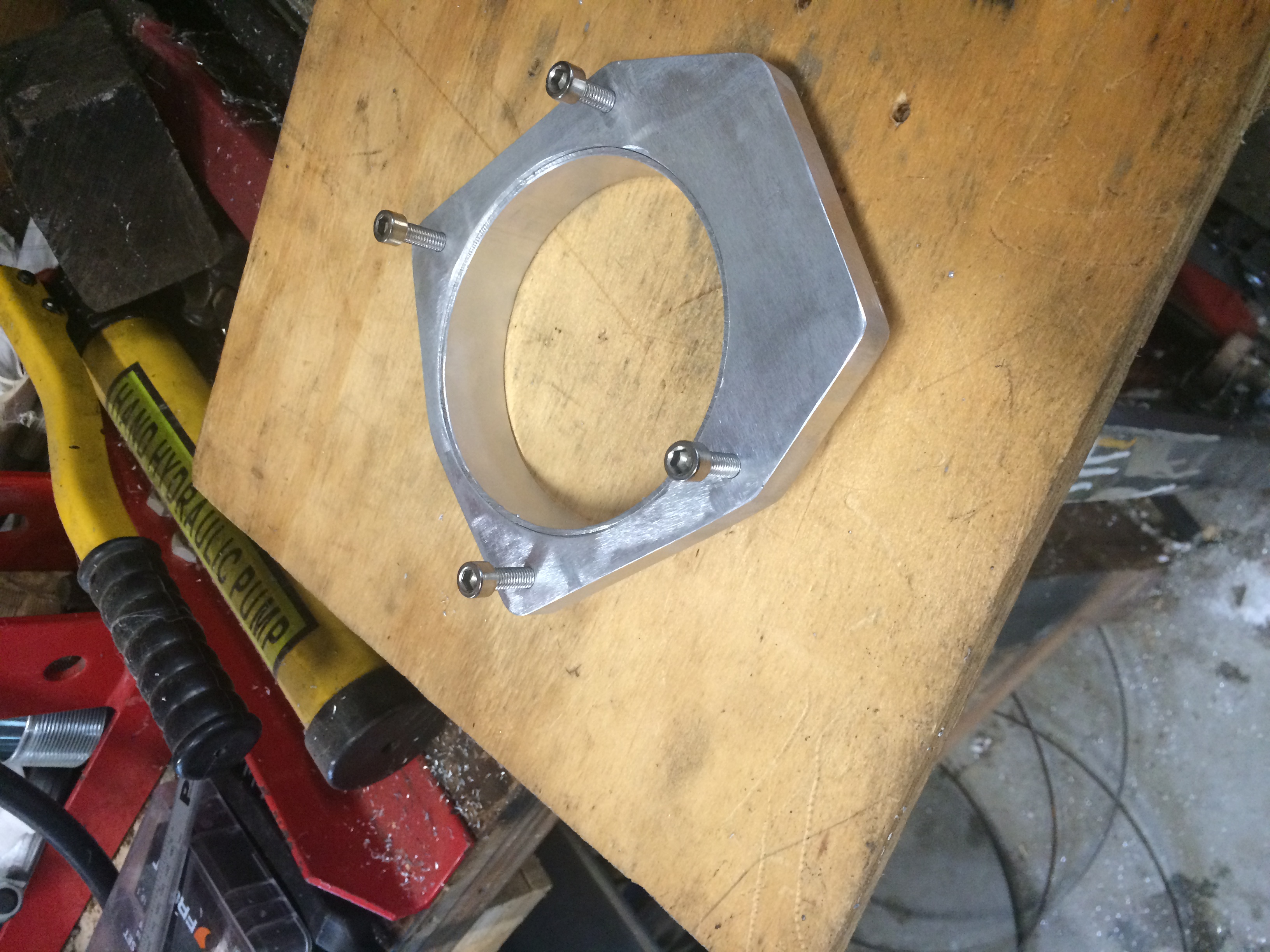

I've started knocking up some flanges and modifying the manifold. I've dropped some pictures for those who may be interested-
Home manifold resurface- Various flanges-
