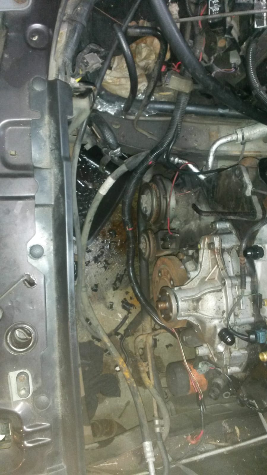

A little progress today, ripped out the old radiator and started fitting the thermofan on the new one. Top mounting bolts are easy but the lowers are about 15mm off where they ideally need to be. Not sure yet how I'm going to solve that one but most likely I'm going to have to carefully cut out the lower edge and then put a thin alloy sheet to make up the gap to the lower piece.

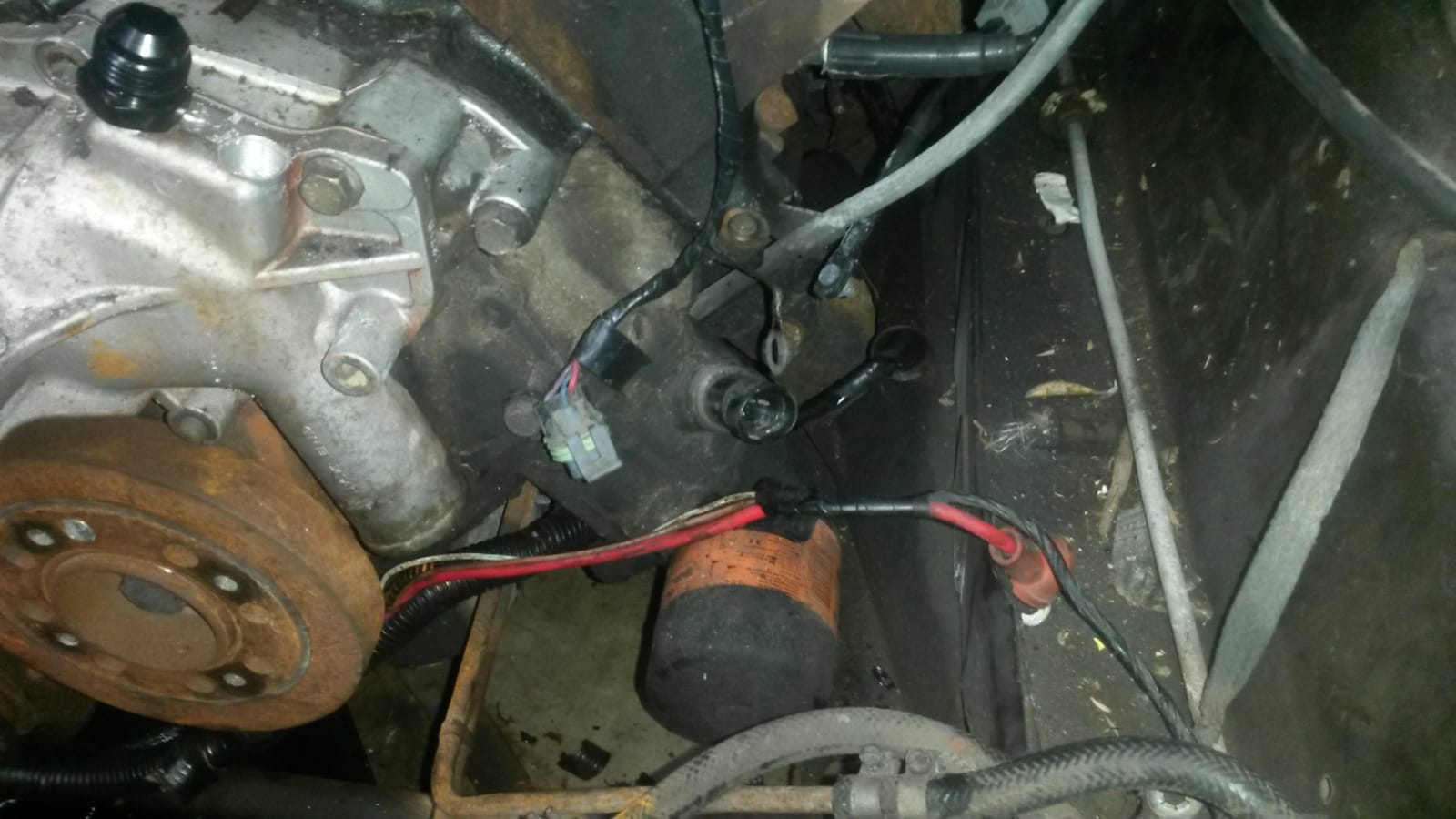

Removed the alternator and started stripping back the wiring loom for the alternator and starter. That end shouldn't be to bad to sort, I'll run the loom under the trans cooler lines and oil pump and just cable tie in place, on the other side the loom will sit behind the AC pump bracket so really it should be well clear of the balancer. The biggest headache is remounting the main earth cable which used to be on the PS pump bracket. There is a threaded boss on the side of the block, just behind the PS pump that may be a good substitute location. Will need to remove the PS pump again to sort that.

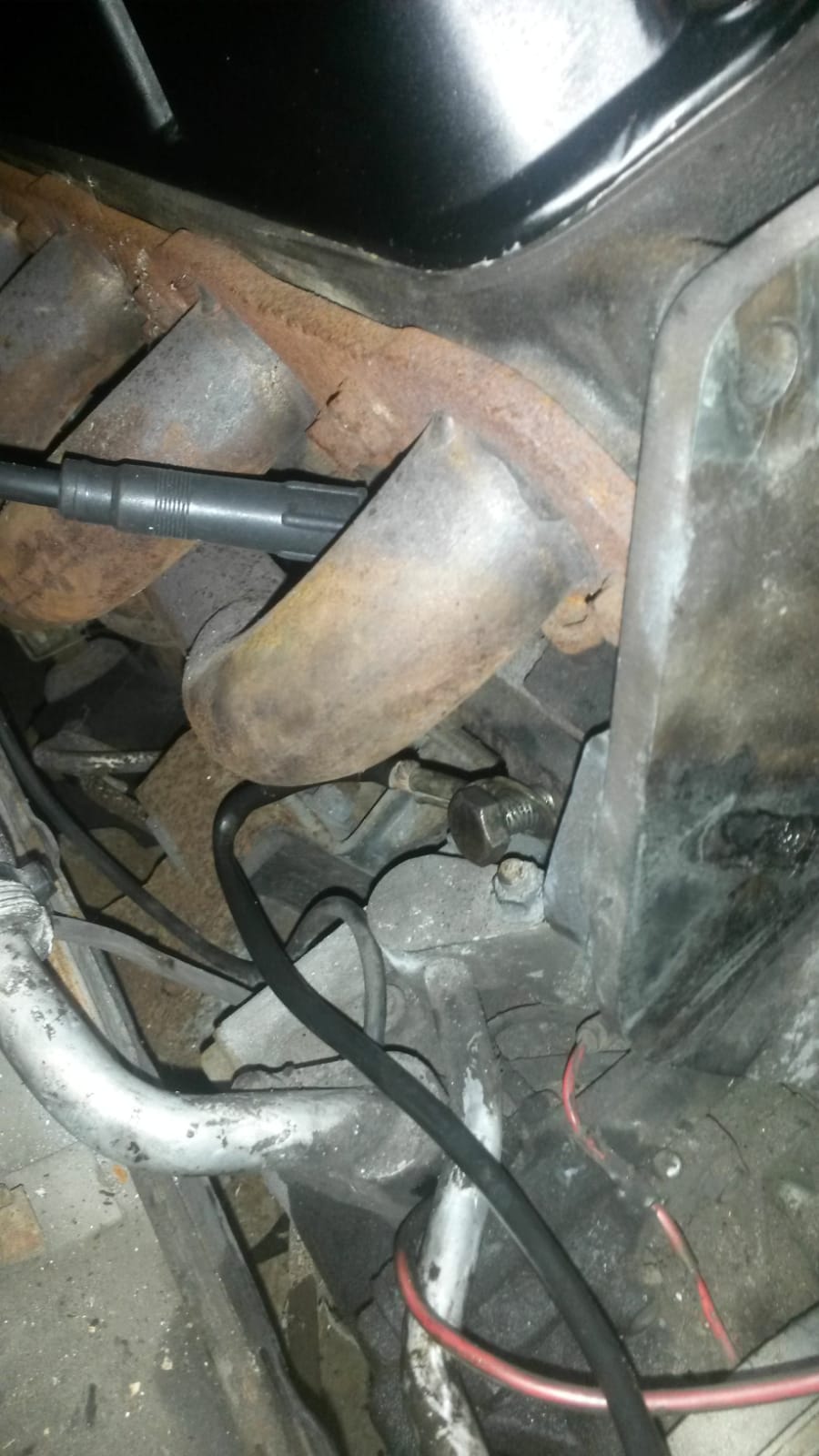

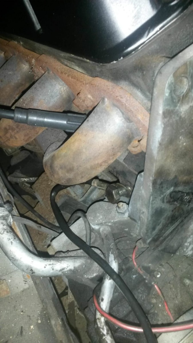

Spent a bit more time on it this evening. Pulled the PS pump out again, than carefully unwrapped the loom trying not to damage the convoluded split tubing and pulled the main earth cable out.
And I think this will be it's new home. I think I will add some heat sleaving on the cable as it is a little close to the headers.
Before final fitment I'll chase the thread, clean the block and use some heavy duty lock washers to ensure a good earth.

Run the earth under the aircon pum and up the side, this way the aircon will act sort of like a heat shield and then also make the cabling look neater.

Yeah, that's basically the plan, the main loom will dive under the AC pump and the earth will run up to the earth point. I was just unwrapping and laying out loosly for starters :)
edit: One thing that is bugging me is the size of the cables. I've upgraded the alternator to the VT 120amp unit but in all reality I don't think the cables are big enough for the original 85amp one.
