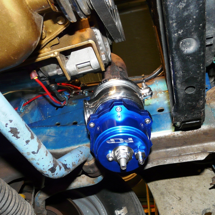

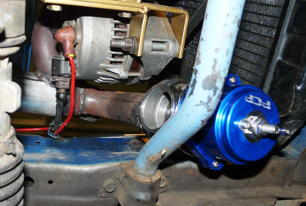

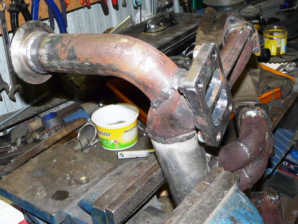

also got stuck into some wastegate piping and the wastegate is now done :)
this was the best option i could see for mounting it, pretty tight but she clears everything and the outlet from the manifold is almost straight in the direction of the flow of air so im happy with that!
next task will be working on the inlet piping and BOV!

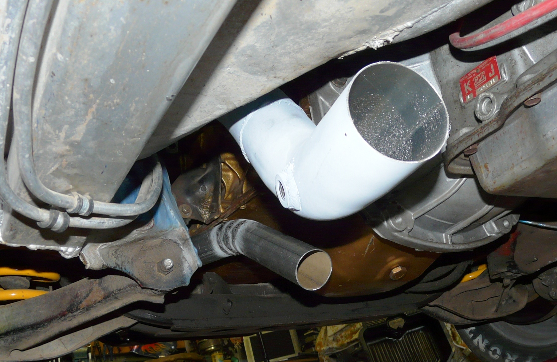

well with the wastegate dump i am going to "see how it goes" cause a few cars i've seen at the drags sounded like shit when they came on :P i'm figuring i'll run it how it is now with no mufflers etc and if i get pinged for noise then i'll worry about muffler etc .... might put it in later see how it goes, don't want to piss off the neighbours either!

we run straight out a 3" pipe under a meter long its not that loud

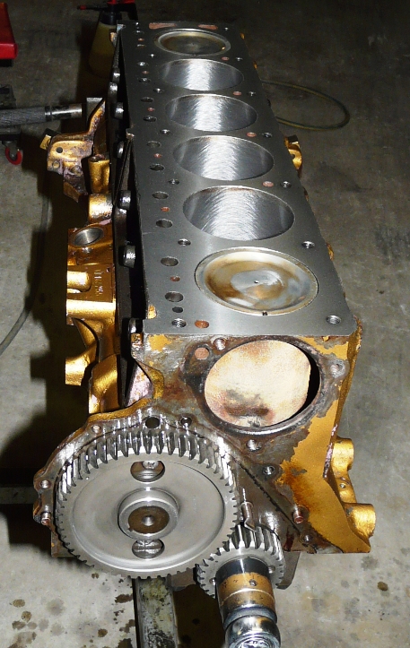

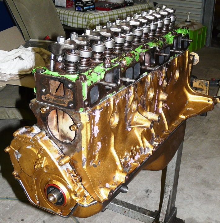

well in latest news, got the bottom end together, pistons are less than .0015 thou sticking out of the block (thats the smallest feeler gauge i have hehehe) it could have been a bit more but it will be fine like it is!
just got to CC the head again to see what it comes up to, i'm not going to deck more off it, but just want to measure everything to know what the comp figure is.

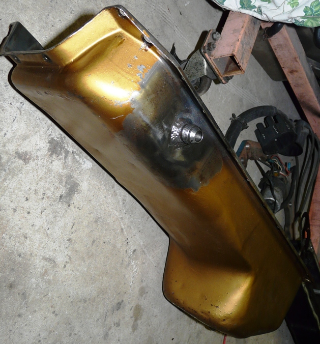

also got the oil drain fitting welded into the sump!
hopefully the rest of the motor will go together tomorrow night.

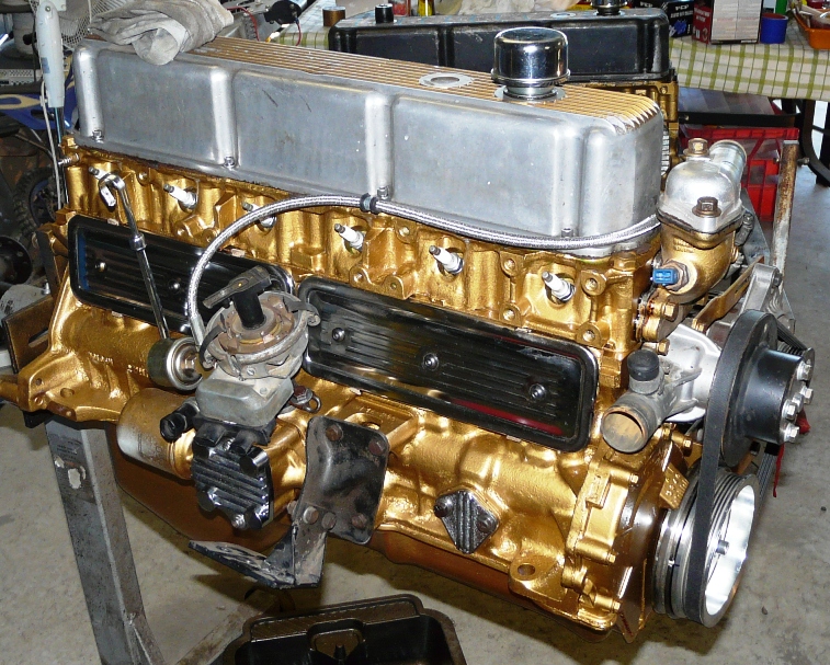

also got a k&n air filter thats a little stumpy one that will fit in the small space i have, aswell as got silicon hoses and clamps on the way and today i got some pipe for the inlet, so its all starting the take shape, think all i'm going to need extra will be some paint, oil etc and i'll be good to go, so aside from any major disasters she should be good for gunnedah in november!
Re: My Delcoed Rides

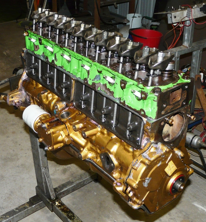

well last night has seen the head go on, and rockers are all on and tappet clearances set. oil pump and timing cover on so pretty close to being finished. I need to scab a few bits off the motor thats currently in the gemini so there wont be alot more progress till i remove it and get those bits.
hopefully the motor will be coming out this arvo .... also need to paint this motor .... so over looking at that bright green!

Ok so the motor is finished and got it installed back in the car

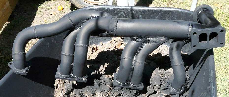

also been cleaning up and painting turbo manifolds, the dump pipe and the screamer also look the same as this :)
i've been working on re-locating some wires and fuel lines too out of heats way, so hopefully in the next few days will be able to show yas some pics of turbo being bolted on!!
