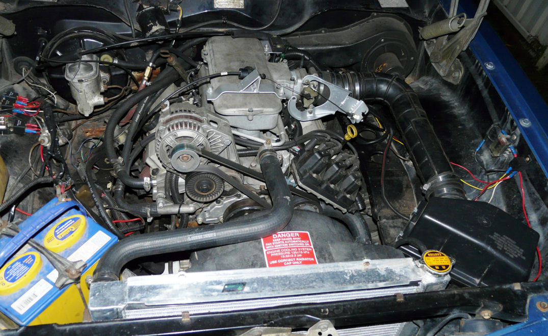

as it turns out i could have done this conversion in a normal weekend :) which is good, means i can tune tomorrow!!
went for a drive just a while ago to get some more fuel and she goes pretty good :driving:
so ended up getting a new water pump and thats sorted all the water leaks ... all in all its good!!

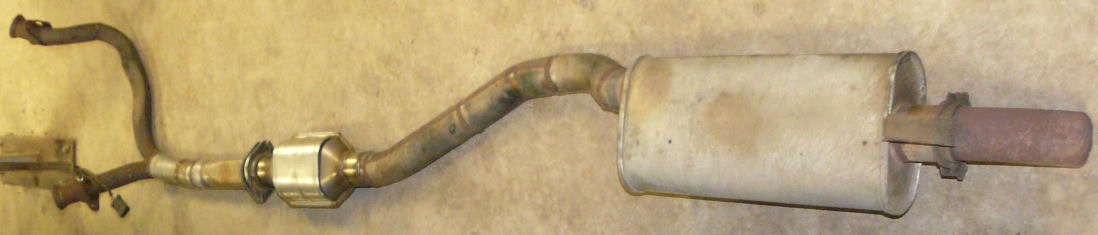

got me exhaust all sorted .... from the cat back is what i used to have on the 202 ... need to extend it over the diff and out the back but it will do to get me to work ... i mean its been like that for years hahahah
looks like the new seal in the back of the gearbox is leaking so im pissed about that ... not really sure what the deal is there but thats the only problem so really im pretty fucking stoked!!
ok as far as the BLCD tune on an ecotec .... its got a few minor issues, IAC seems to have some issues, like at the servo it stalled when i started it, then i restarted it and it just ran till the IAC came up a bit .... not sure if thats IAC settings or AFR as i know its rich at idle ....
as far as the spark went its pretty bloody good .... i pulled up and did a 0-100 test and i THINK it pinged a bit but bugger all - this is also on 98 fuel so it will probably ping cronically on 91 but thats something i can work on ... i plan to run a switch for two tunes anyways so yeah should be all good :)
i'm sorry to inform those that were interested that at the moment i don't have a log off it from the road as the laptop decided to be fucked and the gauges were all jumping around so i didn't bother with it ... will work it out tomorrow
well im going to go and fall in a heap!!! :wtf:

well finally after trying to find places to make me an inlet pipe and checking ebay and all sorts of stuff like that i've worked out an inlet setup that seems to be working!
it consists of a vn/vp/vr inlet pipe which has been shortened about 2 inches, then there is an adaptor to flare the pipe out about 5mm to suit the TB size - not perfect but it will do me!!
also been doing some km's and getting some fuel econ figures ... so far this last tank is looking to be 10.5ish L/100km.
i've been fiddling with timing and it looks like less is more in this engines case, i've removed a few degrees across the board and it seems to drive with less throttle and generally be better on fuel so i'm probably going to take a touch more timing out soon and see how that effects things ....
next on the list is fitting the charcoal canister and sealing the tank to feed its breathers into the charcoal canister ... so thats probably going to be part of this weekends mission ... remove the fuel tank and see what im up against!
