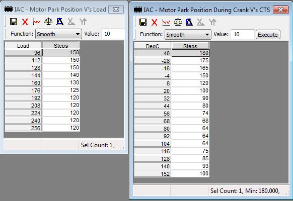

These are the only ones I can find.
Are they too high considering our idle steps are now around the 20 mark?
These tables haven't been changed since I changed the throttle screw to get the steps down as advised, but I did ask in the very first post.

Re: Idle & Off Throttle Hang - Sometimes
the crank table i would say will only do anything when you are starting the engine ..... the other one.... im not sure what nornal load you would be seeing when your having the issues .... i guess you could always try and decrease the table and see what it does.

Thanks. I guessed it wasn't any problem because nobody said we had to drop the IAC settings. But we know the problem we have to fix before looking at any tables etc. Good old DTC49. :study:
I suppose we'll have to beg, borrow, buy or steal another distributor or OEM hall sensor plate (can't buy that), even if it's purely to test whether or not that is the fault.
Intermittent faults are always such fun, aren't they. :roll:
