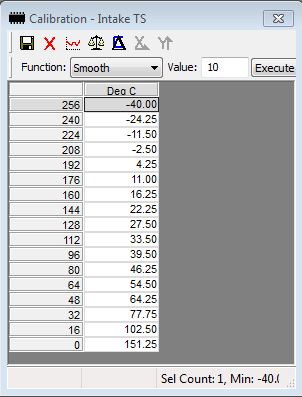

Second question: - What is "Beyond RT area" table?? What is in the left hand column?? versus the Temperature Sensor.

Beyond RT Area - Calibration - Intake TS??
- Posts: 4852
Re: Idle & Off Throttle Hang - Sometimes
that's the Intake Air Temp Sensor calibration, you would only mess with that if your not using a stock sensor, Beyond RT Area means it's beyond the Realtime Upload Area so if your using realtime you will have to reburn the nvram with the settings changed.
