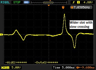

This picture shows the difference in slot/tooth width and what it does to the signal (on an extreme level). The amplitude difference is just that the simulation wheel runout was really bad

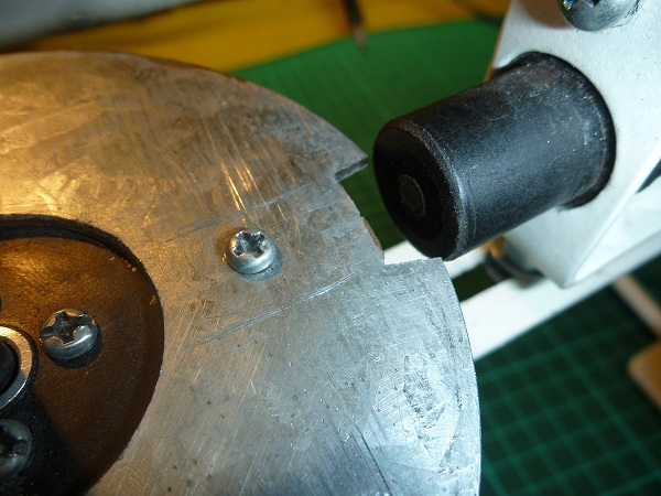

no i haven't, i've just recently put the abs sensor back on the motor with the diodes in place but other than some testing in the shed i haven't used it at all

so now will work on getting the abs sensor on the balancer working then it will be another step closer!

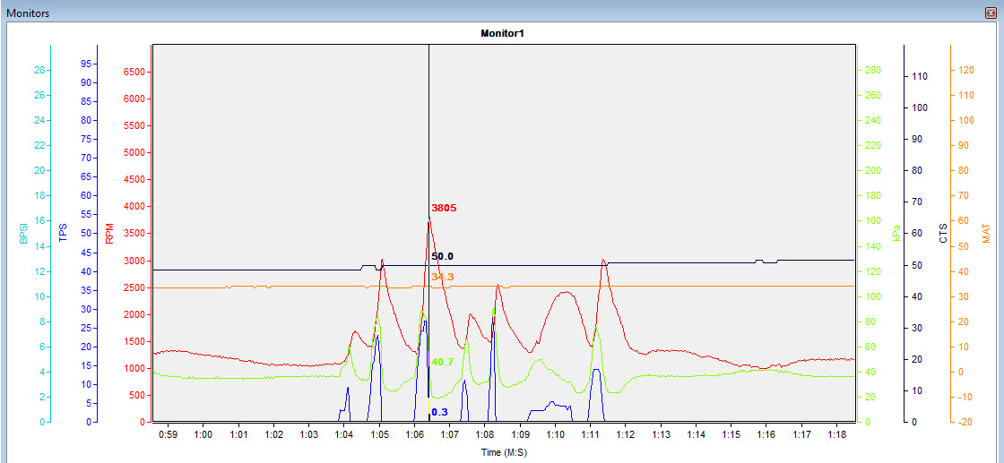

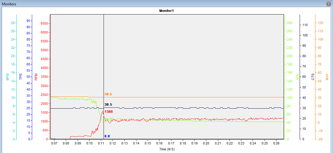

got the abs sensor working with this last night too.
got a log of the two one after the other to show the difference, even at low revs where the dizzy trace is alot smoother its still nowhere near the smoothness of the abs sensor!

What an improvement! Thats really working out well
