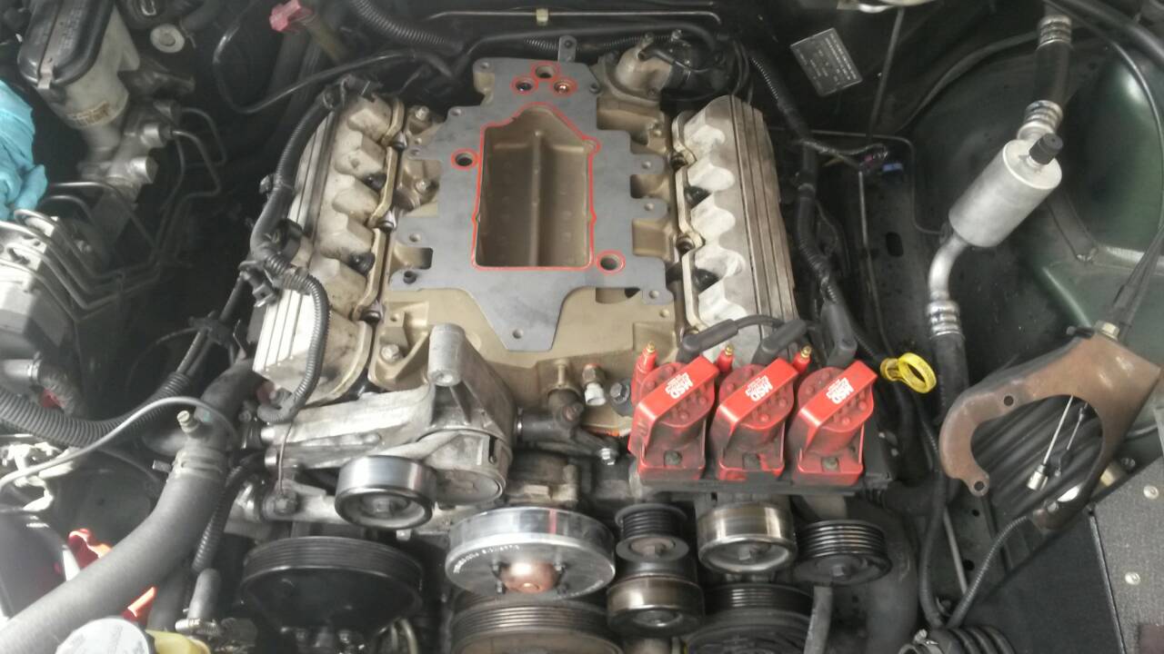

I've scrapped down the intake gasket faces, chased all the threads with a tap and have left it to soak in WD40 overnight.
Tomorrow I'll give it a final clean and then fit this with a new set of alloy intake gaskets and new 82°C thermostat,

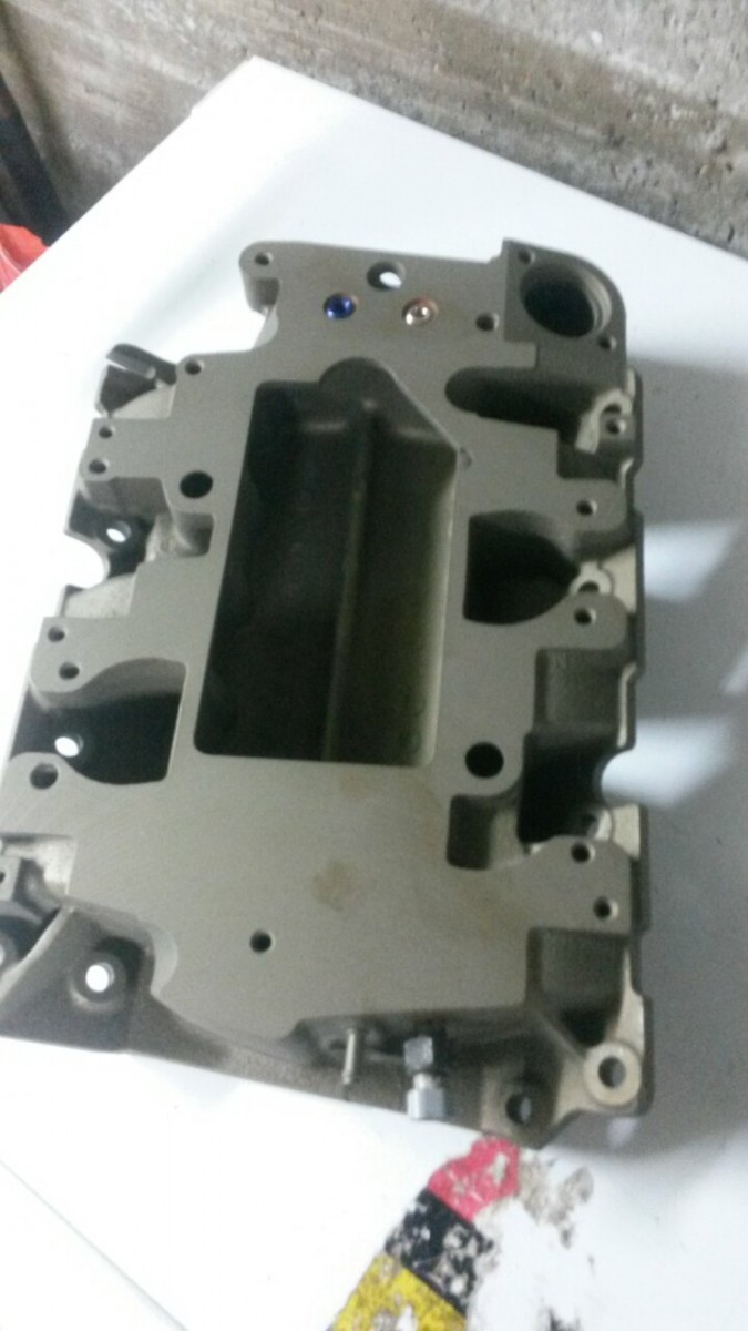

gee that came up well immo
the coating on the rotors (teflon) should be grey in colour. obviously its black due to PCV recirc and other blow by / etc engine gasses

LOL. I cheated. I had that LIM prepared earlier.....

whats the deal with the plugs in the LIM at the back ? is that to stop it bypassing or something ?

Holden202T wrote:whats the deal with the plugs in the LIM at the back ? is that to stop it bypassing or something ?
Blocks the TB heating loop which I'm sure aussie L67 don't even have, so its good to plug them instead of relying on the crappy SC gasket to seal them.
oh right so thats a US LIM
- Posts: 8549
They are global, same here and there. Only thing they have in addition to the L67 is the succeeding L32 engine which has a slightly different LIM to the L67.Holden202T wrote:oh right so thats a US LIM
Out SC is a little different though, theirs has the TB bolted straight on and goes straight (ie. through our firewall) and had the heated TB.

Yeah, as Vlad mentioned it's for heating of the TB. Something we don't have. It means I can now lift off the blower without effecting the cooling system. I plan to add some other mods but first want to get some baseline data for how it sits now and then record changes in boost and AIT's with the various mods.Holden202T wrote:whats the deal with the plugs in the LIM at the back ? is that to stop it bypassing or something ?
So this is how it sits currently, Basically ready to bolt the blower back on top. All the LIM bolts were cleaned and have a good coating of sealant. Manifold torqued down in 3 stages to 15Nm. All going well that sucker will be good for the rest of it's service life.
I tested the new thermostat in some hot water (as I don't want the hassle of pulling that apart again if the bloody thing doesn't work) and also drilled a 1mm hole in it to help bleed the air out on initial startup cause with the rubber seal around the thermostat it will otherwise trap air until it opens
Missus is complaining (like they always do) that it's taking to long. Seeing as the blower has to come off again and I haven't picked up the bearings yet for the snout considering putting it back as is and do the blower overhaul when I fit the 25mm LIM spacer in the near future. But now it's lunch time.
I've taken some measurements of the old O rings and re-used em. They don't look that bad, used a little lubrication to put em all back. I'll take the measurements and figure out what the right O rings are. Once I'm certain I'll post up some sizes.
Looking at the intake gaskets and a few other things I've seen I have to wonder if it's been apart before? The LIM bolts seemed to be loose? The blower bolts too seemed to be loose and it looks like one of the O rings has a light smear of sealant on it.....
