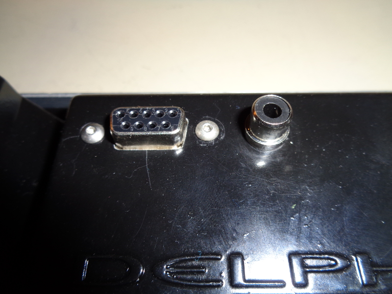

So far the BDM NT has worked flawlessly for me with the 0411 (no luck with any of my P59's, not yet anyway). I even did a hardwired header on a 0411 I have here. I put the port in a place so the leads are really short. I've learned (the hard way) it really makes a difference. Here is a couple of pictures of where I put the port. It's just above the pads on the mainboard where the BDM header is soldered. Sorry the pictures are not very good. I think it has a lot to do with the black paint I put on the 0411 aluminum housing:
I made a really short header cable to plug the BDM device into. The total lead length on the wires from main board to 2x5 BDM plug is less than 6 inches (152mm):

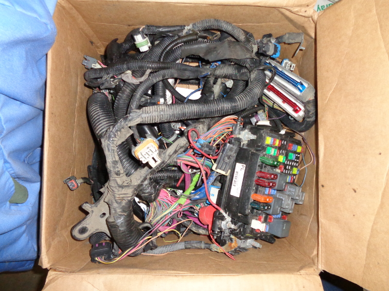

And one final shot of an amazing deal I just got delivered to my door. A 2002 Silverado 6.0L engine wiring harness I got off Ebay. $50 delivered. I think I got it for a lot less than most people are paying. It will be my test harness for the engine run stand I'm building. I originally was going to make a kind of bench engine wiring harness for testing, but I thought... screw that! I'll build a run stand and test my harnesses and cut my teeth at basic tuning on the 0411 in the comfort of my own garage. Of course there is no real tuning unless your engine is actually in a vehicle. But at least I can get everything to start, idle, and make sure the transmission is shifting before I shoehorn this Big Block Chevy into the 48 GMC:
