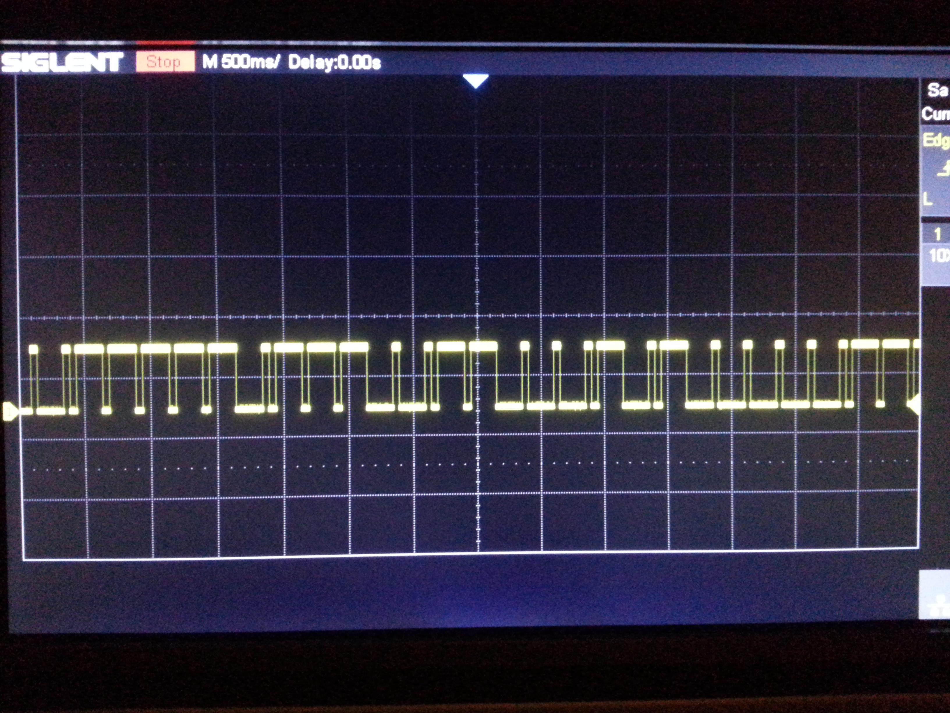

So I finally fingered out how to use my Christmas gift from all the little ones, thought I would post the results ...
ArduStim GM_LS1_CRANK_AND_CAM crankshaft sensor signal ... Looks right to me. The Oscilloscope is the one mentioned in post 2.

sweet gift!
Re: Bench top Engine Simulator for the P01/P59 Pcm
Kinda looked like SOS at first glance with short and long dashes haha.

Thanks,
I realized after I posted that, it does have two channels and two probes I could of included the CMP sensor ... O-wells, live and learn.
(Haven't even opened the second probe yet)
Hope it works out, extremely paranoid purchasing anything these days with engineered lifespans and all, I like to buy tools once and take care of them.
