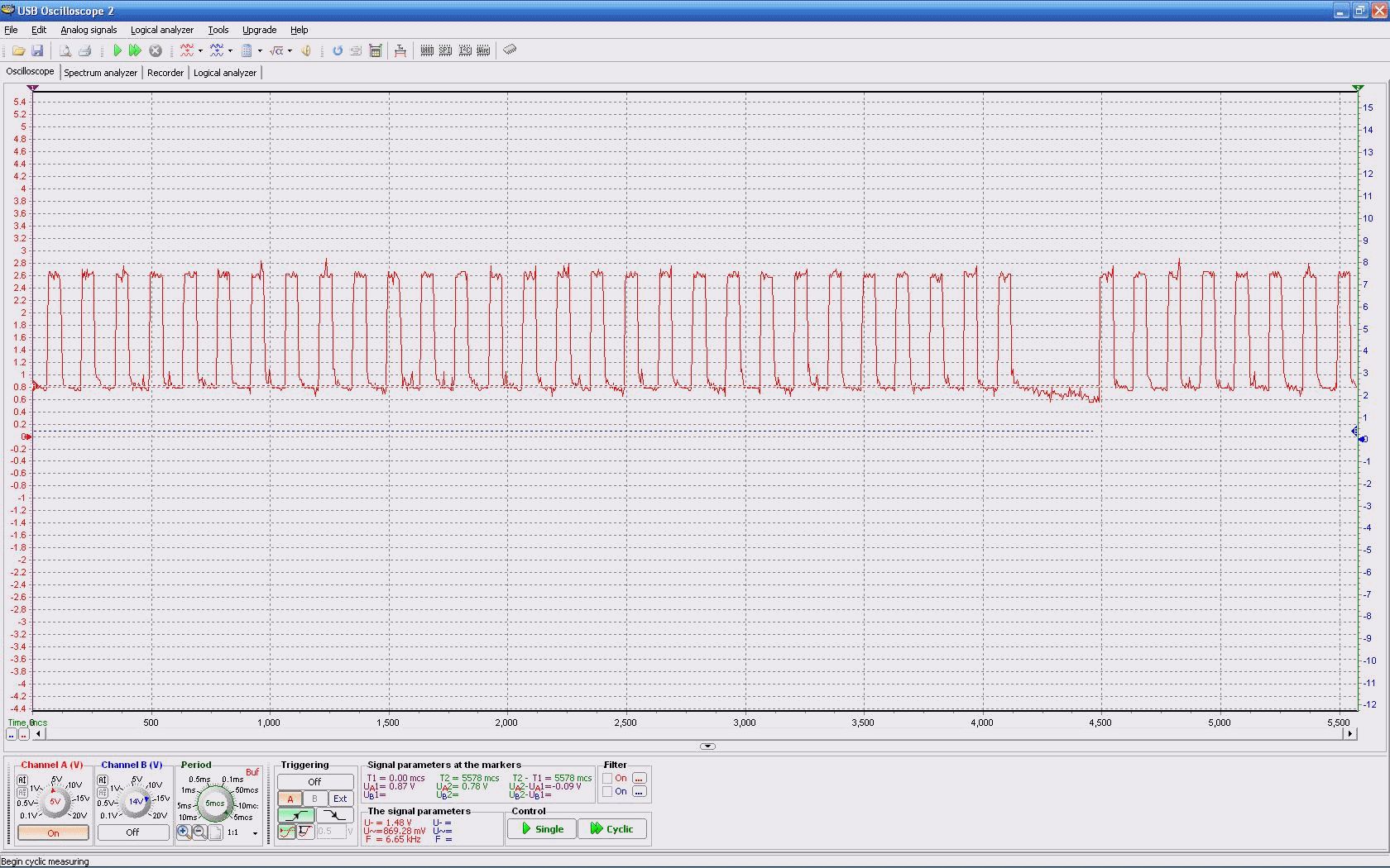

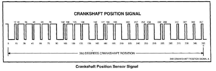

Here is the 24x signal structure. Degrees of crankshaft rotation marked in the picture
I'm not so sure the 24x signal is 5v. The notes I have say it's 12v. They also say the sensor includes a pull-up resistor (so the sensor drives the signal both high and low). That could be wrong.
Also attached is the "60-2" signal (ie 58 pulse as you put it). Its a pretty simple 60 pulse signal with 2 "missing teeth" so the full signal isn't shown.
