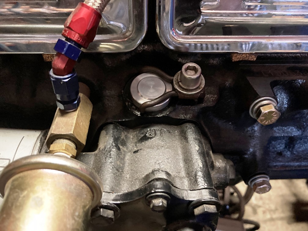

When i converted the 202 to 36 - 1 CAS and 6 x LS coils i made a steel bung for the dizzy hole, and by all reports its done a perfect job...... but since i have my own lathe and a lump of alloy rod i had to make a lighter more shiny version

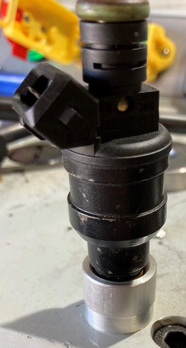

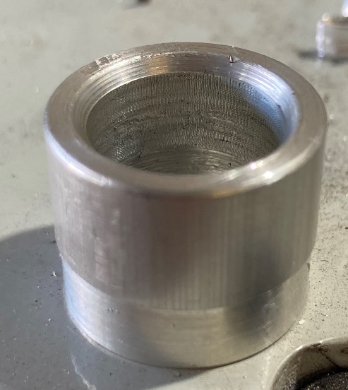

I also took the opportunity to try and make an injector weld in bung .... im pretty happy with it, other than i need to get something to linish the inside of it, its pretty rough, maybe the oring would conform to the finish but i dont know, i think as well the next one will be with different speed settings to hopefully get a nicer finish.

Probably best to ream the injector hole to size as it should be a lot smoother. Looking good though.
Re: My First Lathe!
Have a play with your boring bar position and feeds and speeds, should be able to get a lot nicer finish than that. With a little o-ring crush there's no need to go overboard with the surface quality (unless you're planning on huge amounts of boost!). I've had good results installing injector bungs using epoxy (cold weld), saves warping things with welding.

will do thanks!VK_3800 wrote:Have a play with your boring bar position and feeds and speeds, should be able to get a lot nicer finish than that. With a little o-ring crush there's no need to go overboard with the surface quality (unless you're planning on huge amounts of boost!). I've had good results installing injector bungs using epoxy (cold weld), saves warping things with welding.

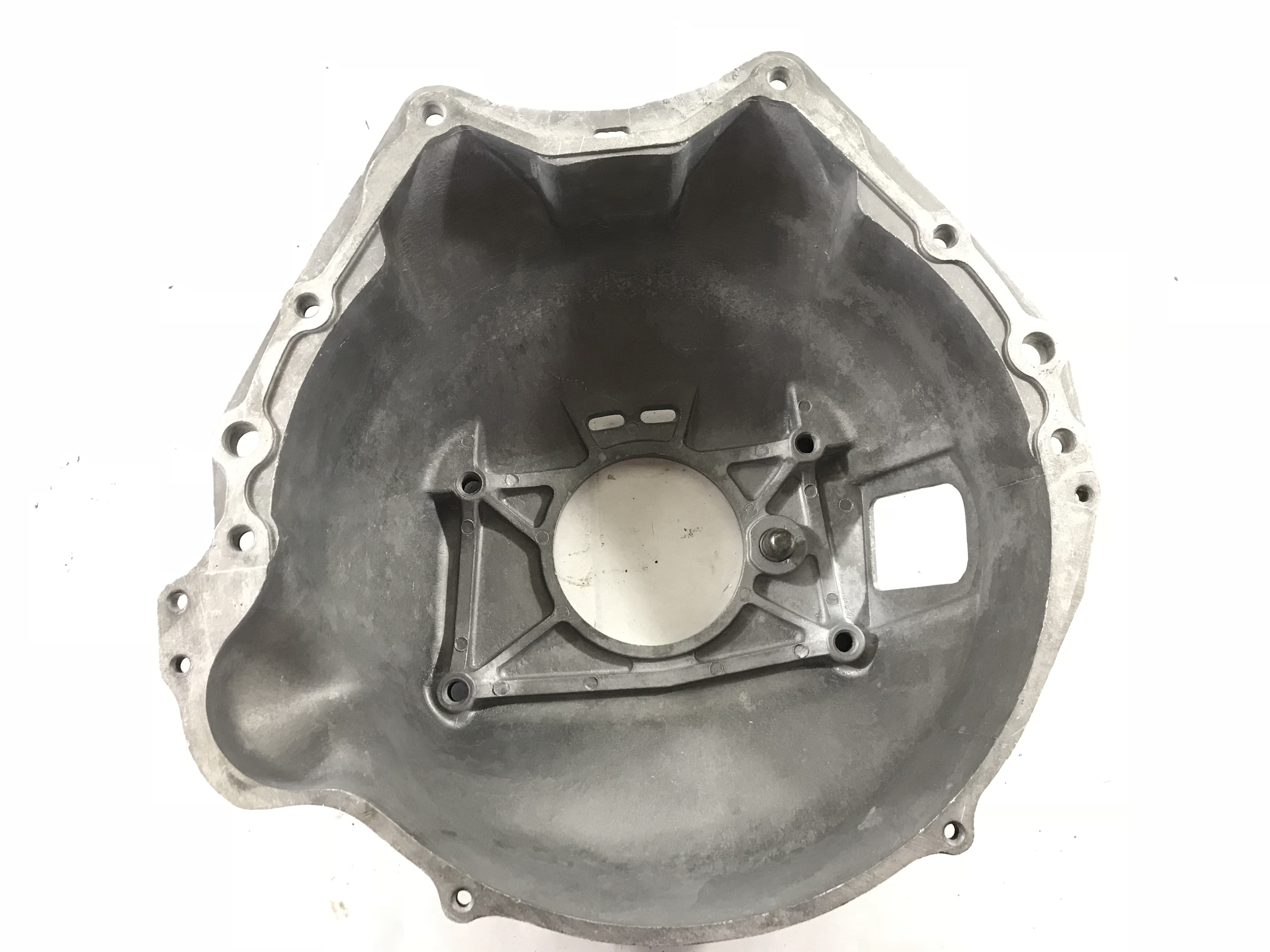

What's the plans for this motor? What's the bellhousing pattern like on it?
Re: My First Lathe!
i dunno man, would like to put it in something one day for a weekend cruiser or something .... it has a T350 with it.
googled and found this ...
