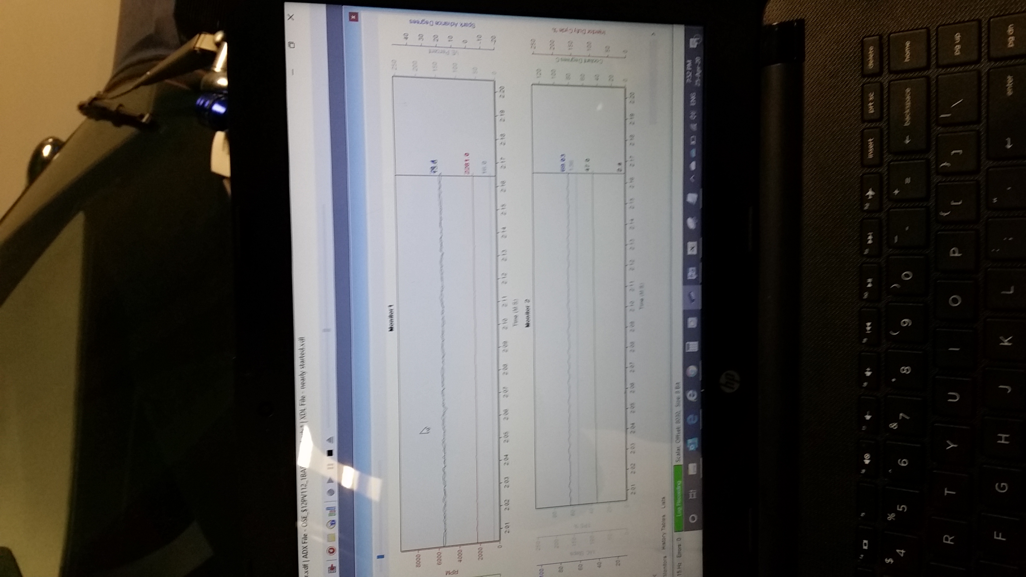

I finished rewiring the reluctor using shielded wire, shoeld grounded to the chassis. Ran a few test cranks with the plugs out, it didn't look too bad, only a could of spikes when the coil was connected. (I forgot to put the protective cover over the reluctor in the distributor).
Used toming light to check that I had the polarity correct.
Wiped the NVRAM and loaded a known good BIN onto it.
Brake cleaner and paper towel on the spark plugs.
Started first kick and then died.
Then it started just like it always had.
No RPM spikes noticed in a few minutes of running.
I did previously do a test start with a reprogrammed Memcal with the good cal on it, with no luck.
Corrupted NVRAM may have been the problem, so may the reluctor.
