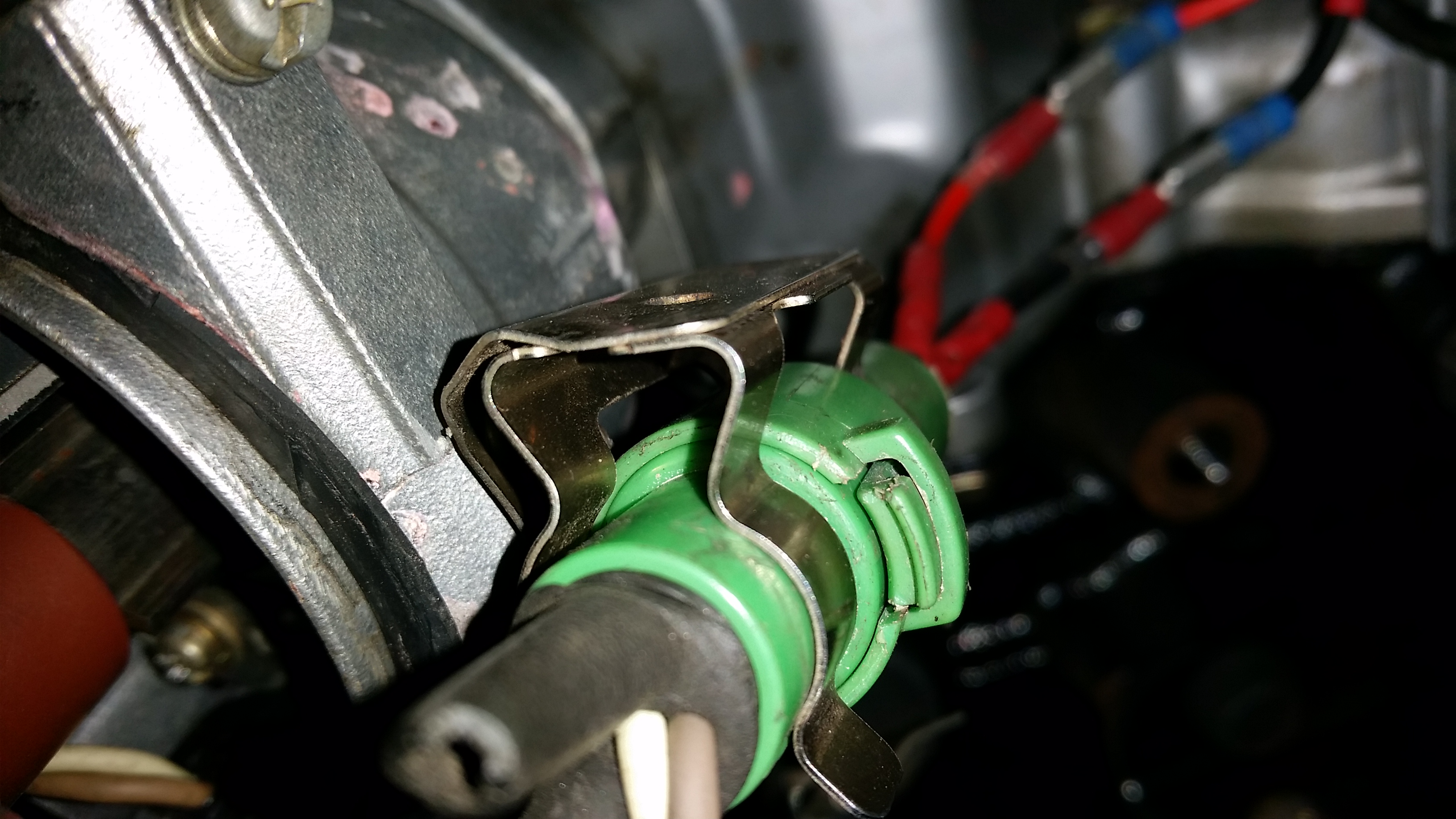

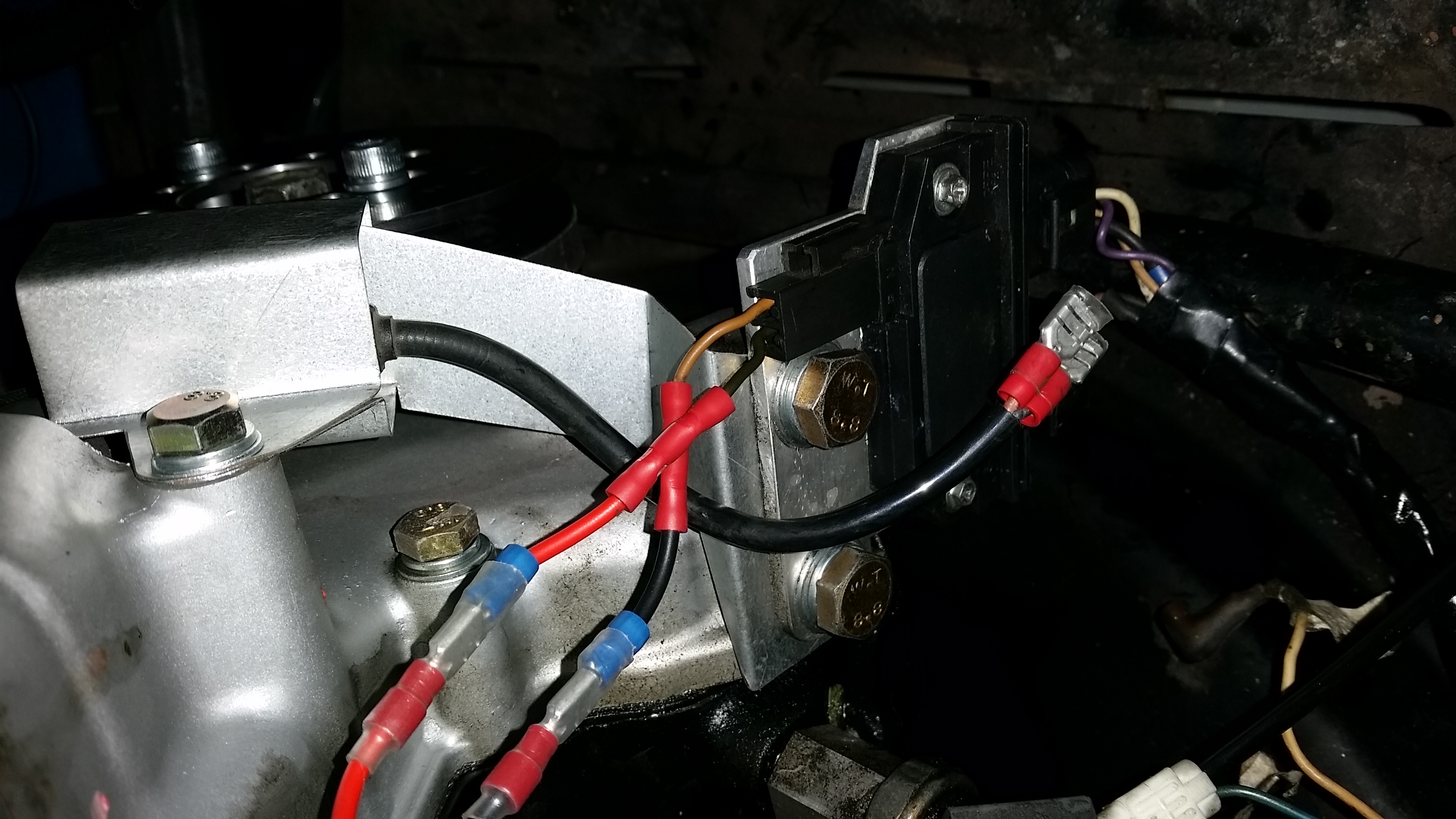

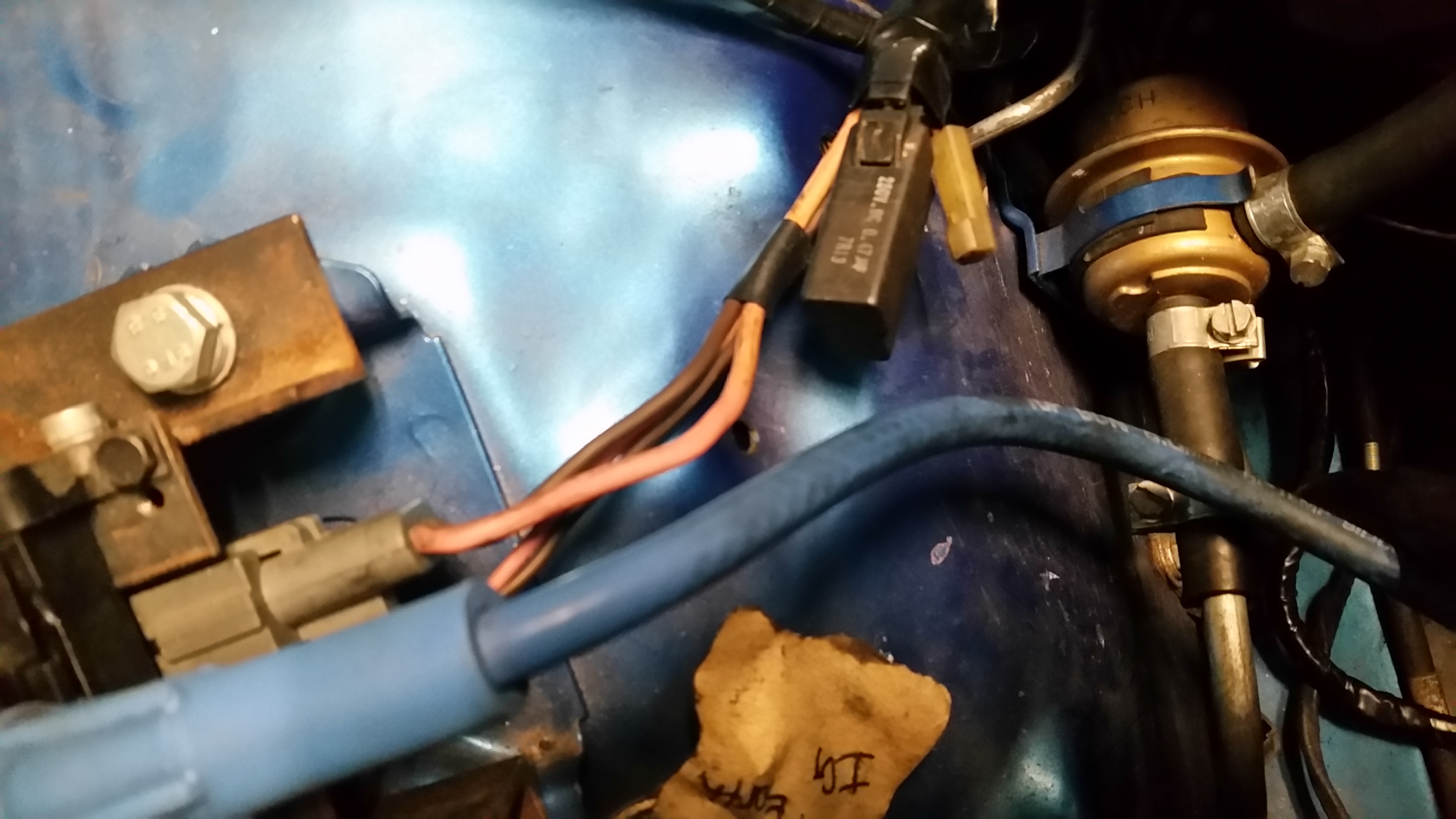

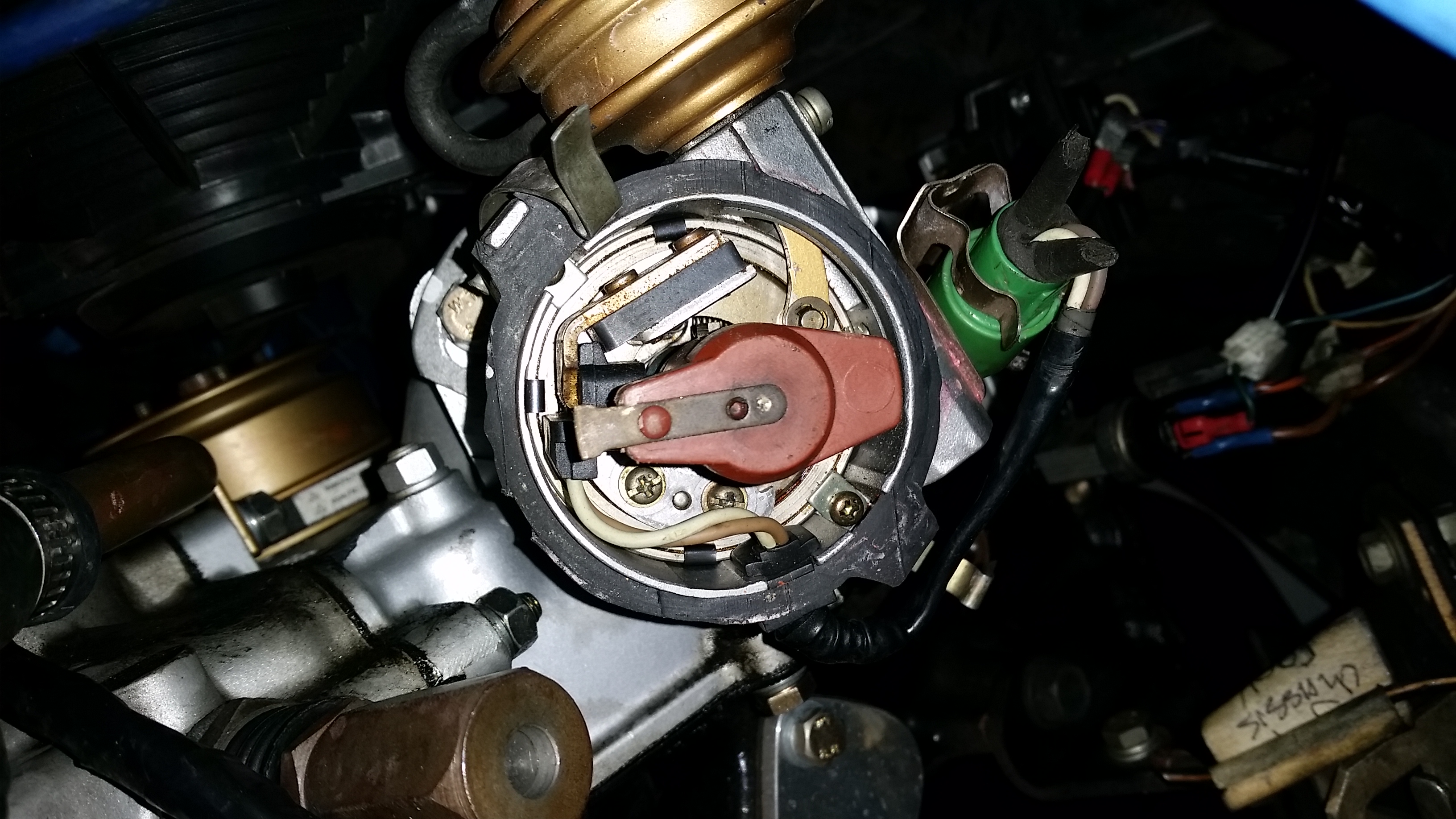

Sorry about the images being rotated 90degrees. I don't know why my phone did that.
The ABS sensor wire is short and goes directly to the Ignition module (disconnected in pics).
Would having numerous connectors between the pickup and the ignitor cause problems?
I am aware that the disconnected ABS sensor wire is resting next to the ignition module but nothing was working anyway so I don't think that is the problem.

I dont understand where the abs sensor fits in to this picture, i'd expect the sensor in the distributor against the reluctor in to the bosch ignition module, or an abs sensor on a metal wheel with the trigger pattern going in to coilpacks and module. if it worked before I assume its right, but im not clear on that. I agree with Holden202T that it quite likely is high frequency ignition noise from somewhere else. Do you have a wideband heater controller there somewhere? or filtering capacitors on anything that could have died? or a bad ground connection?
or is the abs sensor interchangable with the distributor sensor?
Re: Toyota 18R-G (808, NVRAM, USB) - died, help please
yeah im a bit lost now too, are you saying that the distributor gets unplugged and then you plug the abs sensor wires in its place ?
The ABS sensor is interchangeable with the distributor sensor. It was not there when the problem originally began.
It is triggered by a steel wheel (2 slot or 2 teeth depending on which I bolt on) on the front of the harmonic balancer when it is in use.
I installed it to see if it could be used in place of the distributor sensor, which I don't trust anymore.

At some stage in the past, a kill switch was added into the positive (pink) wire that goes from HEI module (+) to Ignition coil. This switch adds about 2m of unshielded wire into that line.
The ECM has only been seeing 12.4-13volts from battery voltage so I'm wondering if there might be something not right with the alternator or wiring (EA falcon alternator (3 years old).
Which wires should be shielded in the loom?

the sensor wires from the trigger system to the ignition module should be shielded. the battery volts sound fine. How low do they drop while cranking in the logs? can you post up a log of cranking? the hei kill switch wire might be creating RFI, but if it was there before it doesnt seem like it'd be it.
- Posts: 5709
Yeah needs to be shielded or a twisted pair of wires not just parrellel 2 core
