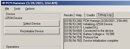

Re: STiC Technology SVCI J2534 Tool
What's going on with battery voltage? 16.6?
- Posts: 2332
No clue, this device has always shown high, looking back in this thread I see 20.6 ... The SparkFun board (STN1110) reports v13.6.
