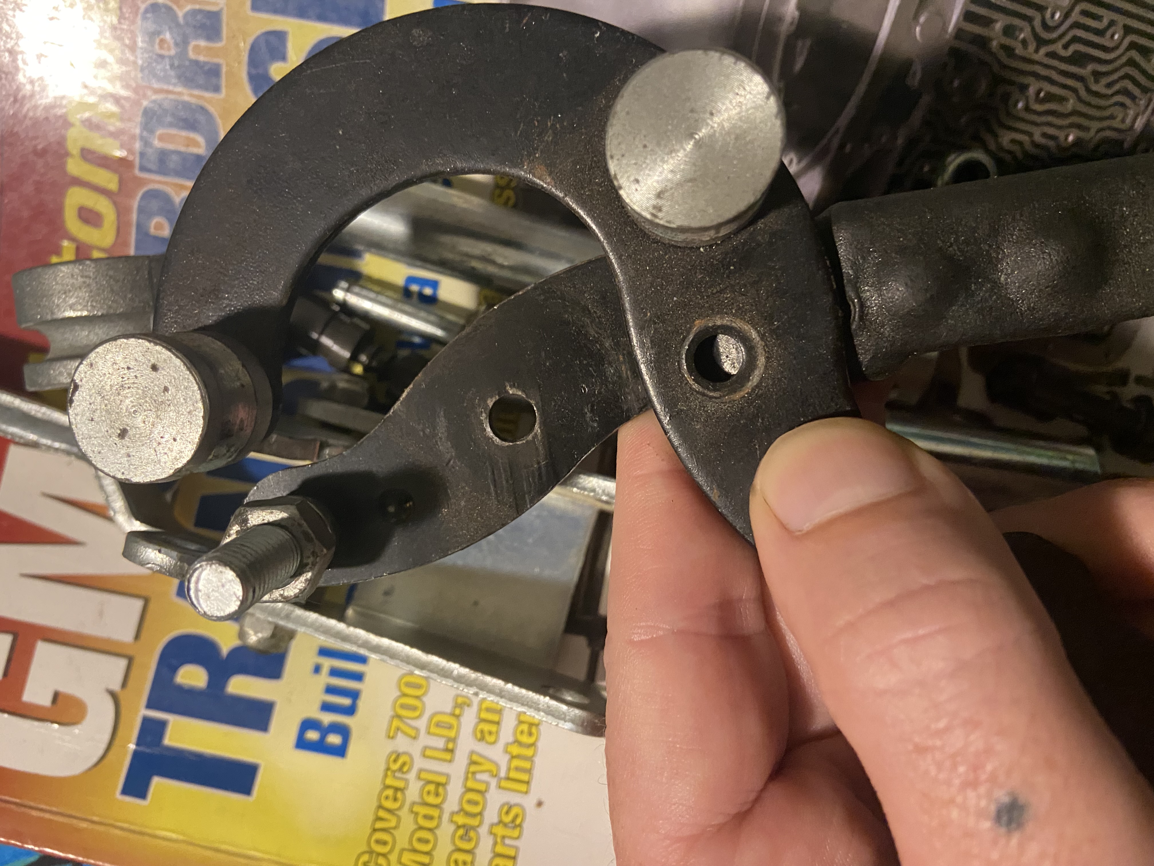

I think something like this could be made to work. Even without a lathe you’d get pretty good results making your own die from putting a normal drill in a vice and hand filing.
Posts: 8548
Re: Beading/bead rolling tool/s for steel lines.
What tool is that one there? Is that yours?
Wade
Posts: 1229
Joined: Sun Jul 10, 2016 8:29 pm
Post by Wade »
That’s just a cheap tube bender that I never use as I’ve got better ones and some valves from a 60e. I got to thinking about making a bead roller myself
Wade
Posts: 1229
Post by Wade »

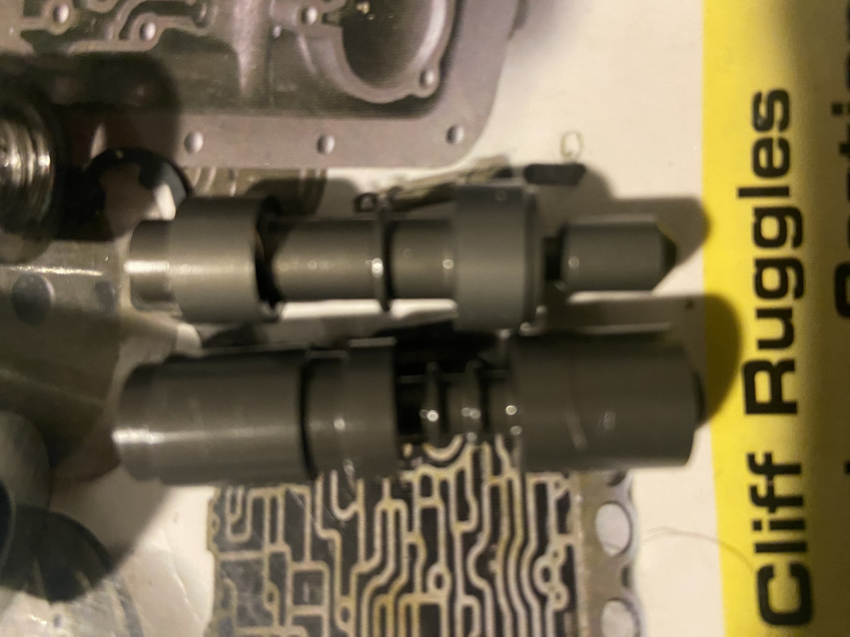

You could make a new handle for the other side out of flat bar. The die that are already on the bender would be pretty close already for the outside die. And those valves are the right sizes for what we need. They’d just need to be ground down. Then I could run pins through the die so they turn and roll ect. Then just weld a nut/bolt on a swivel so you can slow clamp both handles together. It would work in the same way those expensive Parker ones do.
Posts: 8548
But what are those two dark metal things with the collars on them?
Wade
Posts: 1229
Post by Wade »
Valves out of a 4l60e valve body
Posts: 8548
Ah right, they look almost ideal for a DIY tool die.
