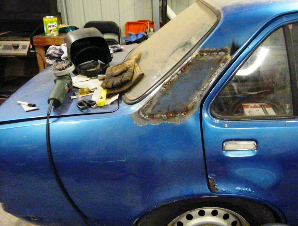

well i have been trying to save my dollars for some bits i need for the gemini, so i started looking for things to do that don't cost me money and i found this!
so as i have the fuel cell in the boot i didn't need a fuel filler hole... and while i could have left the original little flap on it i thought if i welded a plate over it that might make it look a little neater.....
so after some template making i got stuck into an old piece of Torana bonnet that was cut out for the hole in the A9X scoop, and made this piece and got to welding it in.
the main thing with welding car panels is to try and avoid getting it too hot as it will warp panels very easily.... i was mostly successful with this, you can see in the below picture at the bottom of the new panel there is a slight warp .... bit annoyed but it also shouldn't be too hard to fix i hope!
so next step will be to grind all the welds smooth and see how it came up! then i will be doing the same thing on the other side.

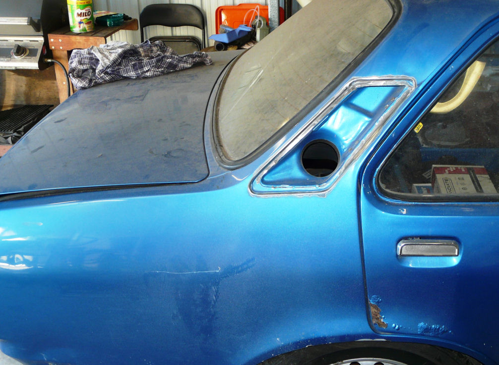

How did you fix that warp /dent below the weld .
Whats the trick HOLDEN 202 ? It came up good .
Re: My Delcoed Rides
mainly used a plank of wood up in the rear quarter to lever the panel out and at the same time used a hammer to hit the areas around it to get it to stay out, then once it was close i used a dolly in place of the wood and the hammer to get it as good as i could, its not perfect but it is pretty close .... took a while though!!
