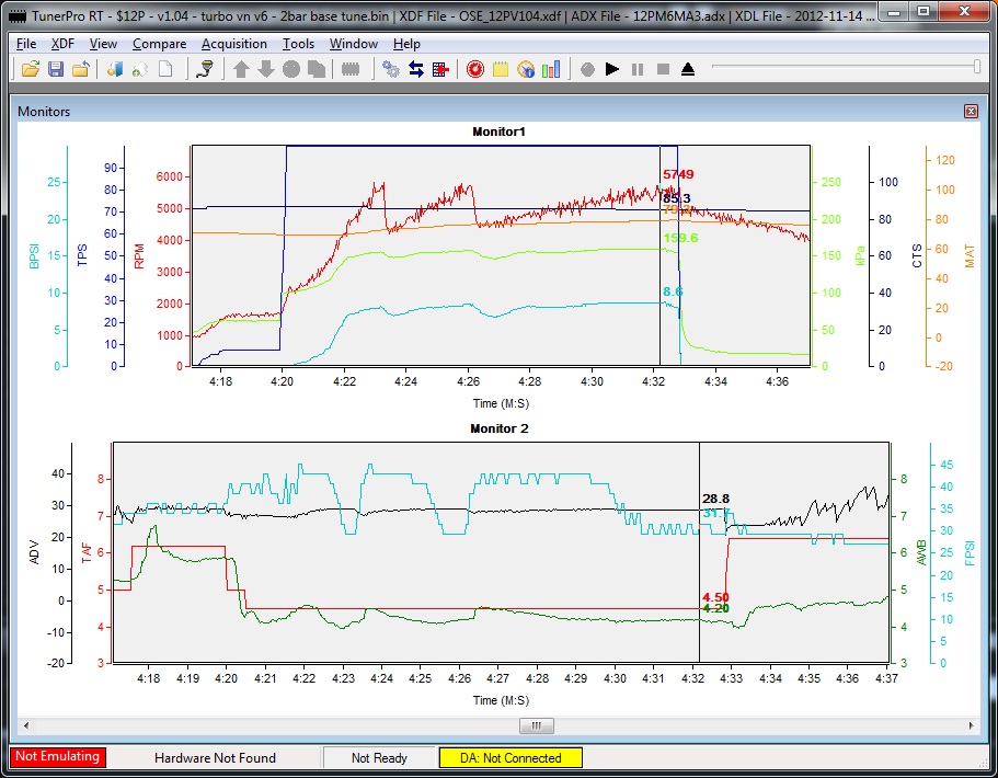

for anyone interested in methanol tuning, heres a log from my last 8psi run, i wish i could be showing you a 14psi run when the tranny broke but due to that i ended up turning the car off before i remembered to stop recording on the datalogger so its GOOONE!
oh yeah ......
BPSI = Boost PSI
KPA = Map Sensor
MAT = Manifold Inlet Temp
TPS = Throttle Position
CTS = Engine Coolant
ADV = Spark Advance
TAF = Target Air Fuel Ratio
AWB = Analog Wideband Input
FPSI = Fuel Rail PSI
