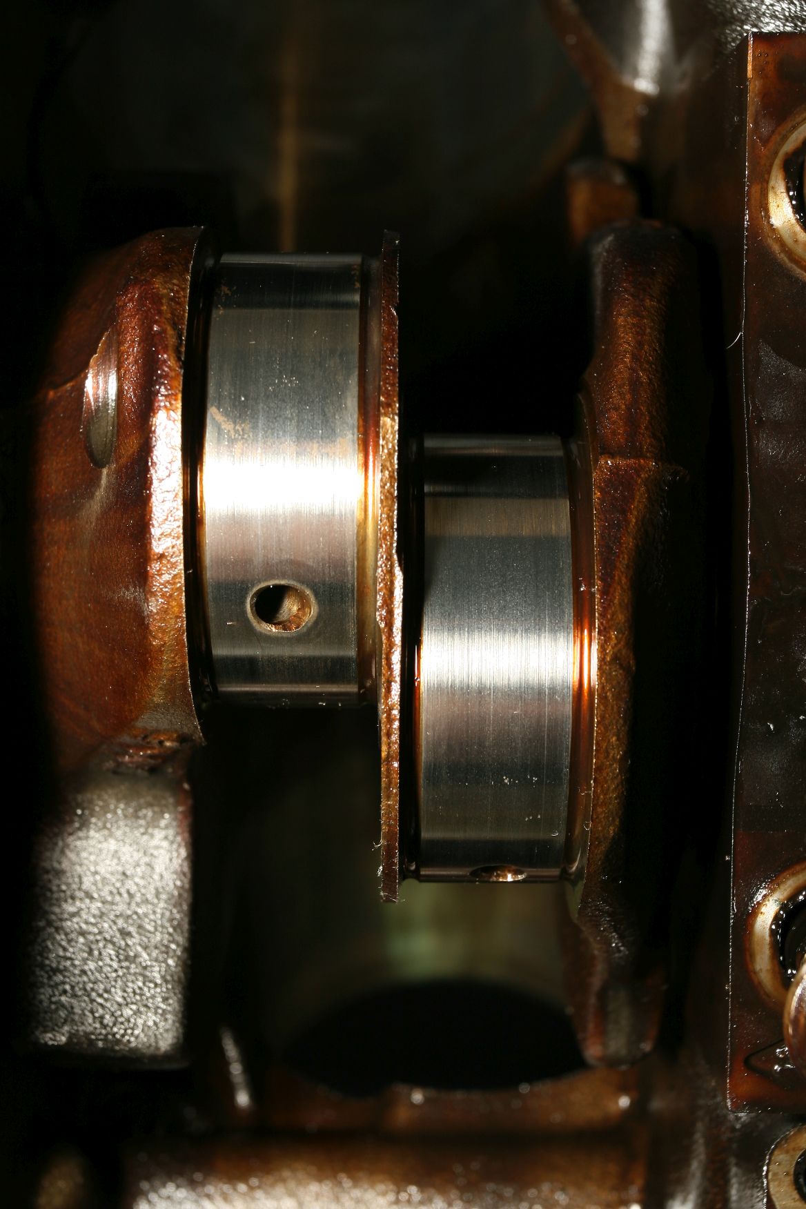

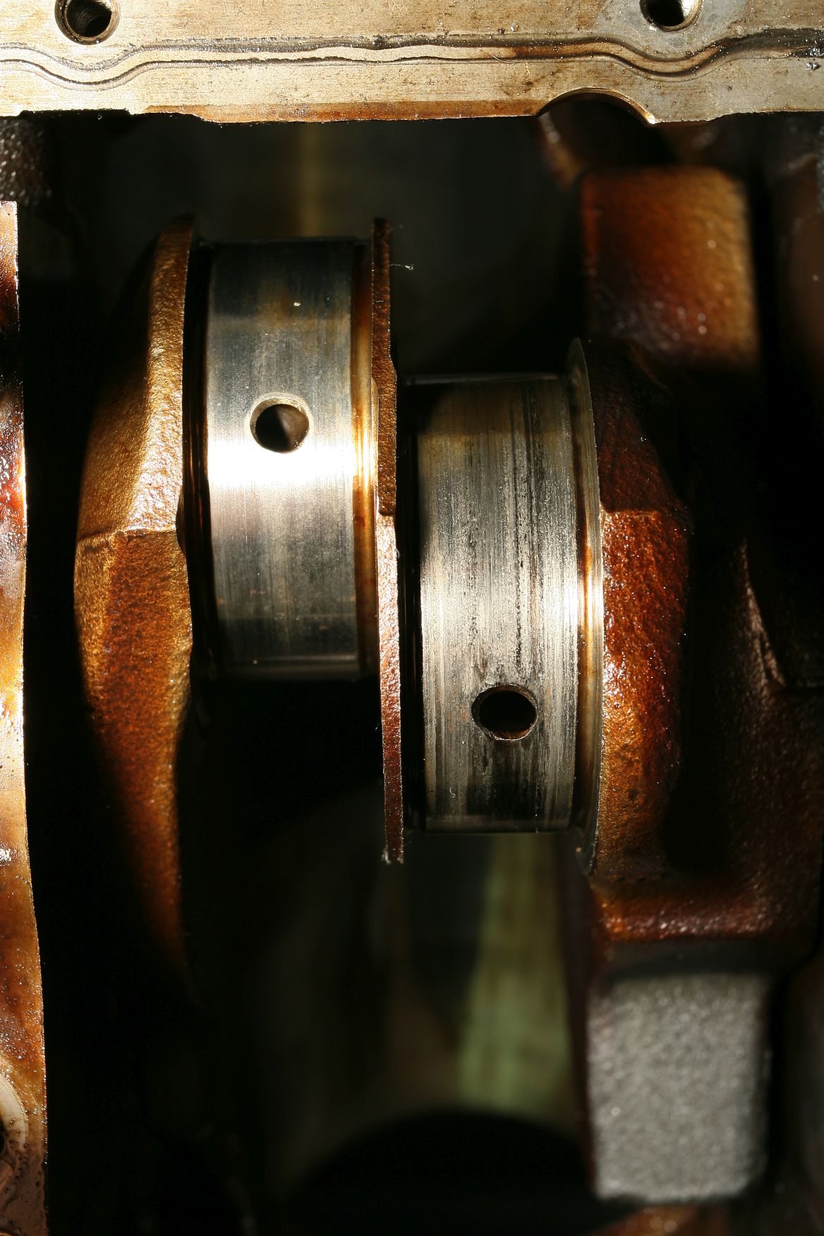

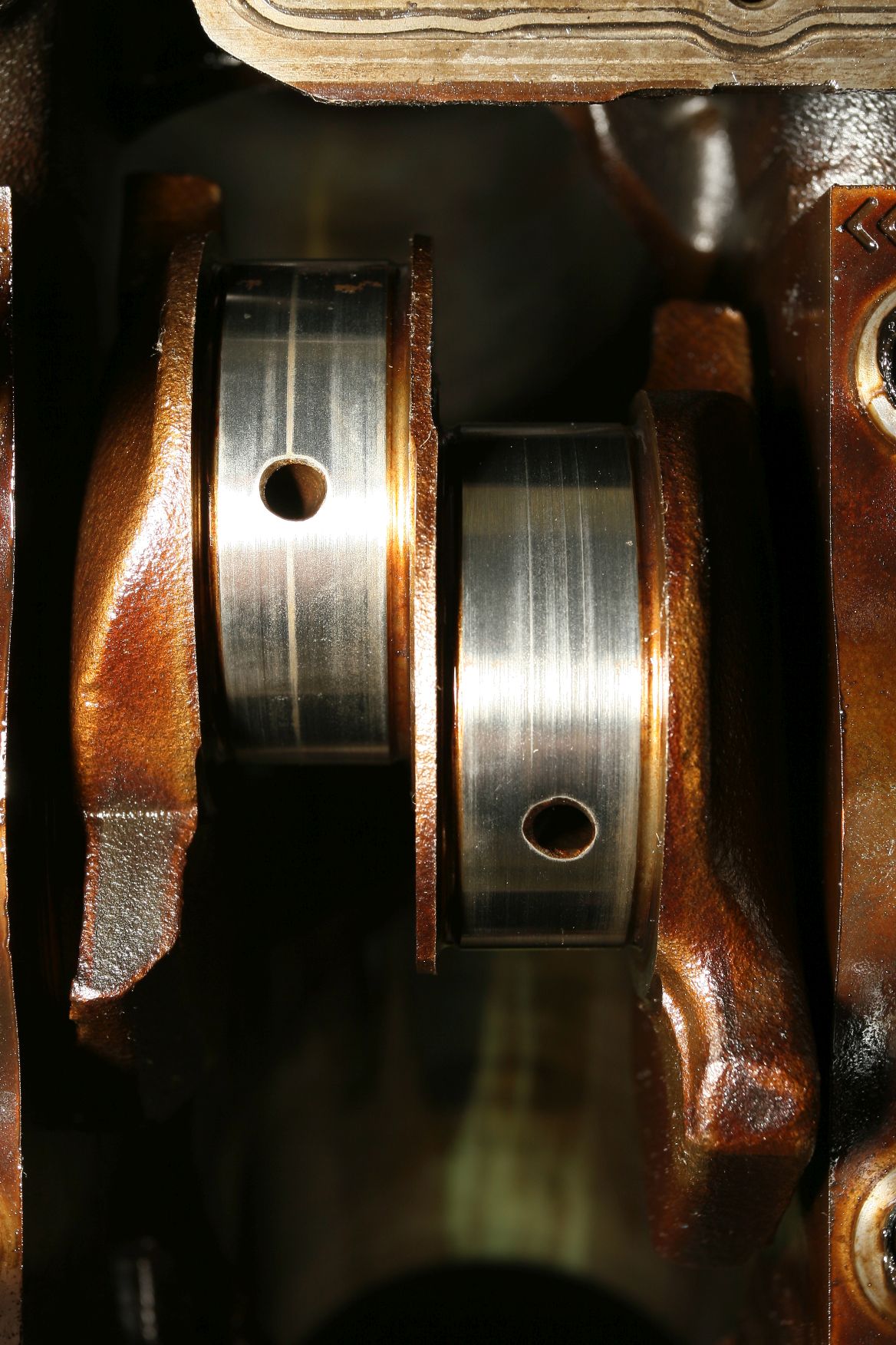

Here's the crank
#1&2 #3&4 #5&6
Here's the crank
#1&2 #3&4 #5&6

the journal damage gets progressively worse as you head towards the rear of the engine. Was definitely low on oil supply or pressure.
i wonder if they hit something and the oil leaked out killing the engine?

That crank journal looks a bit nasty!!! Plenty of Bearrng material there!!
