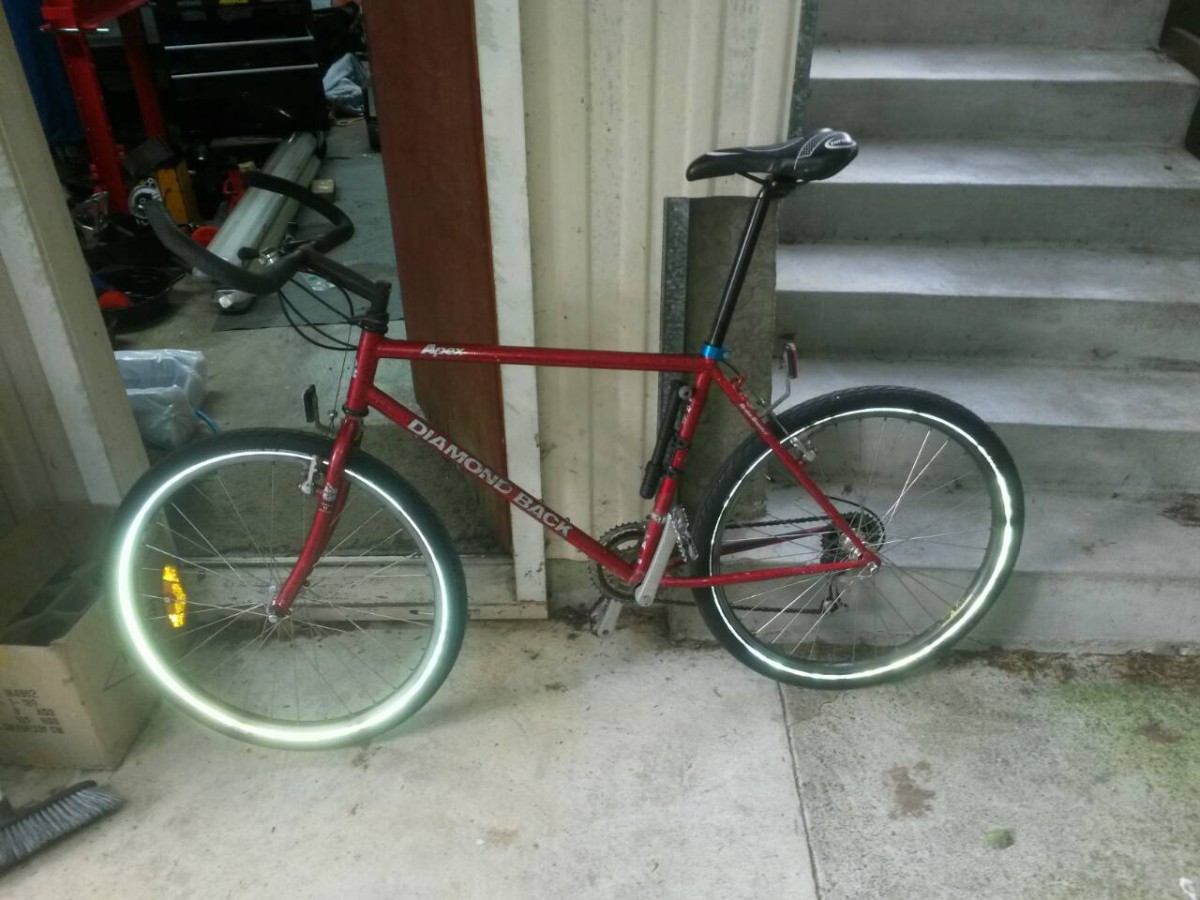

Started riding a bike again a few months ago as the old ticker needs a bit of work but because of trouble with the knees/ankles a low impact exercise was crucial so the bike was a perfect option (considering I have a few in the garage). Started out on the newer/cheaper bike which turned out to be a mistake as it wasn't quiet big enough for me and I ended up killing it when I crashed 2 months ago ending up with bent wheel axle and loose bearing, main crank bearing shot, broken pedal and seat and few other minor issues.

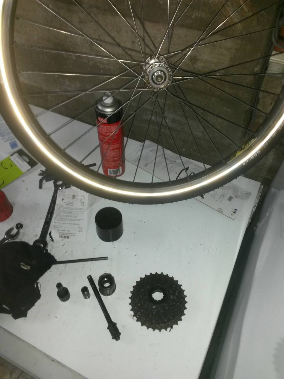

So today I pulled out my old bike, fitted new tubes and tyres, then decided the wheel bearing were a bit rough so started pulling it all apart to clean and re-grease. Unfortunately one bearing was dry and I wasn't paying attention and some of the ball bearings decided to part company, found all but one so I have new ones on order and should have em tomorrow.
All going well it'll all be done tomorrow for it's new maiden voyage.

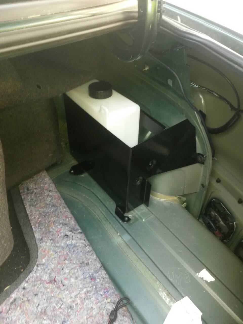

Thought I'd found a much better use of the old boot mounted CD changer bracket but unfortunately the top of the tank fouls on the boot lid arm when closing
I really prefer to semi-hide the tank or the missus will get pissed with something else taking up room in the boot. Not sure what I'll try next but cutting a hole in the boot floor is not an option unfortunately.
This bike has a slightly larger frame than the last one I trashed, it allows me to get full power through the legs unlike the last bike. Much better riding position.Thought I'd found a much better use of the old boot mounted CD changer bracket but unfortunately the top of the tank fouls on the boot lid arm when closing
