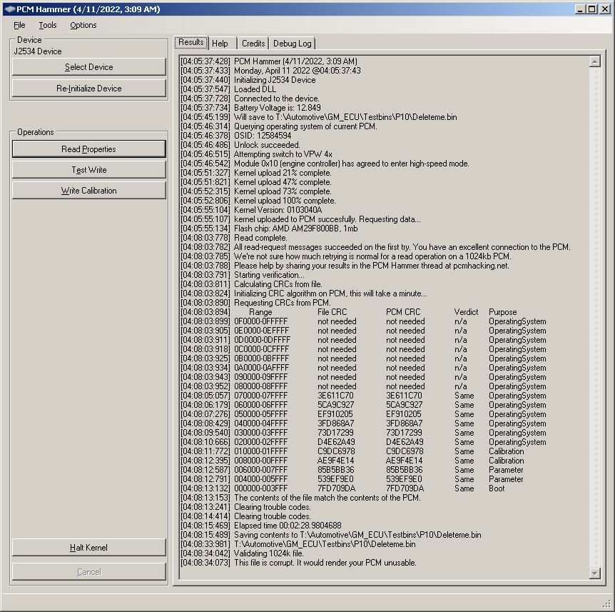

Is FFA000 - FFE000 the usable RAM range for both P10 and P12?
kur4o
Posts: 1044
Re: PCM Hammer P12 development
Post by kur4o »
NSFW wrote:Is FFA000 - FFE000 the usable RAM range for both P10 and P12?
p10 only
p12 usable ram is ffff0000-ffff7fff

Ive implemented RAMSize but linked to the above comment, as I dont have hardware to test if we can upload to the entire range on P10. Im also pretty sure since P12 doesnt have the execute bit uploading to FF2000 is magic for the code to be executed but I have not verified this. So ive provided what we need but it can be revisited in the future if the kernel keeps growing for some reason. https://github.com/LegacyNsfw/PcmHacks/ ... 3514ca2dcd
Posts: 9010

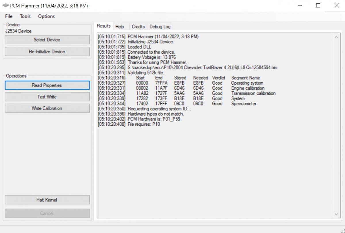

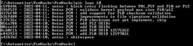

We now have P10 Checksum and file signature validation working.
And also protection against cross flashing in a file with good structure and signature, in to a PCM that cant run it.
P12 structure looks more like an E38 so that will be more work to bring the P12 code up to the same level. But I have an E38 sum tool viewtopic.php?f=26&t=3833 so might be able to reuse some of the code after some more P12 analysis.
