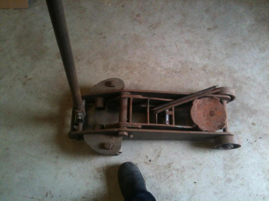

Got this from my half brother, a monster jack he took apart 25+ years ago or so and never got the ram reco, leaking seal or something he reckons.
He is going to take the ram to a specialist in Ballarat. if its all good, that is my next restro project. I am currently borrowing his good jack from 1970s. I refuse to buy a new jack as they are all POS china crap and dangerous to use due to failing too quick, as china made stuff does.

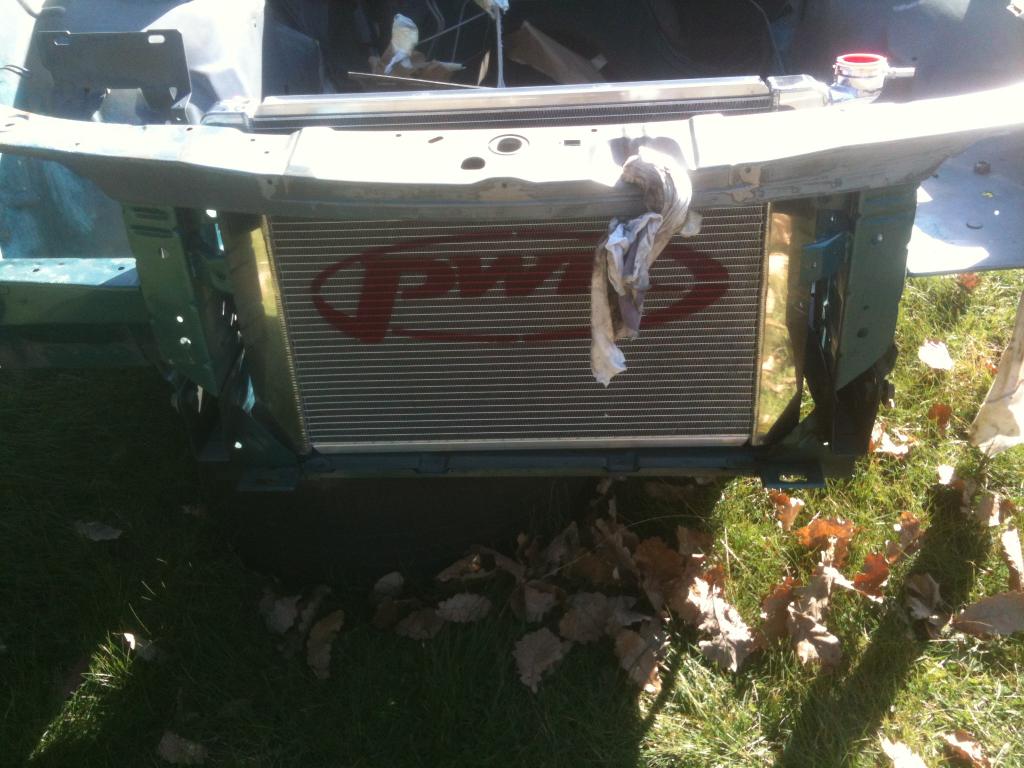

Radiator design been signed off, Finally! Lots of changes to make OEM like drop in radiator with no mods whatsoever required.
Bit of an oddball design but will fit like factory.

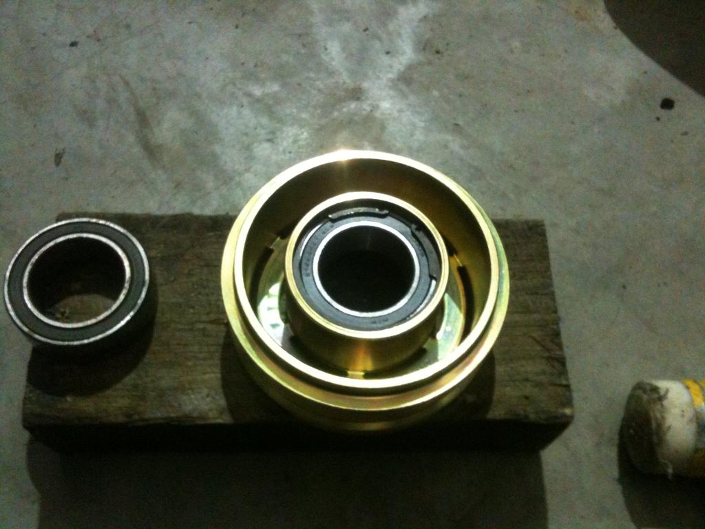

Picked up the AC pulley and couple other stuff I chucked in to make plating worth while.
Bearing!
then this happen, see the fine wear mark above the circlip groove? yeah its fouling. Turns out out of all the pulleys I had, this one was the best for plating but happen to be the only one slightly different to the rest and doesn't fit. What I worked out is that lip is twice as thick as the other ones because this must of come from a really early AC compressor which is electromagnet is fixed the comp differently to the other comps I have laying around including the one on the VR.
So going to try getting it machined down tomorrow while I'm in town.
Bearing!

Why is the design not recommended by PWR?vlad01 wrote:Radiator design been signed off, Finally! Lots of changes to make OEM like drop in radiator with no mods whatsoever required.
- Posts: 8601
because its nothing like their off the shelf design nor can they guarantee the fit as I'm making all the calls for the design. I know it will fit though
I can't understand why they wouldn't want to make one that drops straight in to replace a factory one ?!?!! as I see it, its in their best interests to do so, because it will surely mean more business ?!?!
- Posts: 1217
- cars: HQ Holden
They probably will now thanks to Mr Vlad supplying them with the drawings and so on !
- Posts: 8601
lol, yeah that was my thoughts too, but they reckon theirs do. I call impossible because one needed fan mods to mount the fan, another was too thick and forward facing that is would foul the radiator support up top.
They said their design for for no compromise performance. I needed no compromise fit more than anything.
anyway its done and should be here not too long.
well AC pulley machined and fits perfect now and no more SC like whine lol. Drove the car around the yard and driveway. I have a 300 odd m long driveway.

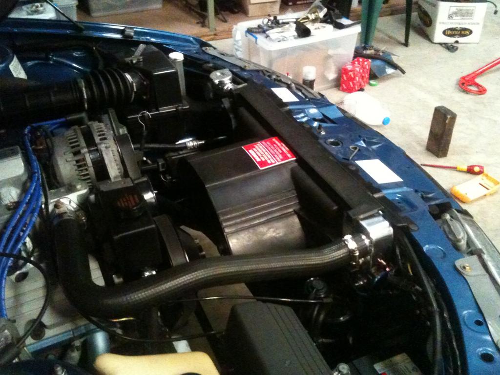

Update time!
sorry I got excited with too many pics

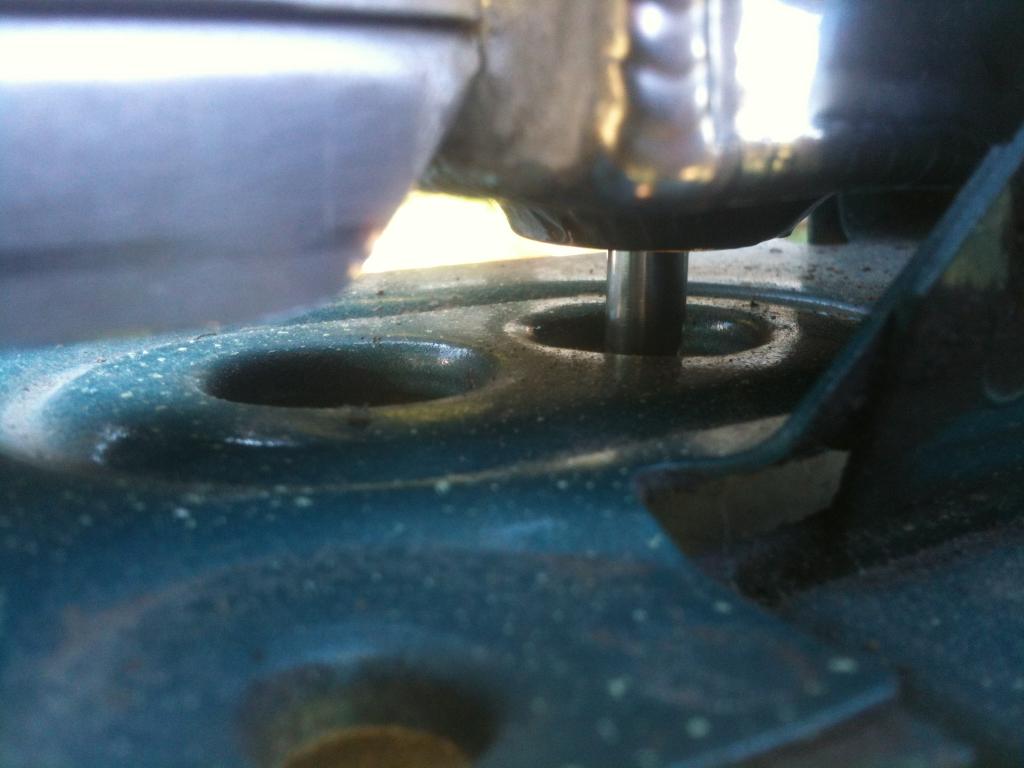

my design fitted like factory. Only thing I had to do is slice off 4mm off each rubber side mount to accommodate the bases of the mounting pegs, I already knew that might of happen as this was a manufacturing limitation discussed during the design phase. Once I trimmed though, dropped in like factory.

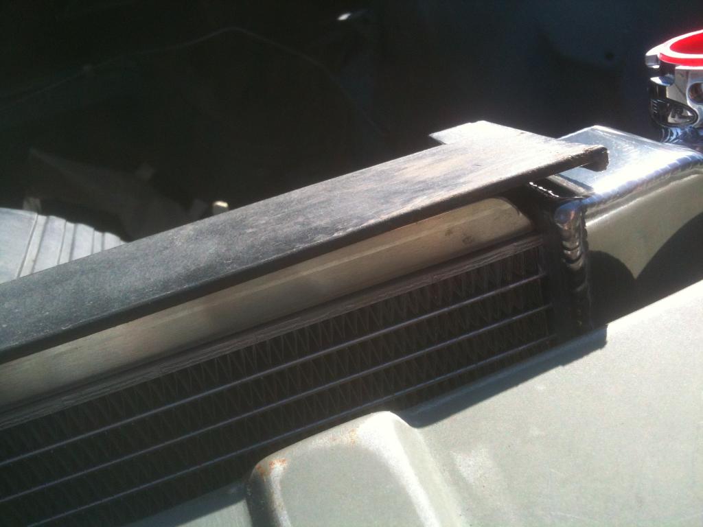

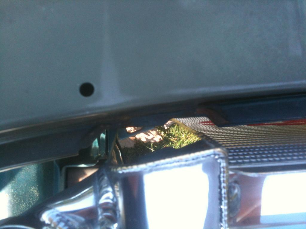

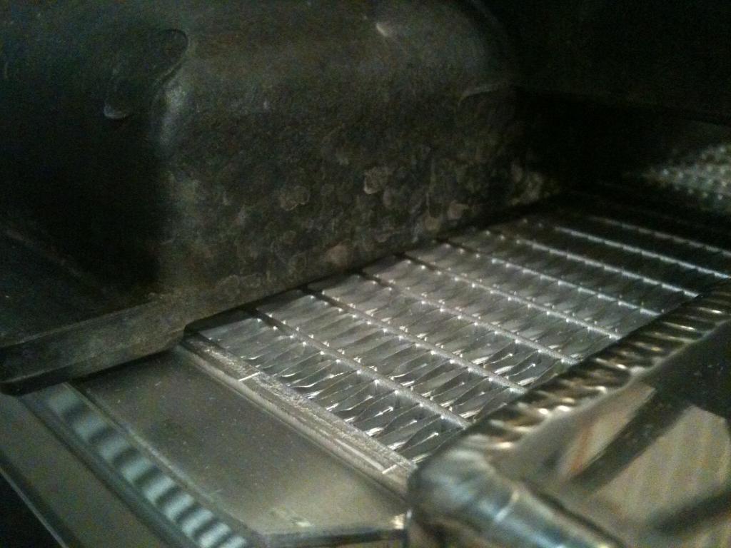

Tapered end tank fits those areas int he next 2 pic beautifully! Got my measurements right!

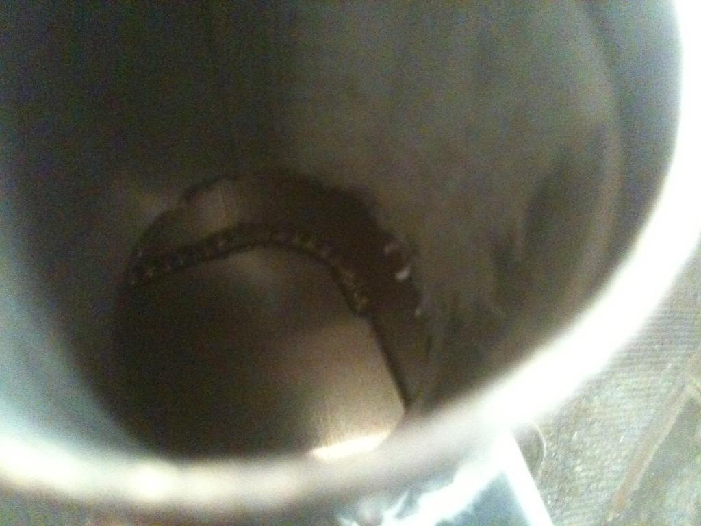

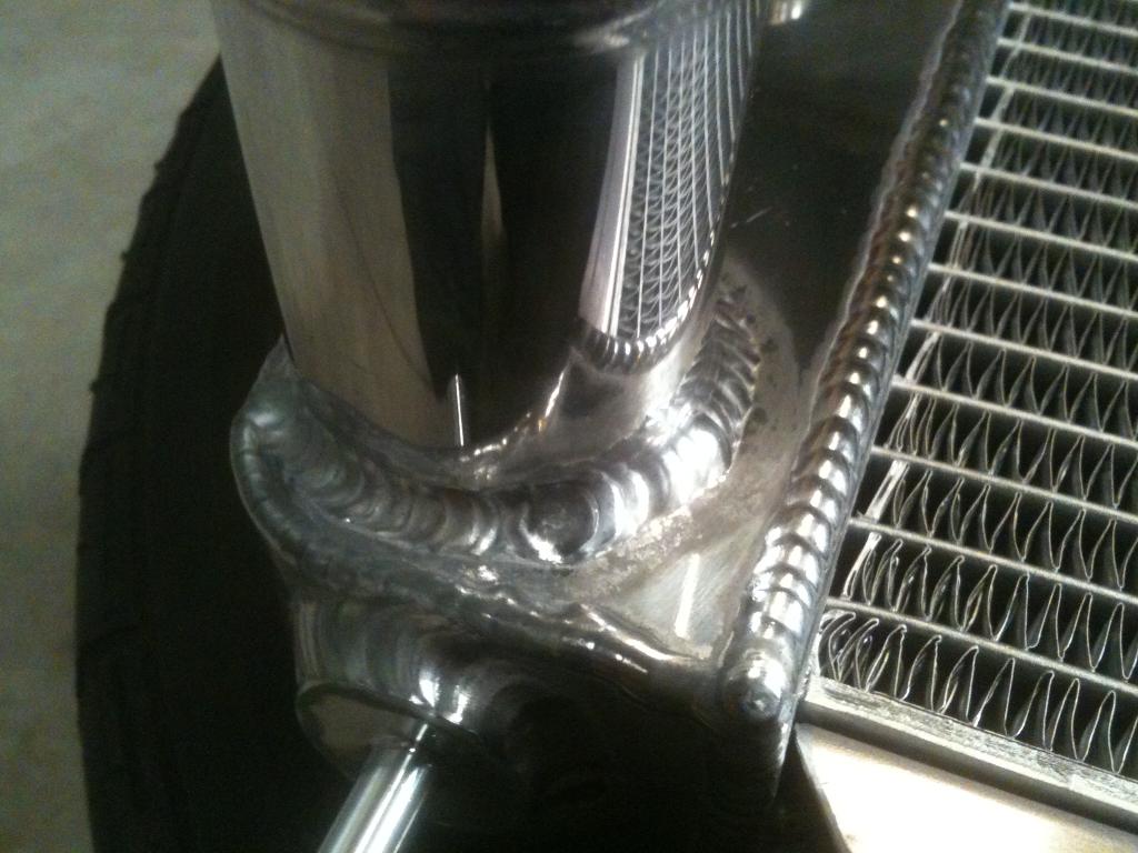

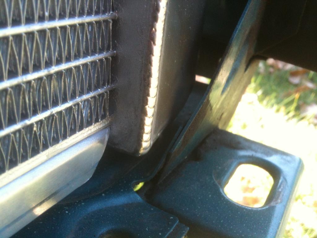

Quality welds.
Excellent weld penetration.
Look at that OEM fit!!

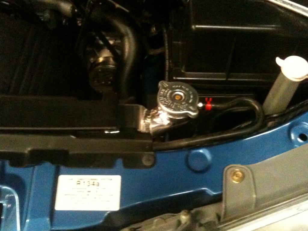

Bonnet clears perfect thanks to my crazy angled filler idea, look kinda neat.
