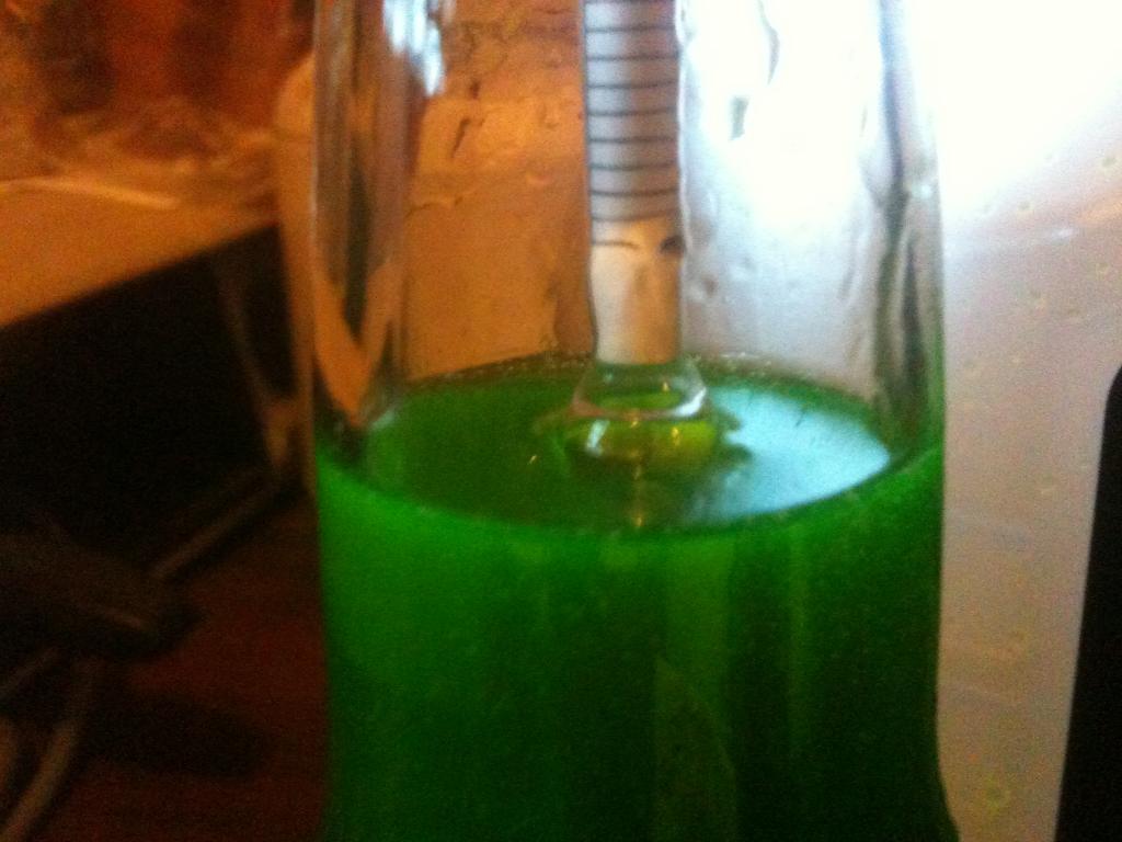

one last thing i need to do is work out coolant concentrations using this. Hydrometer. This one is at 60% @ 23ºC, if it floats at the ring just above the float line in the pic, its 50% I just need to be above 55%, aiming for 60%

Yesterday I got the coolant concentration right, needed to remove about 1L and refill the 1L with 100% concentrate to get my 55-60% target.

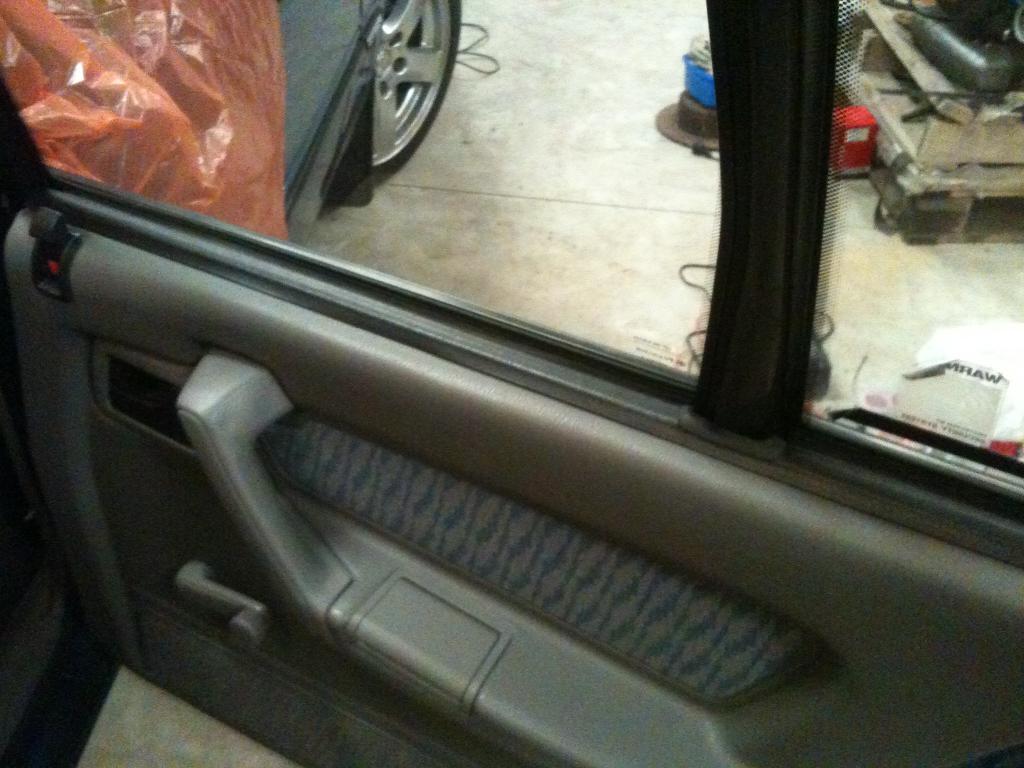

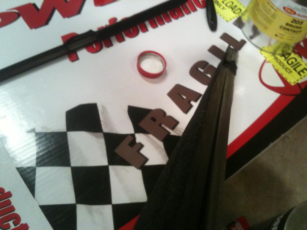

Fixed the last thing today, those felt strips on the inner door belts are renown for dropping off into the inside of the door. I fished them out using a wire hook I made to insert into the end of the rubber itself through the access holes at the bottom of the door, twist to latch and pull them out.
All were there but one, I raided the missing one from the berlina in the paddock.
So I fixed them up and refitted them. what a PITA! took all day and bit of yesterday and end of my fingers are bruised. They were so so hard to remove from the doors. I thought I was going to rip the doors off. Broke my prying hook tools lol china crap kincrome, but still fair bit of force.
But finally a commodore with compete inner belts lol.
