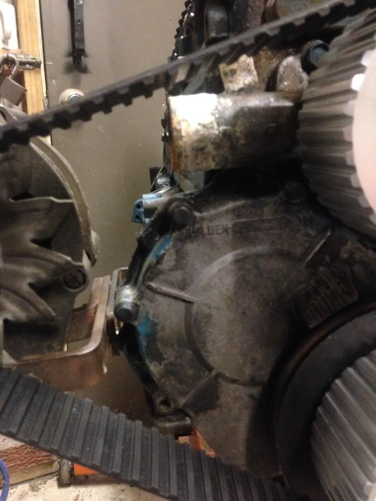

Don't think I can mount the sensor that low, gilmer belt is in the way.

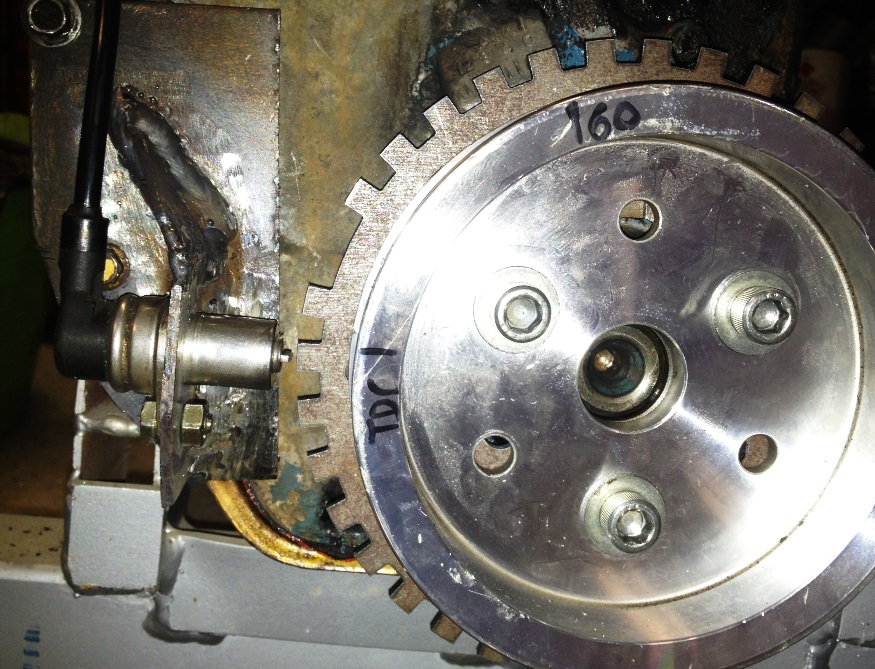

I thought that as long as the crank was tdc at number 1 when I make the first mark on the wheel I wouldn't have a problem where i located the sensor?
Re: Trigger points for CAS.
Thats ok, it can be anywhere around the crank. BUT you must get the middle of trigger wheel teeth/slots lining up with the sensor at the correct engine rotational angle as per the factory info for the ign module your using. So you will need to be able to spin the trigger disc around until that is correct.
For most reluctor sensors also want the tip of the sensor about 60 thou or so from the trigger wheel - you may need to experiment with this a little bit depending on the module.

oh that's different, can't say I've ever seen the alternator on that side of the motor before :P
