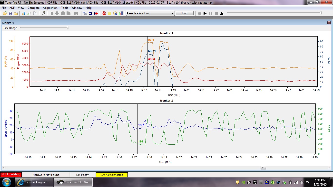

so I have my 304 running on $11P with full VS wiring loom (in Bedford) and I've recently got to have it running....
I can confirm that the VS 2 speed fans works great!! and I can also confirm that the spark cut limiter works well as per the below video

Sounds much better now with some spark advance, and spark cut test seemed to work
Seem to recall you are using the 2 speed fan via the V6 BCM out of the donor car, rather than directly driving the 2 fans from the PCM outputs? Not many have configured that 11P feature so good to know its working.
Re: OSE 11P V104
yeah using the message scheduling to send VS BCM fan and VS VATS to the BCM.
also heres the log of the spark cut, 3000rpm.

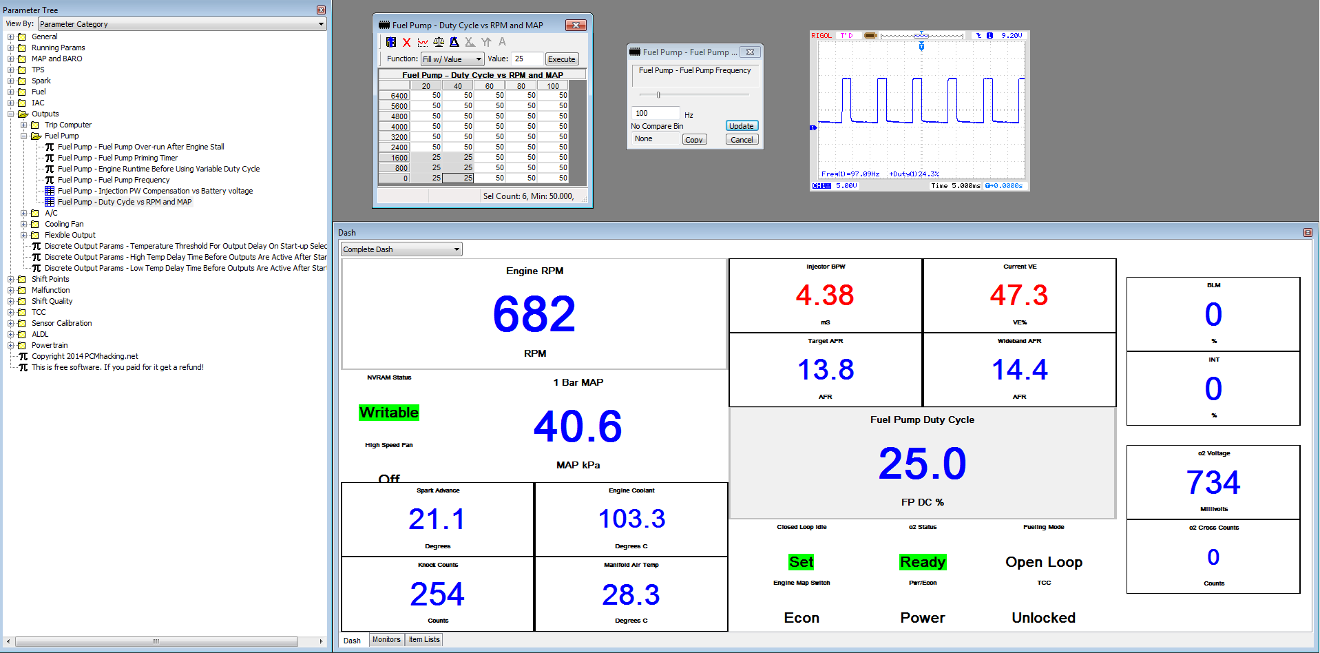

Should quieten down those noisy pumps...

You didn't muck around only few day's ago you mentioned it in another thread.
Would it at all be possible to fun a 5 speed auto from 424?
Maybe this fuel pump output be re assigned for auto shift?
