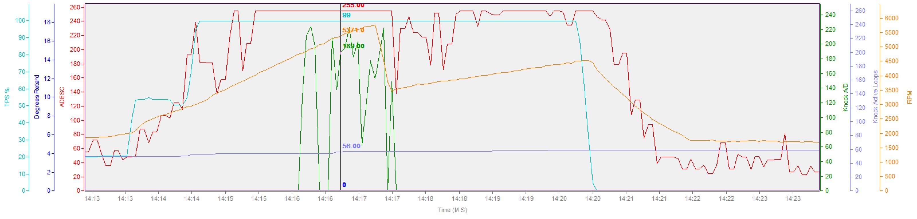

had a play with festy's knock box finally, here's a WOT screenshot, Red is the A/D of the factory system, you can see it's not much good at WOT, just to much gain so background noise issues and ignore time mostly canceling it out, but looking at Knock Active loops it still working well enough so will have to retune the factory system a bit, you can see knock active loops and factory A/D picking up knock at the start but festy's box isn't but it's tuned out so no retard. Makes for some interesting tuning.

With what little time ive spent on this i did start looking at adding in some form of knock per cylinder system, ecotecs have a injector counter which is used for sequential from the cam signal and 3x so was going to look at using that to output retard per cylinder to the datastream, one idea anyway, just need some time to look at it further.

Makes sense so any noise other than during the expected knock window is completely ignored.
