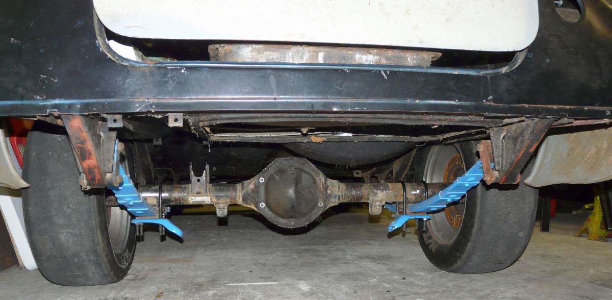

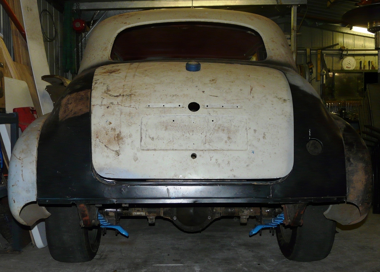

in other news I shortened a commodore diff today, its not quite done, but its roughly dummied up to see where everything sits!

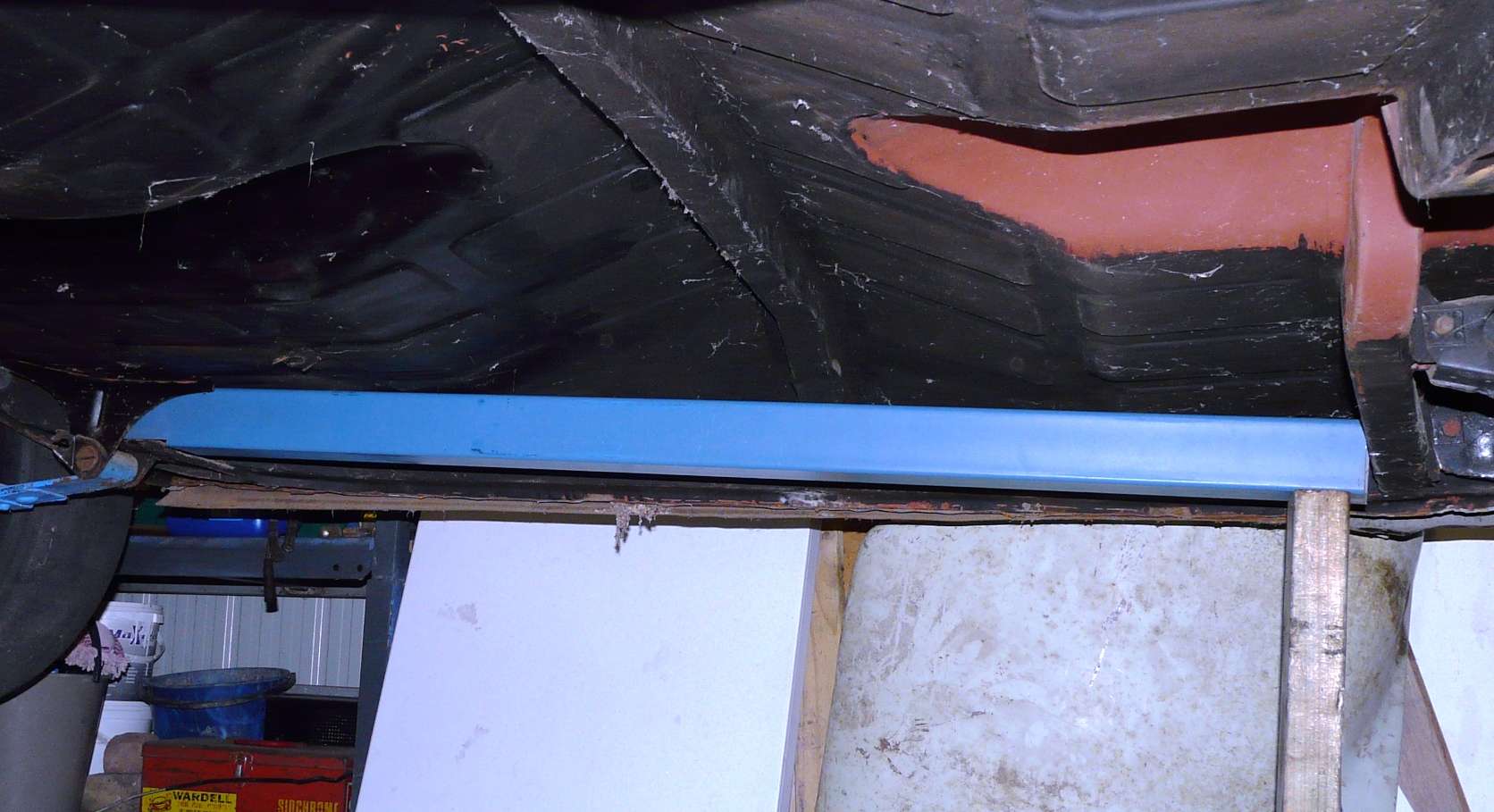

didn't get a lot of time, but started sussing out some chassis strengthening rails
they slot into the spring mounts, and they will be welded together once finished and will be stitched along the floor and to the front cross brace.

Those original front spring mounts look a bit frail so those rails should stiffen it up a bit. Looks like your going to stick with leaf springs?
yeah they are decieving, when i first looked at them i thought weak too, but there is a few layers of metal, also there is a plate from the side of the sill to them which is what that rail is actually resting on, and it all ties in, but yeah will certainly strengthening it im hoping.
and yeah plan to start out with the leaf springs and see how it goes!
