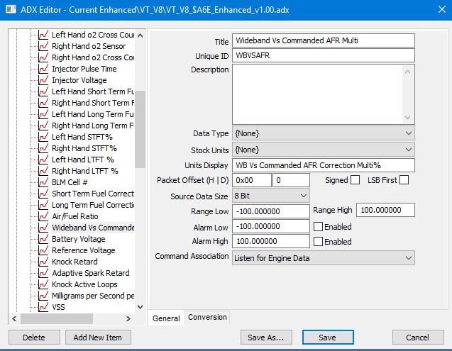

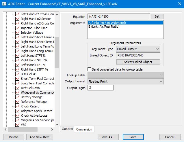

JA2Z wrote:The1, am I able to do variable based math in the 'calculation' section of the item ADX? as in calculation with variables other than the item itself? or just basic math for that item variable?
You can do what you like in the adx calc
You setup a Value item for example in the ADX as normal, but packet offset doesn't matter for value just leave it at 0
for Calc just remove the X which is the reference the packet in the general tab, but create your own calc, you can also link to other values in the adx, like mine below in enhanced mod which just compairs target afr with wideband input.
I think i remember there was an ADX around that would use a map sensor on an input pin and maf sensor and generate data in history tables, like VE tables, even though the car is running a MAF sensor. If i find it ill post it.
Yeh Map has it over MAF when the intake air path is to long as obviously the MAF is to far away compaired to a MAP sensor in the plenum.

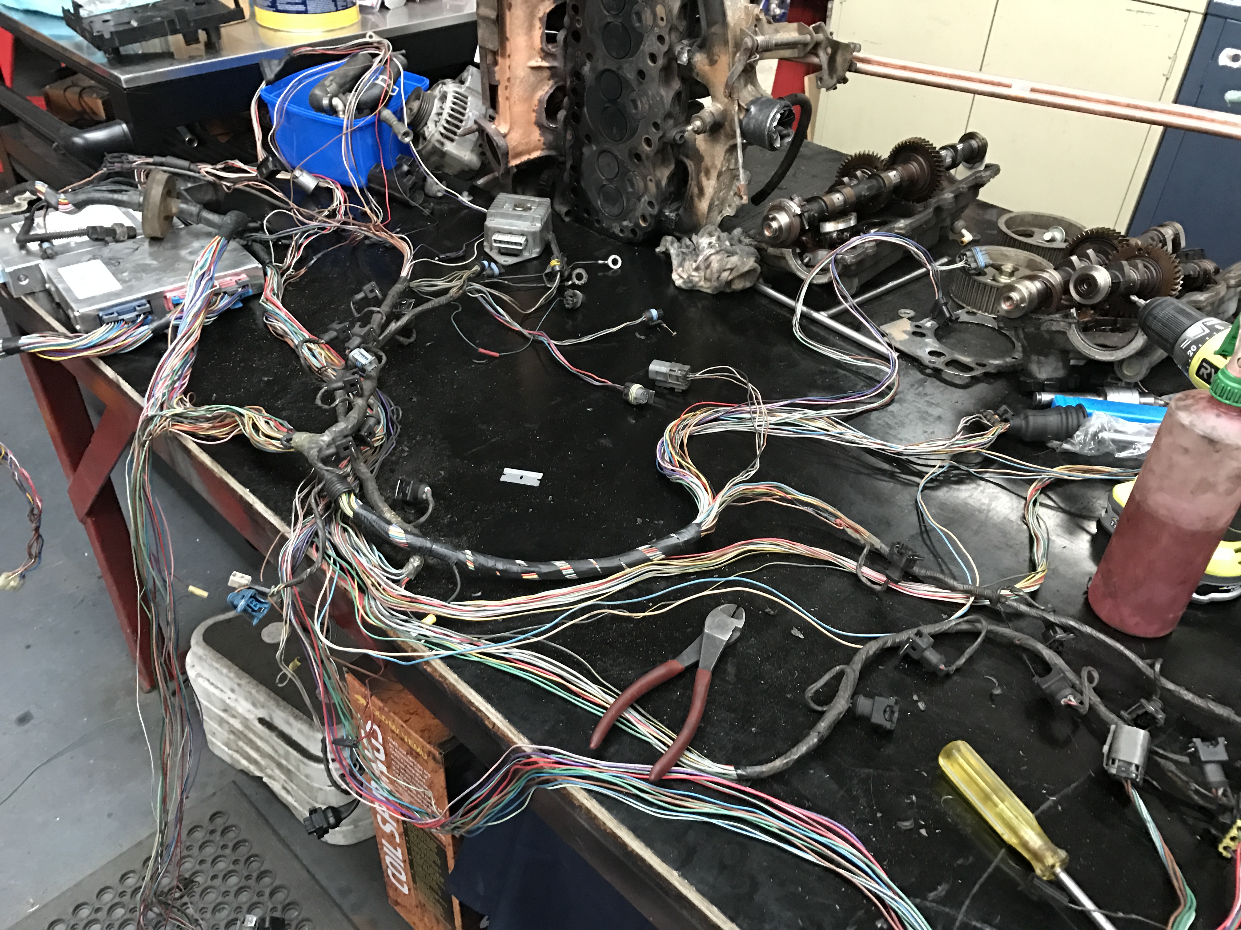

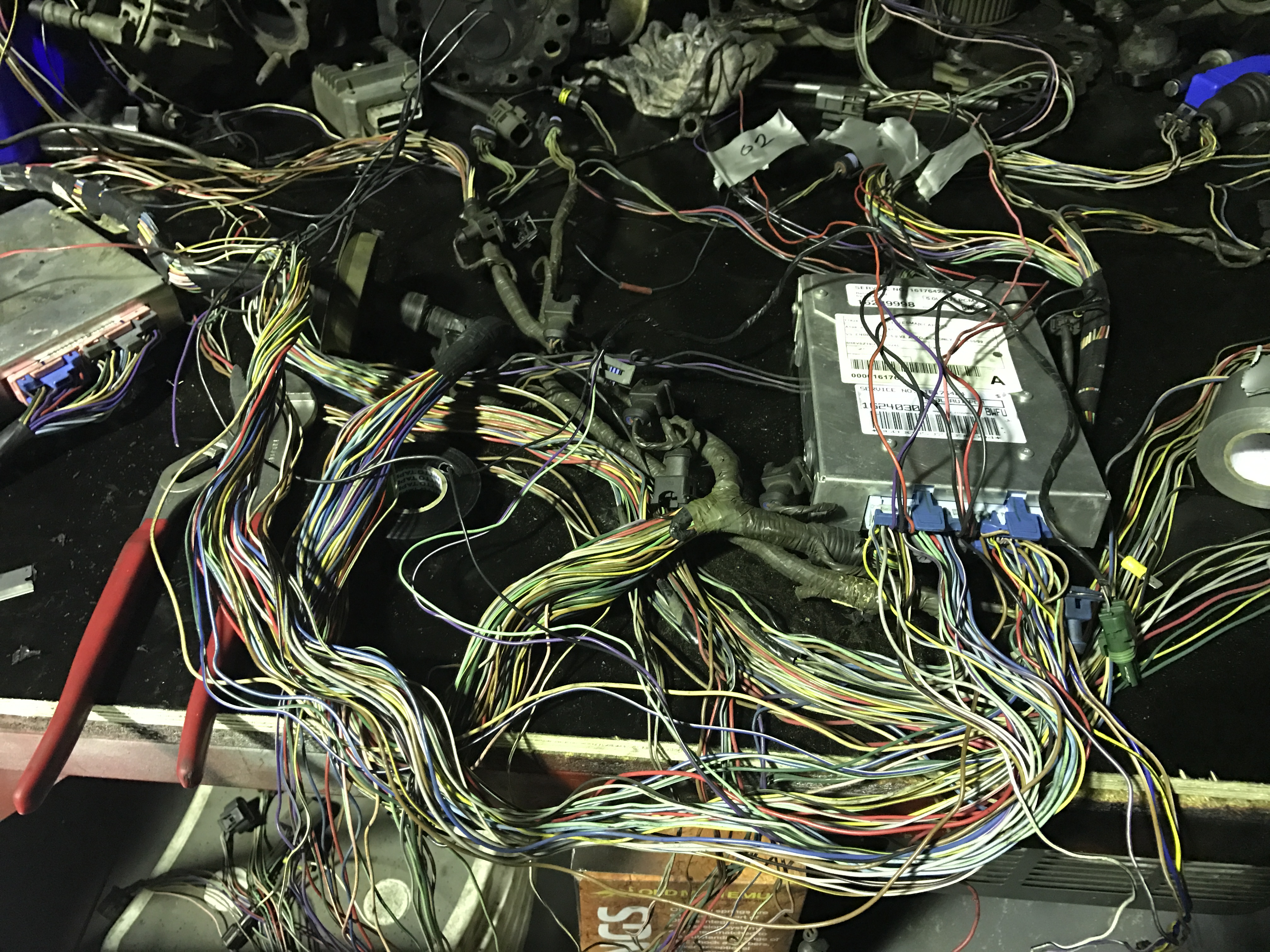

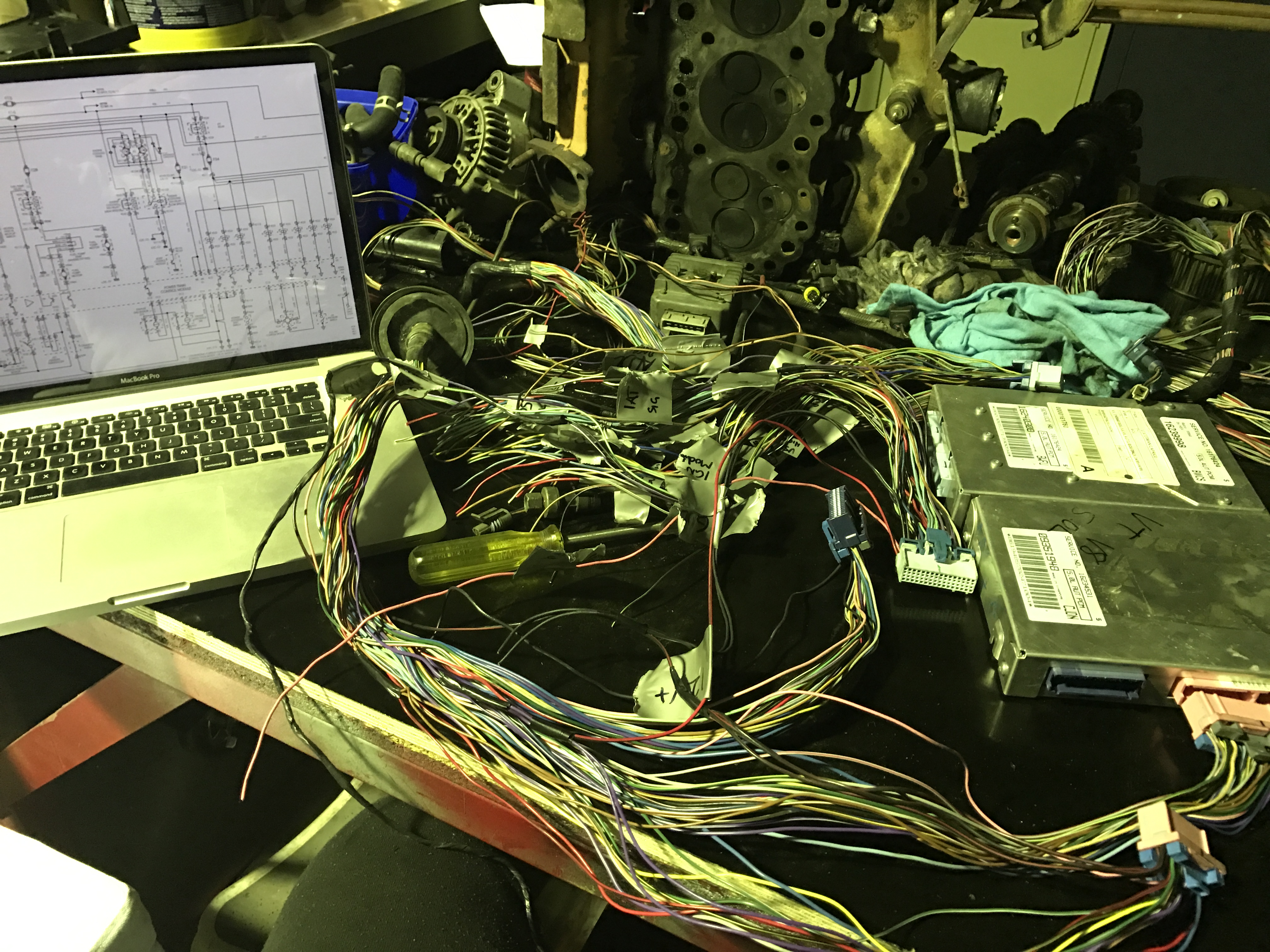

I've been wiring the PCM & ECU today:

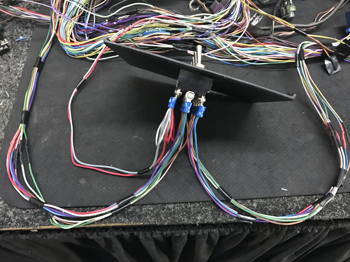

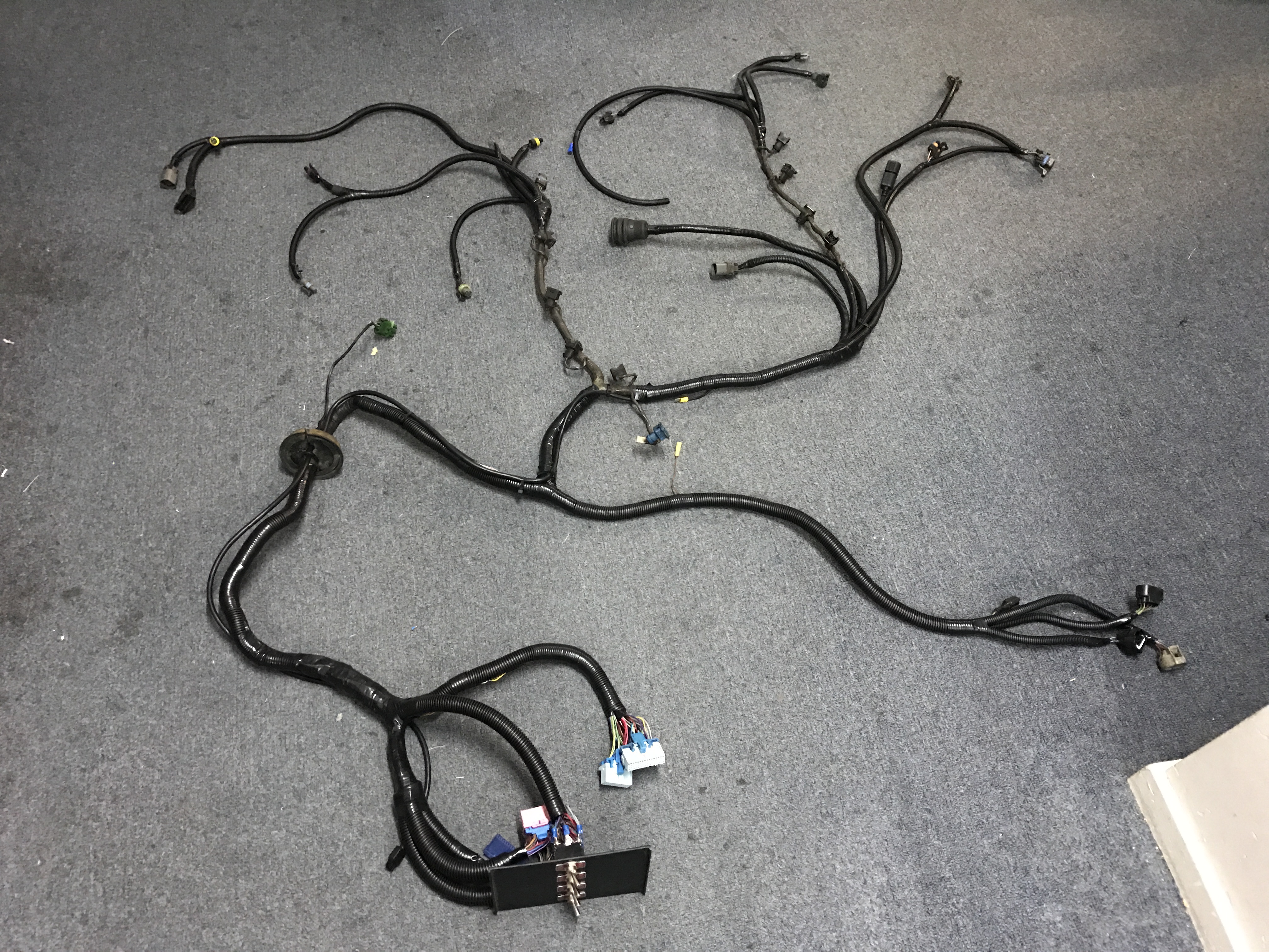

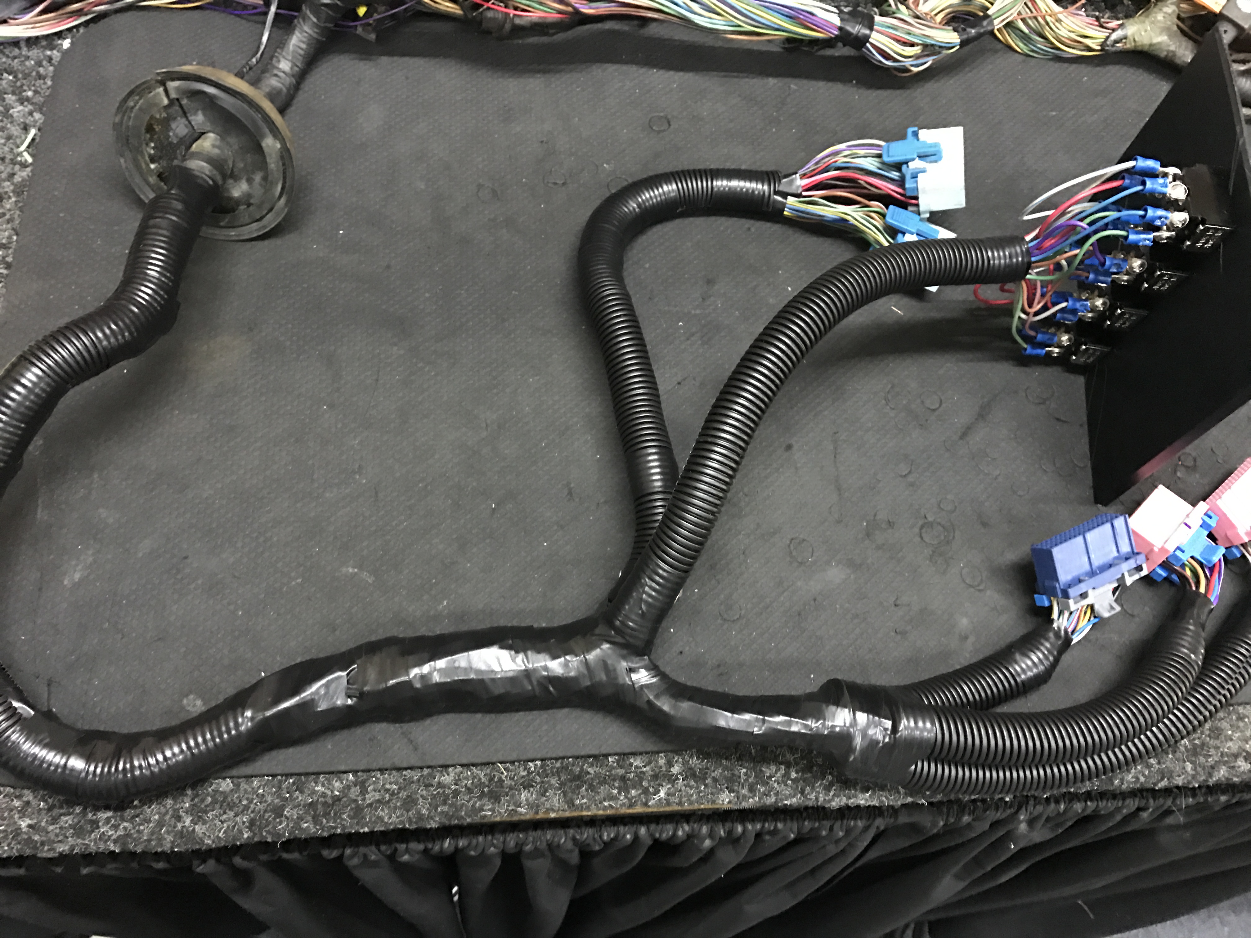

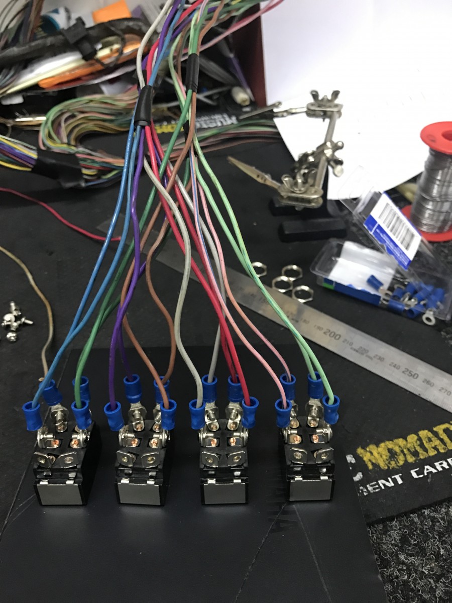

Looms virtually done.

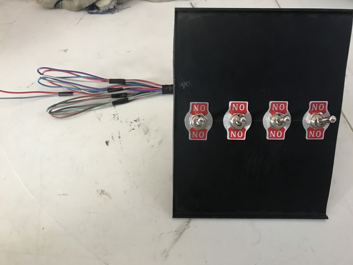

At this stage I have gone with a custom wiring switch bank, as it was cheaper than relays, and will look cool.
Maybe later I will change the DPDT switches for relays. For now, at least it looks goods.
The Switches fully Break/Make - Make/Break the whole injector set.. so there is no way I can bridge the VT injector GNDs and cause 4x fueling to occur - either the fueling will work perfectly, or not at all. (no confusing half/way options)
Mmmm, soldered and loomed.
Pretty - #CablePorn
Loom Done! Complete with Wideband Loom
