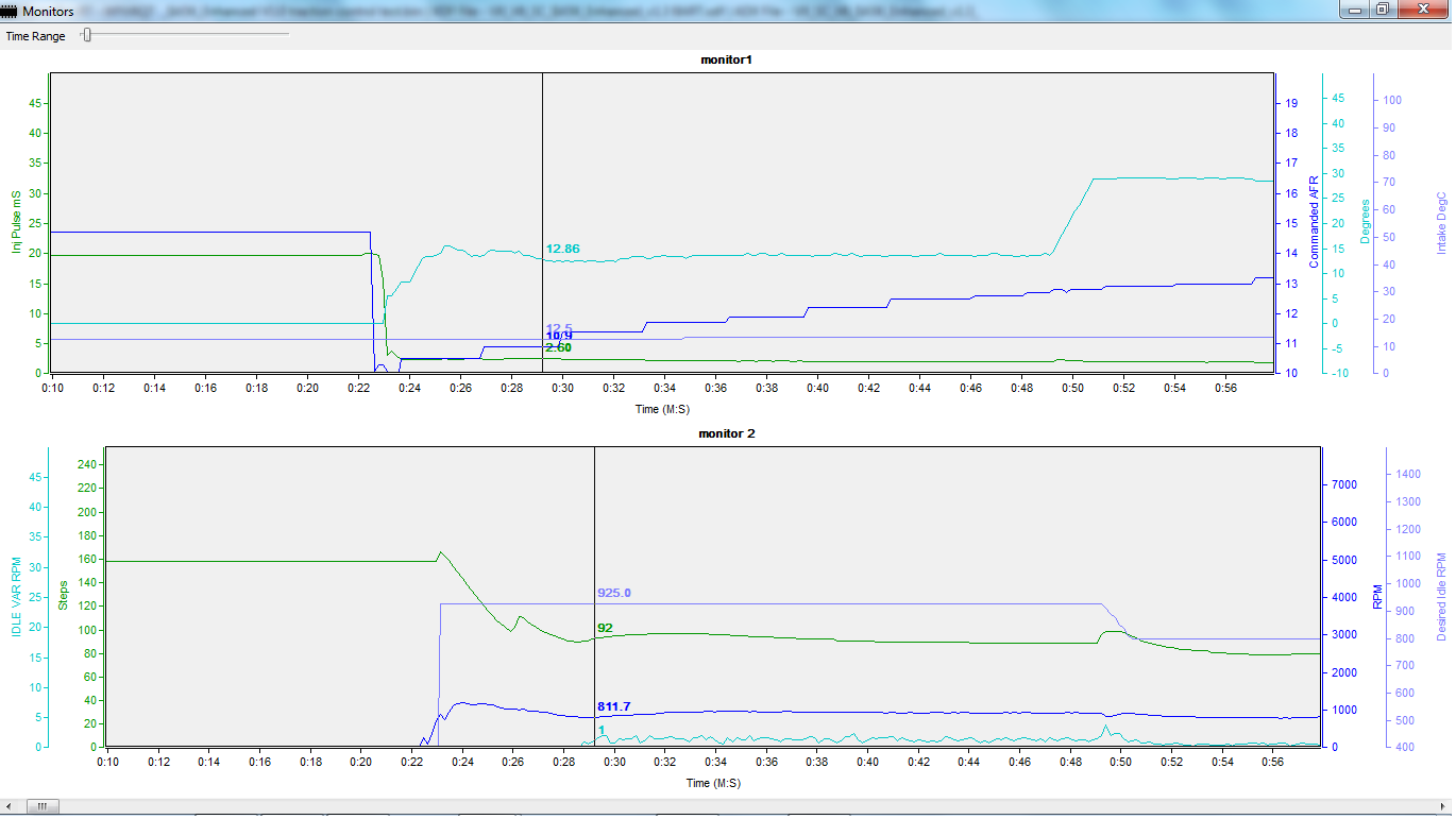

A Cold start should look something like this
The dark blue trace in the top window is the AFR, you can see it stepping up with time. It will continue to do this until it either reaches the open loop AFR target or the engine goes into closed loop mode. It does indeed start off very rich, this is normal.
